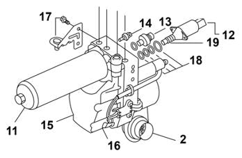

                        You meant bolt #16?
                        I am curious of why the torque on the bolts affects the holding pressure; lower torque causes more internal leak?
                          You meant bolt #16?
                          i believe this is the idea the tech support explained to me.
                          those 2 small pieces holding the butterfly o-ring and the copper plate together, and copper plate has oil venting directions .. so i think if didn't torque to spec (tight enough), it might cause pressure lost ..as those little gear keep driven by motor to build pressure, and somehow keep losing pressure?
