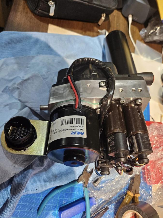

    took forever to start this rebuilt, but didn't end up well as expected.
    background:
    car drops out gear fast, after a while, pop back to the gear where it left. not holding up pressure was my guess.
    so what i did:
    - took out smg pump, took it apart
    - fit MLR orings for 4 sensors(x 12), gear's butterfly like o-rings x 2, and 2 or so small o-rings from the package
    - fit MLR refurbished accumulator
    - fit MLR new motor
    - fit new smg plastic feedline from reservoir to pump
    after put back:
    - found leak at where the reservoir line to the pump, red collar area
    - too tired to take everything apart, so i fiddled it with new o-ring + ziptie it done, seems to be not leaking. however, the line didn't sit all the way in (hence i ziptie it down first)
    bleeding:
    - tried to bleed it with ISTA, got stuck to step 3 i guess...weird noise
    - error: 57 pump on time, and P1717
    it primes long to stop.
    what are my options now? if i take it apart again, where should i check? sigh
    i activate one of the menu under ISTA to see the accumulator pressure, it shows 0.

    Sometimes the reservoir to pump gets air-locked and doesnt allow hydraulic fluid into the oil pan. So you sort of need to put the reservoir pipe in and out of the pump to ensure fluid is flowing. This could cause a 0 pressure condition.

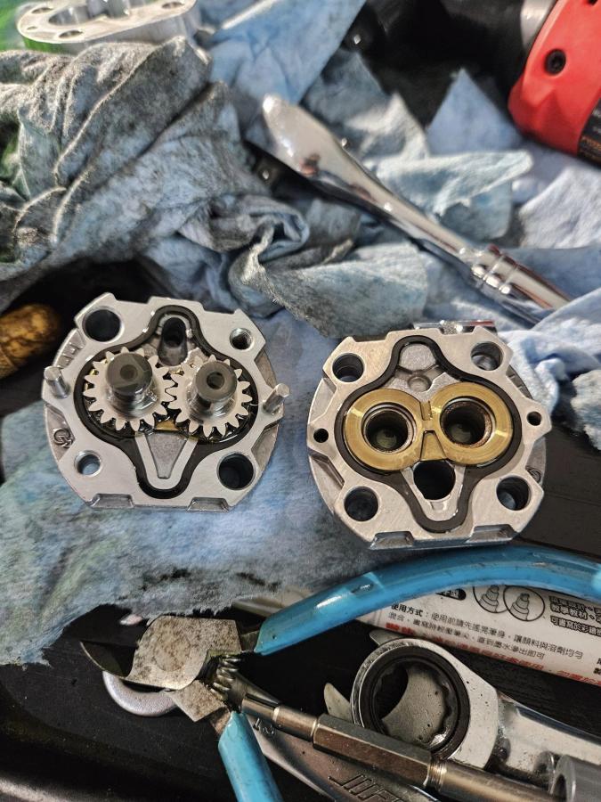

      so guess in the end i need to take apart the pump and evaluate my work again.
      they gave me inputs on the
      - orientation of the inner pump copper plate directions (there are big and small port difference)
      - i'll change out pressure sensor and temp sensor just to rule out these
      - plastic cable from reservoir to the pump, i need to take it apart and fiddle with the oring and fitment in that region.
      - coupler between motor and inner pump, needs to make sure they sits well, and i will need to probably add more grease there to lubricate it.

            Hi There - If you did not rebuild the pump correctly, you could have damaged the internal diamond shaped oring (for the lack of a better word) - and the pump is constantly on struggling to maintain pressure. another thing to consider is the torque in nm needed when rebuilding the pump, it needs to be spot-on.
            To turly troubleshoot this, you need inpa to check the live pressure value of the accumulator and the oil pump - This would help determine were the fault might be.
            hope this helps.
              What torque do you use? When I rebuilt mine I went with 5nm. I've never seen definitive documentation on the value and so many don't seem to want to say what torque value they used.
                  I used 7nm, it is listed on the MLR website, its called gear pump, which spins the gears to generate pressure. Here is the info from MLR, first NM then in-lb:
                  16 Gear pump bolt 6-7 - 55-65

                          Yes, you are getting the picture, it is a very simple system once you understand it. High oil temp will change the viscosity which translates to pump priming more often.
                            thank you so much!
                            at least i am feeling more confident in the sense of understanding the whole picture of how this system is like..
                            so it's definitely fixable without purchasing a new or refurbished pump from one of the vendors XD (fingers crossed)
                            and you are spot on the assemble process of the inner pump!!
                            i jointed them from 2 equal pieces together! and the torque thing may be an issue as well, i tried to tight them by feel, maybe what i felt is tight isn't tight enough ~
                            those copper plates, and inlet, outlet holes could be confusing as well..
                            From MLR's help, the following oil path was the result of recommendation they emphasized.
                            Hope this can help someone's future work.
                            I think i got mine right, but, i am starting to 2nd guess my work now due to the P1717 error still.
                            Click image for larger version  Name:	inner gear in out reference.png Views:	0 Size:	1.08 MB ID:	268889
                            p.s
                            do you re-oil those inner pump/gears when you reassemble them back? since it's to tight in fitting, ..
                              Originally posted by chalaka View Post
                              thank you so much!
                              p.s
                              It is definitely fixable. I do not re-oil, the pump, i try to keep it as dry as possible when assembling, once assembled and secure to pump body, before putting back the tiny filter, i drop some chf11s into the tiny hole, then rotate the pump manually from the shaft on where the electric motor the goes, this would give it some fluid so its not dry.
                              hope this helps..
