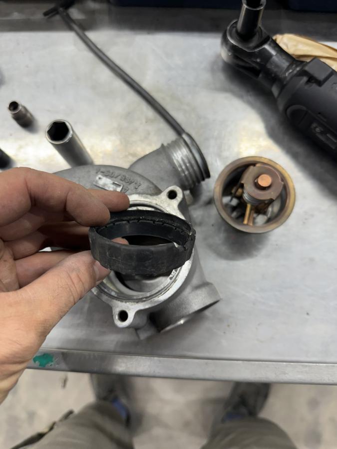

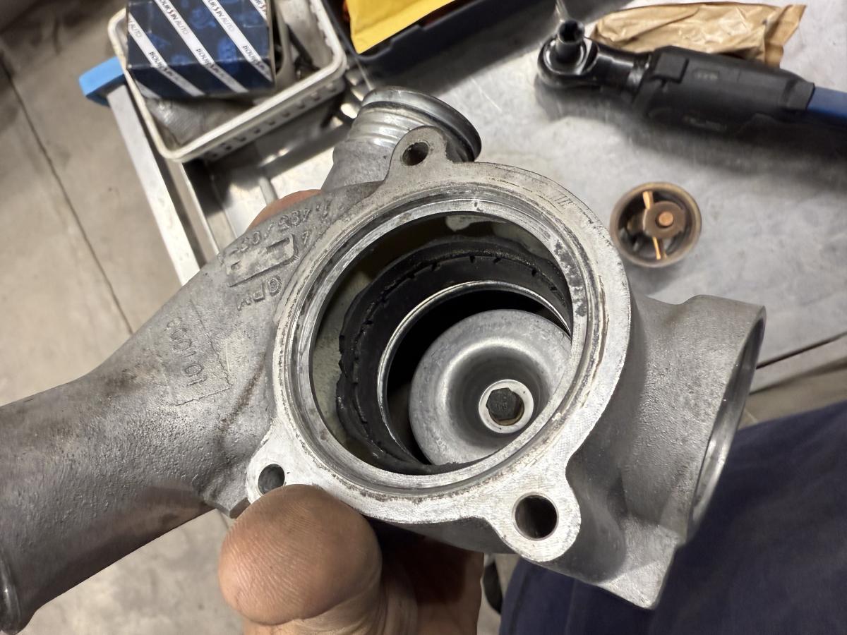

    Sorry to revive an old thread but any idea if there's a solution to this? The seal in my housing is shot and no longer seals against the thermostat. Turns out, that's probably been the cause of my "implausible temperature" codes for a while now. But, the housing itself is NLA ... dealer confirmed that there are zero in the US & zero in Germany. Of course, I can source a used one but that's going to be a bit of a gamble (that's only going to get worse as these cars continue to age).
