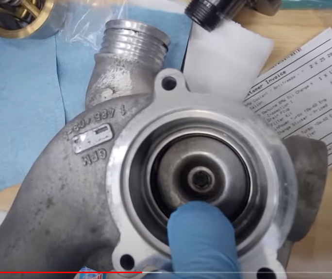

          Thanks Mate but it is actually the O-ring for smaller diameter end for the thermostat, as shown here: https://youtu.be/JZs6DD8JUKY?t=532
          Click image for larger version  Name:	image.png Views:	0 Size:	466.5 KB ID:	271745​

              Is there actually an oring in there?
                Its not a o-ring, its a lip seal like a crank seal. BMW doesn't list the S54 separately.
                This is a for an S62, same idea, maybe its the same part, IDK off the top of my head: 11531312287

                  It could be the same seal but the housing is definitely different.
                    It appears to be a carbon impregnated PTFE (Teflon) wiper seal. I wouldn’t expect much if any wear, although I did replace my tstat housing at 180k miles to rule this out as a failure mode. Pressing a thermostat into a new housing should feel noticeably more difficult than a used housing as the teflon is permanently deformed. As long as there’s no debris in your cooling system, this should last the life of the engine.
                      It appears to be a carbon impregnated PTFE (Teflon) wiper seal. I wouldn’t expect much if any wear, although ... As long as there’s no debris in your cooling system, this should last the life of the engine.
                      The thermostat doesn't move against the seal except for when it is installed so I wouldn't think it would wear at all? My biggest concern is that it would loose its tension against the thermostat housing. I don't know if that is a realistic concern but I have seen the seal fall out (and it was not reinstalled whether on purpose or accident and boy did that create a huge headache to figure out). I've also seen (2) cars have coolant temp plausibility faults until the seal/housing was replaced.
                      ...I did replace my tstat housing at 180k miles to rule this out as a failure mode. Pressing a thermostat into a new housing should feel noticeably more difficult than a used housing as the teflon is permanently deformed...

                        The thermostat drags against this seal as it opens in the s54, it’s an interesting design. When you remove an old thermostat, you should see witness marks from where the seal rides. Interesting that most thermostats I’ve seen now didn’t open completely straight, based on the witness marks.
                        If one fell out, that would be a time to replace with a new one! Good call there, that would be hard to debug.
                          You are absolutely correct, bad memory on my part, thanks for correcting me.

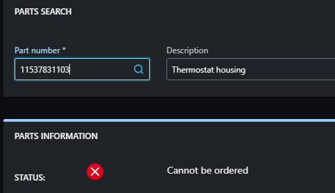

                            Well this sucks. I had one on order at my local dealership since reading this thread in September. Now appears to be NLA.
                              So is the housing worth replacing at 100k due to this seal or is it just a waste of time?
