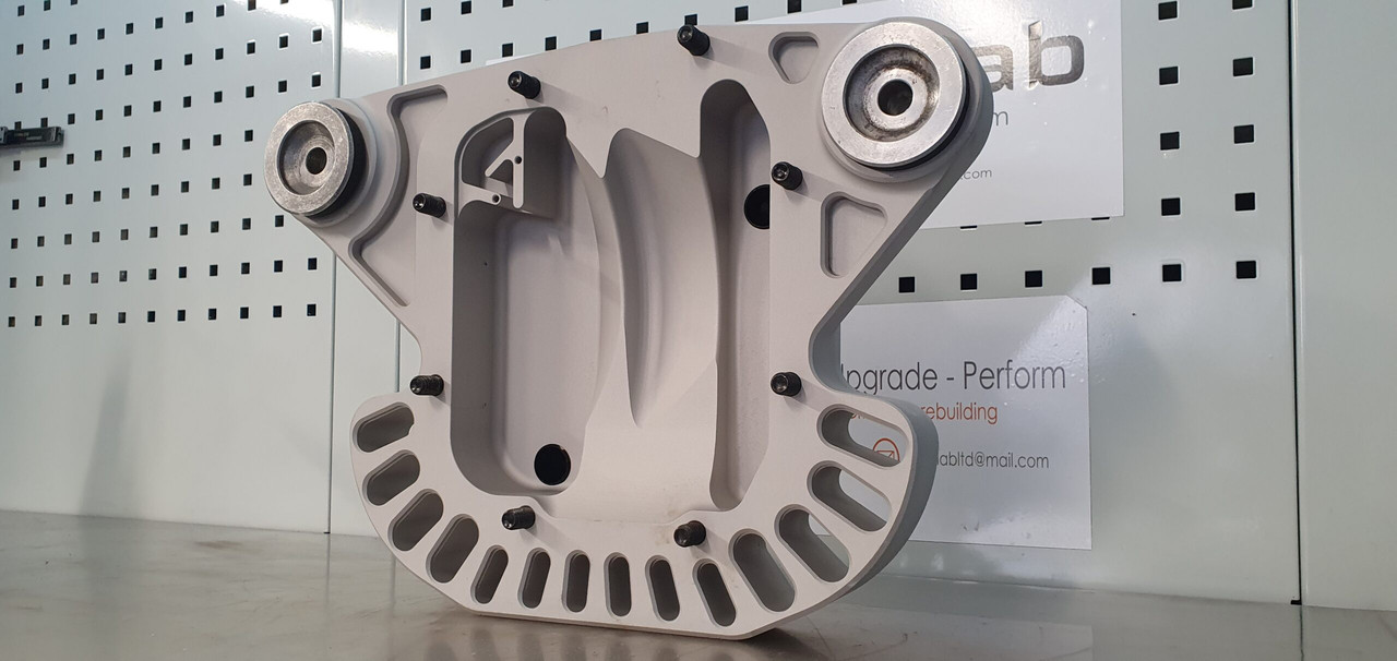

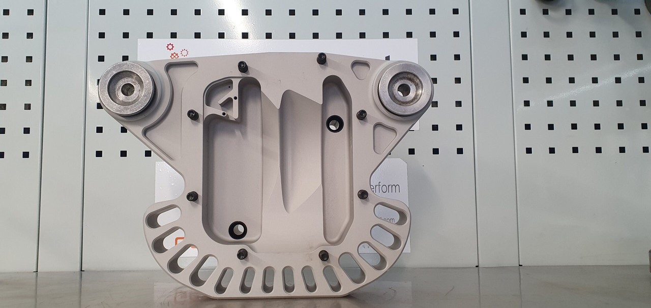

                  Is the design of the Gearlab one any better?
                  Announcing our much anticipated Gear Lab Billet Aluminium finned Diff Cover. We have been working on this cover for many months and are now delighted to bring you the best product possible. The cover boasts some great upgrades over the OE stock differential cover and other flat back aftermarket covers available.   GearLab Motorsport Billet 6082-T6 Finned Differential Cover Bush Mount   Available for the E46 M3 2000-2006   Check out some of the upgrades. • Machined from billet T6 aluminium. • Improved oil flow. • Improved design to improve cooling efficiency and heat dispersion. • Muffler silencer breather vent to avoid any debris or contamination entering the differential. • Increased oil capacity. • Oil breather baffling plate. • Pre-machined blind hole for oil temperature sensor. • Comes with original OE bush mounts for fast road vehicles or solid mounts for Track focused users. (No bushes are included however can be purchased separately, can also be used with power flex or Super Pro bushes all can be provided at additional cost) • Includes 2 pin Temperature sensor which monitors -40°C up to 150°C ideal for race applications or fast road users. (2 pin male connector 1PR) • Increased strength over OE stock cover. • 10mm solid mounting support (to avoid the common crack on the OE stock cover) • Neodymium magnetic swarf collection plug. • Laser printed Gearlab logo • Oil cooler compatibility. • Inlet and outlet ports for oil cooler or catch can. (AN12) • Fitting kit included (X8 12.9g High tensile Allen head securing bolts) • Anodized in two colours Black or Silver These improvements all help increase the performance, oil life and economy of your differential. No more cracked mounting brackets which are common on the OE stock cover. The cover is specifically designed to minimise aeration within the oil, this helps to reduce heat and viscosity degradation of the oil. Fluid flow pathways allow oil to direct to key areas, imperative to the longevity of any differential. We have created the optimum distance between the crown wheel and the oil raceway for the most efficient paddles of oil to be directed were its needed most.

                            That looks to be a better design than the VAC...which is the similar to OE. Again, what's the point?
