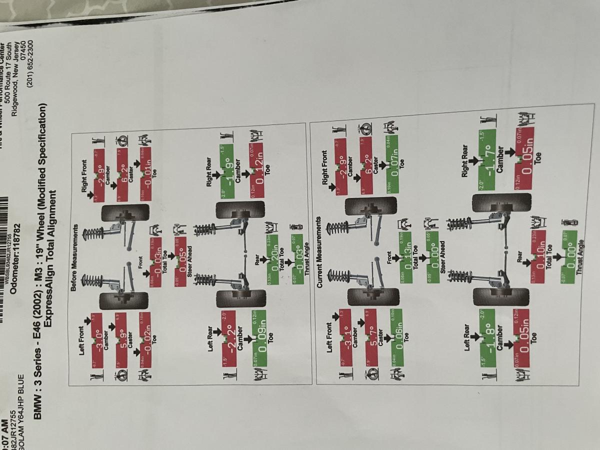

              So I ended up going to an alignment shop and did the proper alignment. Attached are the specs. The tech told me that he can’t get the camber to be any more positive because the car is too low. Now I have negative 3 camber and my car drives perfectly straight but I’m concerned I have too much camber for a car that I daily and don’t track. Plus the stability of the car did get better with more toe in but still not what it used to be.
              I don’t want to raise the car now and then pay for another alignment since I’m down already down $360 (200 from rogue engineering alignment and 160 for the recent alignment).
              what do you guys recommend? Is -3 okay for street use ? Should I raise the car a bit to get a bit more positive camber ? Will it throw the alignment off a lot of I raise the car ?

                It will throw the alignment off. -3 is a lot for a street car, ideally you'd want to be at -1.8 to -2. That being said, if you're having fun with the car and going on backroads it's worth it. Just skip the next alignment, leave it as is and save that money for tires.

                  -3 is way, way too much. There is nothing you can do on the road to necessitate that kind of camber. Anything over the stock capability of about -1.5 will start to seriously shorten tire life for little to no benefit on the road. It's not like it's difficult to make the car turn. It's still pretty damn neutral stock.
                  I'm turning my camber back down from 1.8 because that ate my tires too fast. And it's not a DD, in fact I only take it to the back roads except for a few long highway trips every year.

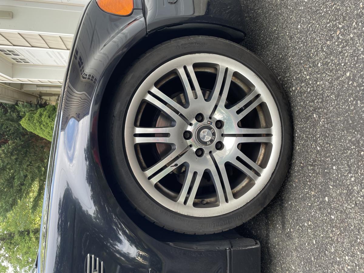

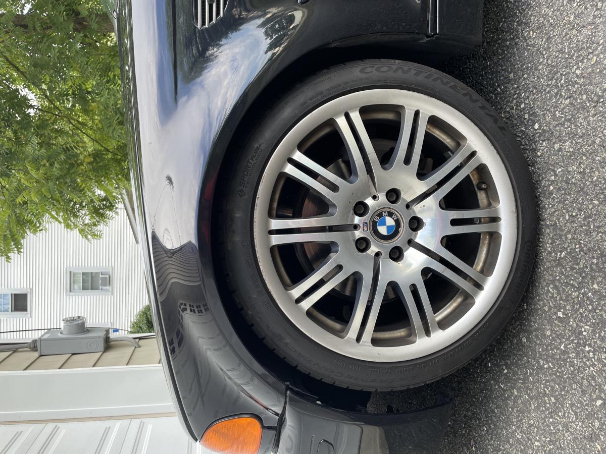

                    Tbh you might just be experiencing tramlining from the front camber. Have you had other very low cars like this before or is this kind of new territory for you? What are your front wheel specs? Pictures of how low it is?
                          Well I have an e39 m5 which is definitely not low as this and driven a 997 with 4.0 L engine which is low but still doesn’t feel unstable at high speeds.
                          Im running a stock setup. 19 inch rims in the front on 225/40/19
                            For comparison, my sister a e90 with sports package and it has 3 fingers of space between tire and fender on stock suspension. My m3 has 1 finger and it’s tight.
