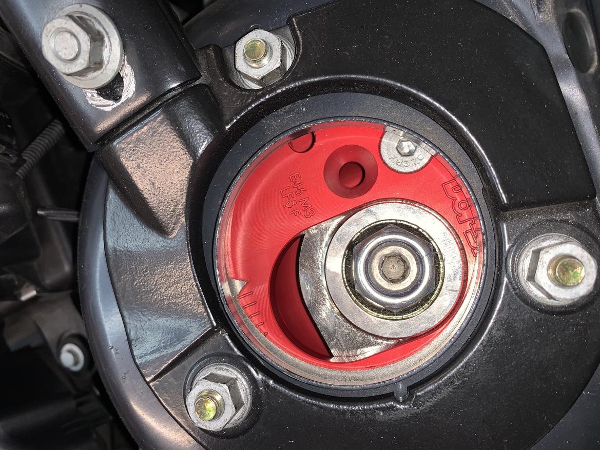

        What upper mounts do you have? Can you post a picture of the top mounts how they are positioned in the car?

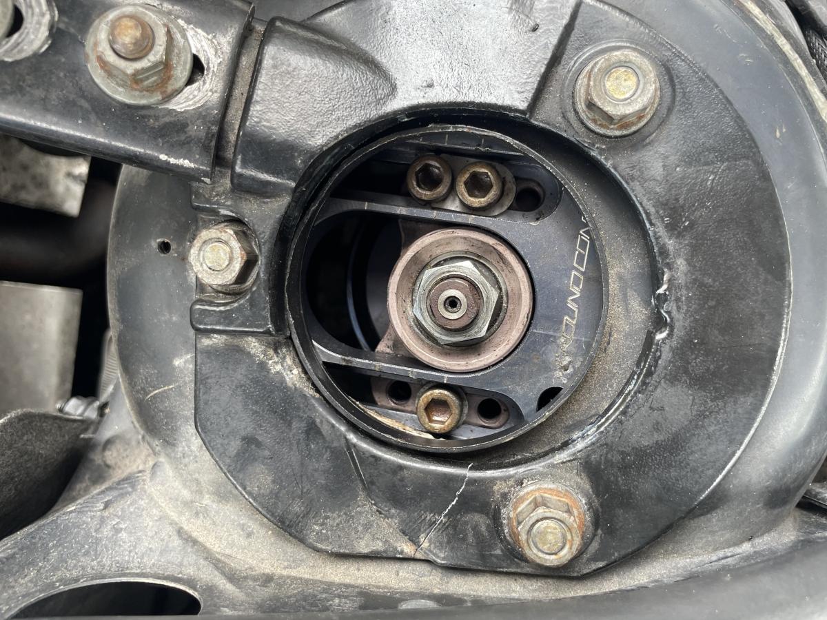

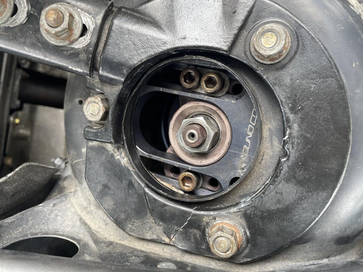

              Pretty frustrated to be honest - I just called the alignment tech back and he claimed that the camber plates that I have (ground control race plates) are already set to the most positive camber possible. So the only options I have is raise the car both sides by about an inch and get an alignment done again OR he said I should buy new / different camber plates that allow more flexibility 🙄
                You might have non-M camber plates, which are different than specific M3 plates.
                The non-M cars need plates with a lot more negative camber due to differences in spindles.
                  They are def for for the m3 - i actually bought them off of a forum member here who used them on his e46 m3. I dont think ground control makes non-m camber plates

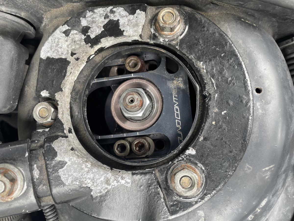

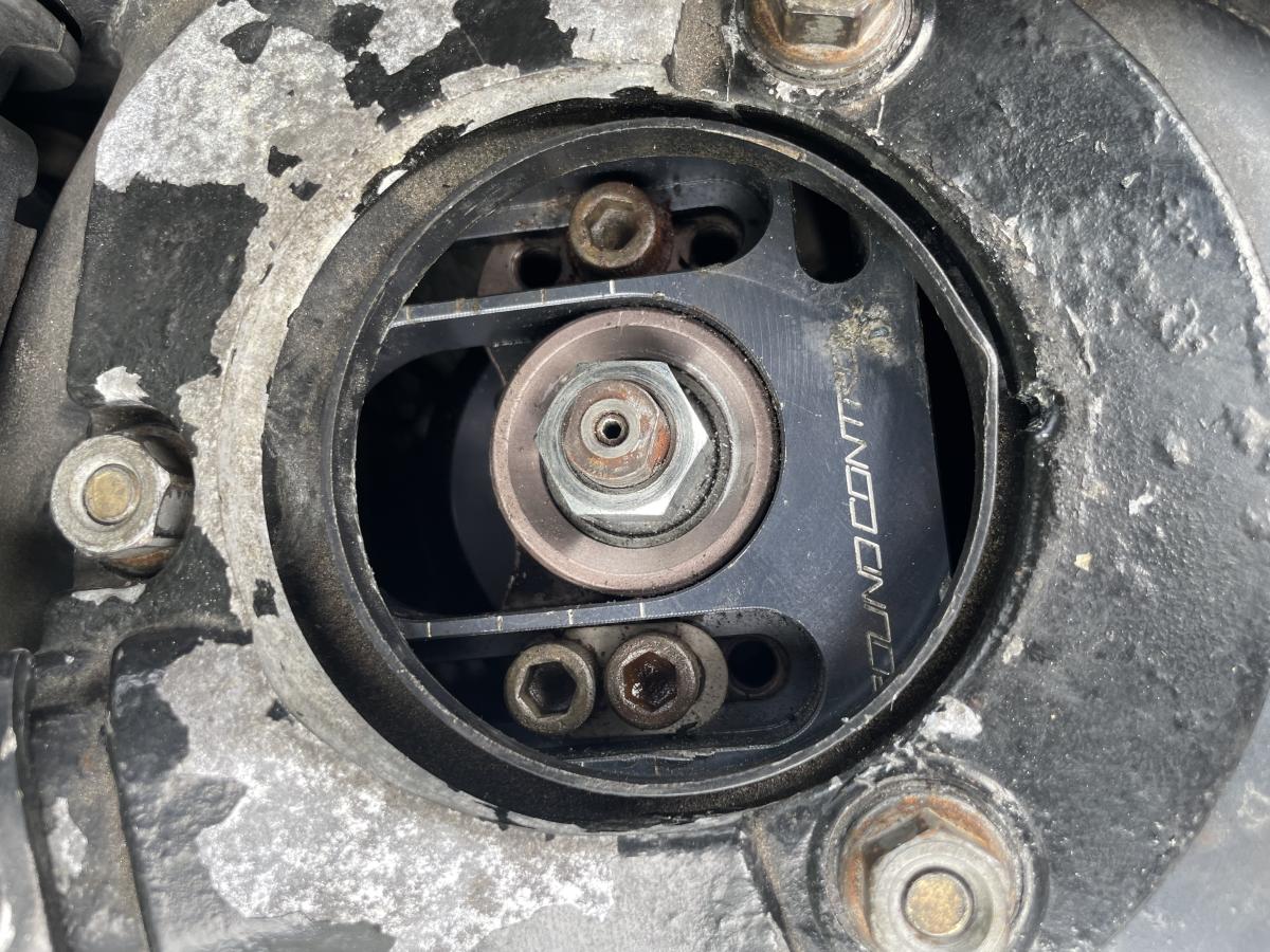

                    Those camber plates are clocked wrong. They should be installed with the ground control engraving towards the front of the car. So rotate them one hole clockwise. The caster will need to be adjusted.
                      Actually, they do. But it sounds like jayjaya29 figured out your problem.
                        i just called ground control and they confirmed that the fitment of the plates are correct. The pictures i have sent are from me standing next to the fender looking at the plates.

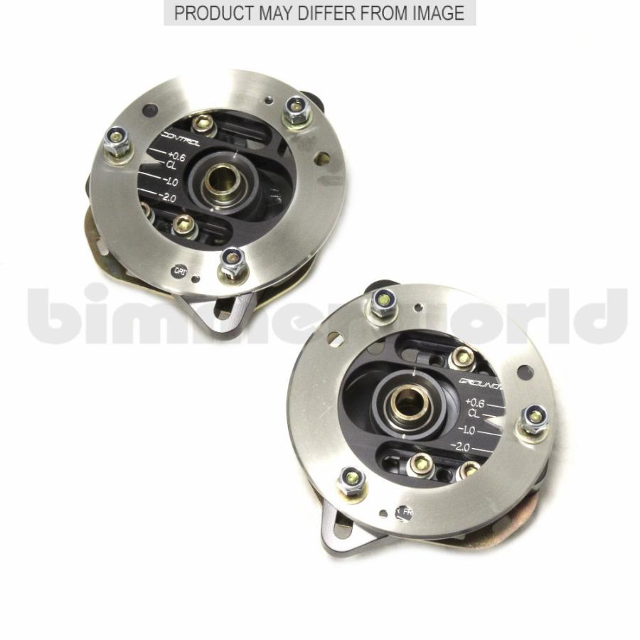

                          Look at these plates. The pointer is for adjusting camber, the slots allow the camber to be adjusted easily. The allen head screws adjust caster and are harder to adjust since its not adjusted as much as camber is. You can also just barely make out the arrow on the bottom plate that is supposed to point towards the front of the car.
                            Here is the correct orientation:
                              Edited for incorrect info, these actually look to be installed correctly
ID:	272419 Just to confirm, right now they are installed the same way shown in the picture below with the “ground control” lettering showing horizontally if I am looking at them from the fender side. If I rotate them one hole clockwise the “ground control” lettering will essentially be vertical and that’s the correct orientation?
