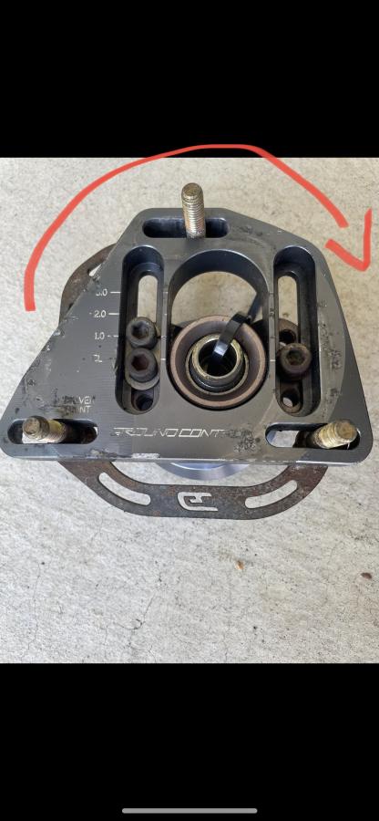

    Originally posted by Leafsrule531 View Post
ID:	272419 Just to confirm, right now they are installed the same way shown in the picture below with the “ground control” lettering showing horizontally if I am looking at them from the fender side. If I rotate them one hole clockwise the “ground control” lettering will essentially be vertical and that's the correct orientation?
    GC street and race adjust differently, the street adjusts camber with the 3 stock bolts, the race uses the Allen keys
      #32
      Why would GC make the camber adjustment more difficult then the caster? The mind boggles.
        #33
        So my installation is correct ?
          #34
          Yes.
          Although I think if you did rotate the plates one hole clockwise, they should still work as intended (and maybe be able to dial in less camber).
            #35
            I also thought this was weird, went through this with a buddy recently. If you’re used to looking at top mounts that don’t adjust caster, like KW etc… it looks like you have them installed rotated 90-degrees incorrectly, but yes these are right.
