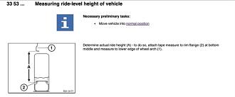

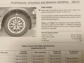

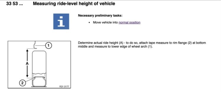

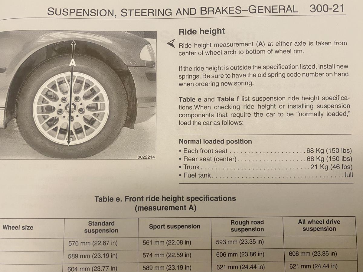

              You measure from the bottom lip of stock 18”/19” wheel to where it first meets the fender wheel arch. This is in TIS and Bentley Manual. The specs given are while the gas tank Full and 150lbs each front seat,150lbs center rear seat, 46lbs trunk.
              Click image for larger version  Name:	IMG_0484.jpg Views:	0 Size:	161.8 KB ID:	274995
                TIS

                  Isn't that what the TIS saying?
                  Oh wow didn't know about the weight portion.
                    Is so simple, follow TIS. It doesn’t get any easier
