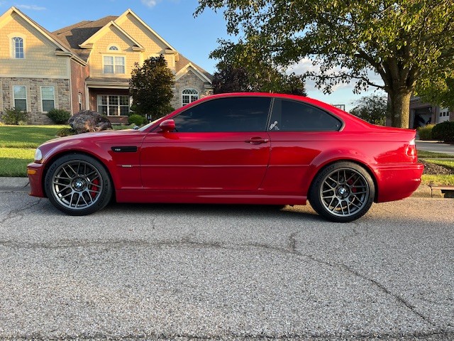

ID:	276112 So went with 14” front, 13.3” rear. I think it looks good.

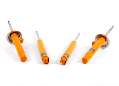

                  The rear dampers are almost guaranteed to be blown at that mileage. Low mileage OEM springs are a dime a dozen and cost a fraction of that. Used OEM springs (100USD) and new OE or Koni dampers (800-1000USD) would bring the suspension (minus bushings) back to how it was from the factory.

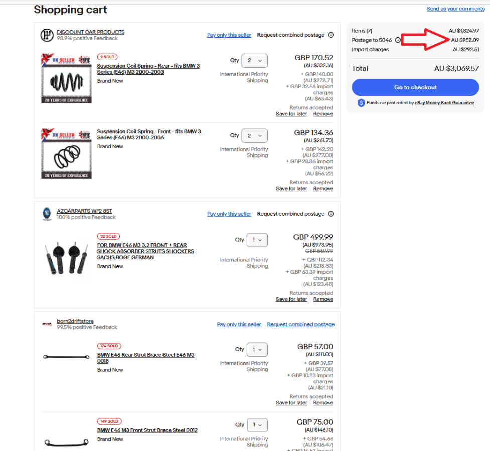

                    Definitely on the Buy Now List
                    eBay sluggin some shipping fees though
