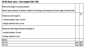

      Thanks. So math to convert to middle of wheel for 18”:
      Front - 606/25.4 = 23.85” - 9” = 14.85”
      Rear - 587/25.4 = 23.11” - 9” = 14.11”

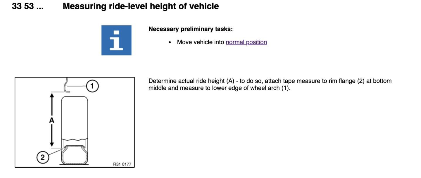

                Wait, this is measured from the bottom of the rim? Right where the tire meets the rim?
                  It might be a good idea to measure the face of the stock 18" wheel. On an aftermarket 18" wheel, the face is 19.5" (half would be 9.75")
                    Ok I get it now.

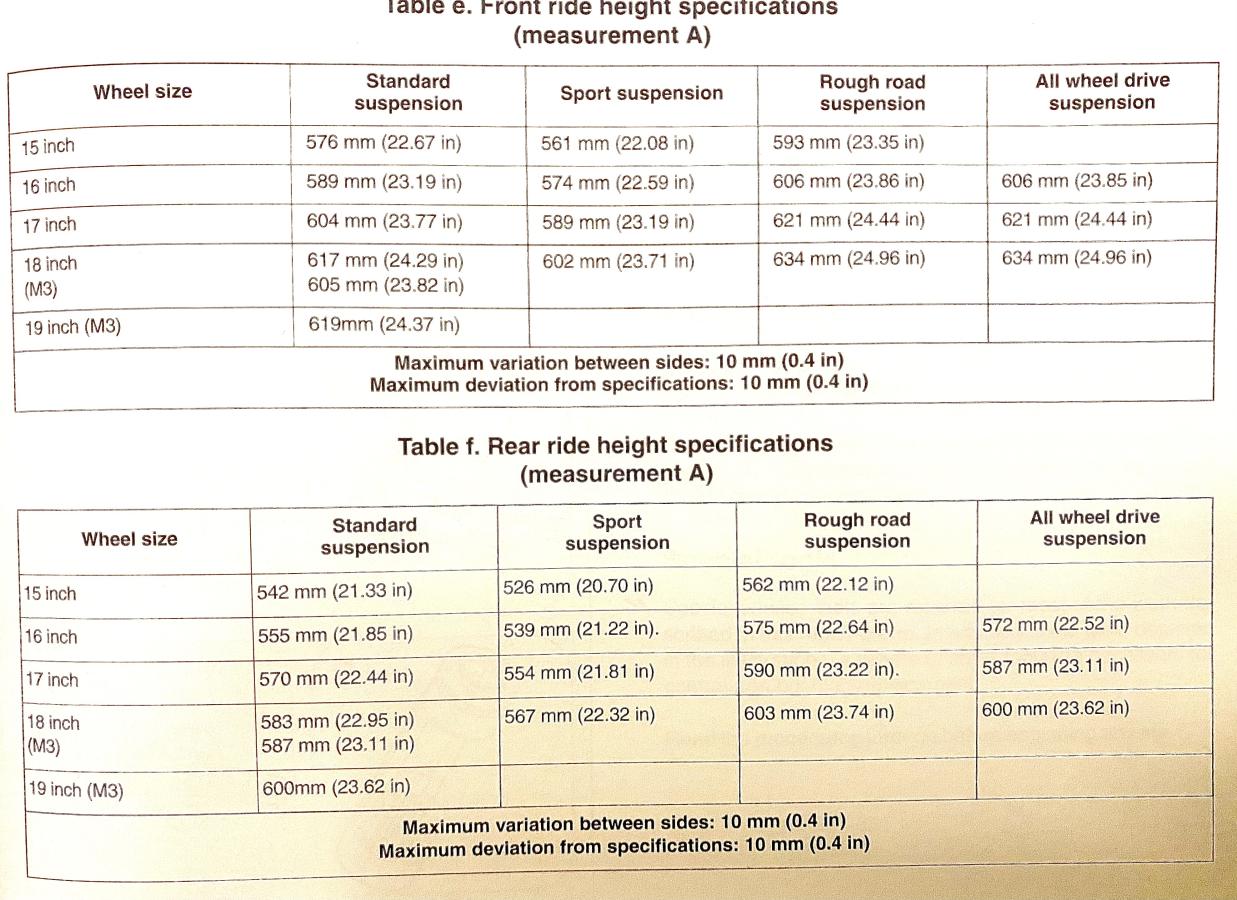

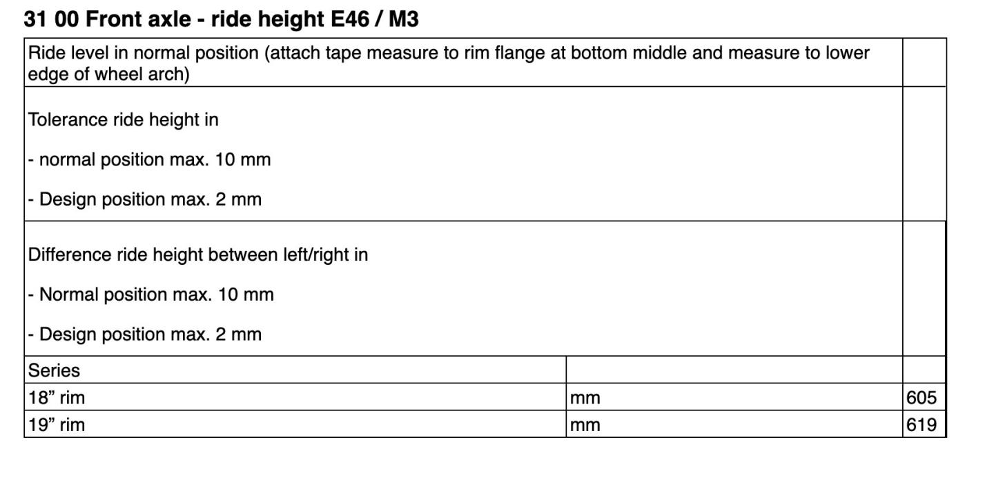

                      Measure as indicated by TIS. You will never be able to accurately place the tape in the exact center of the rim. That is why TIS calls for the rim so you can measure consistently
                        Interesting is that the Bentley Manual has the front 18” wheels at 605mm than the 606mm of TIS. Granted between the two, TIS is official.
                          So we're measuring from where the tire meets rim at bottom? TIA.
                            Yeah you measure from bottom where tire meets then you subtract half the rim length since you can't perfectly measure from "center" of rim.
