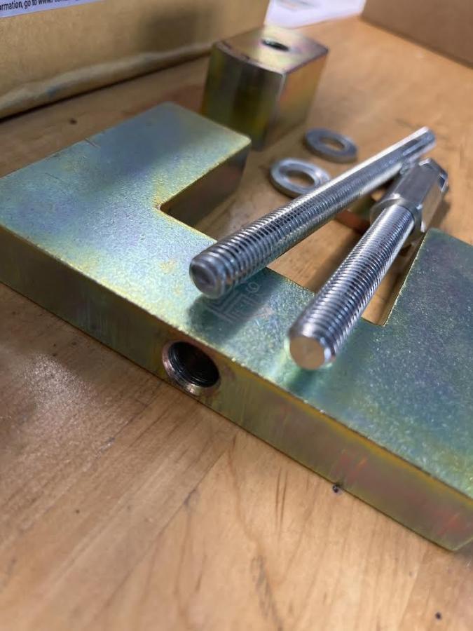

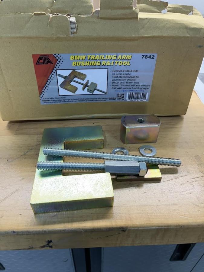

    Was trying to get the job done today, literally waiting for the UPS guy to deliver my brand new tool. Delivered a bit late but got to work immediately. Lined up the tool to make sure it was interfacing correctly with the arm and bushing. Started cranking, cranking, and … pop. The threaded shaft broke. WTF. Called FCP and they should be shading me a new one.
    Had anyone ever had this happen? Do I need to put some heat into the arm to get the bushing out?

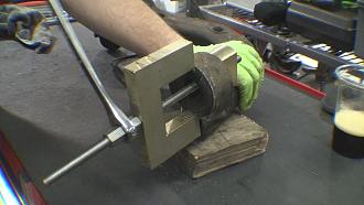

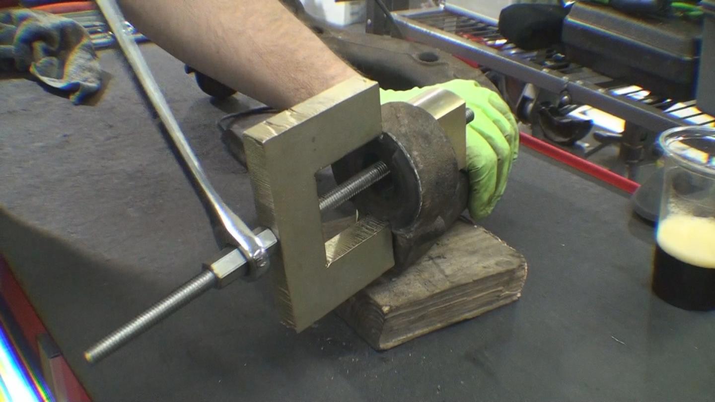

            Interesting that you say to put the tool on the inside. FCP article has you put it on the outside (if we are talking the same thing, see pic). Also matches most of what I’ve seen on YouTube. I’m trying to do this on the car, so putting the tool on the outside is the only viable option (quick project between track weekends).

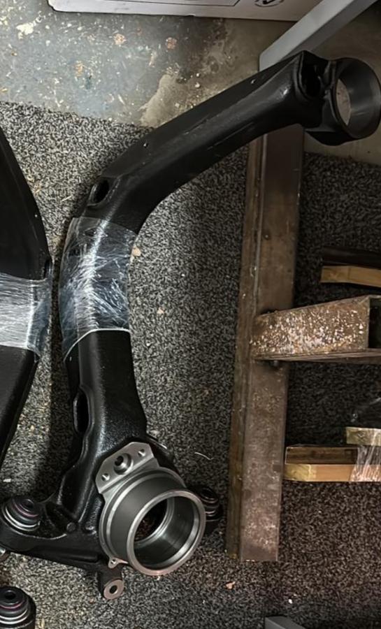

                    Brand new BMW trailing arms from which I removed the stock bushes in order to install CMP spherical ones, you can quite clearly see the chamfer here, it is on the outside.
                      Did the bushing move a little? Once you break it loose it should be easy the rest of the way, it looks like the longer rod of the two broken pieces in your photo would work, if so maybe try again?
                        Yes the chamber is on the outside. Actually the early factory bushings had a lip on them (with cutouts). They could only be removed from the outside. And thus only installed outside to inside.
                          As for breaking the tool’s threaded rod. You need to oil the rod if it’s giving a hard time. Back it out and re-engage. The MIS tool uses a high grade rod, not sure one used in the CTA brand. But yep doing it wrong and forcing it can break it. I’m sure they sell replacement rods. Might do that instead of junking the whole tool. That’s why some places that rent the tool take full deposits. People doing it wrong can break the threaded rod.
                          *Edit just looked up the CTA tool..”Made in Taiwan”. Enough said.
