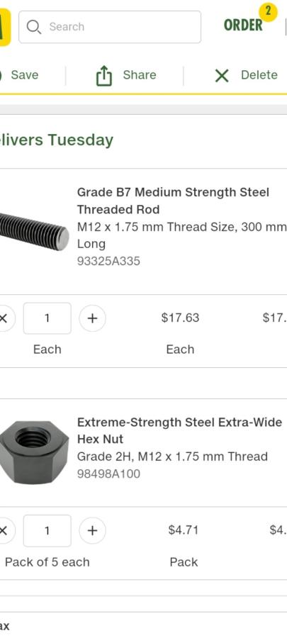

    I bought these from mcmaster.com and used spacers from my wheel bearing kit and some washers. It worked for my rtabs and also all the ball joints for removal and installation.
      Bushing never moved. Other than oil on the thread and heat (which I don’t think most people use) I don’t know what else I could have done differently. I have removed bushes before and did not use a gun. I think the tool could be more robust.

                      Looks like the original rod is cheap thread-all. Better tools come with a hardened threaded rod - Class 12.9 or Grade 8. Not cheap either.
