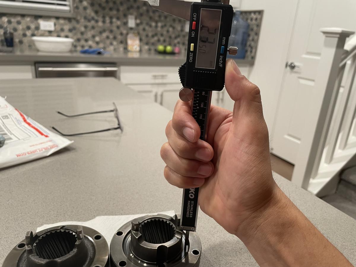

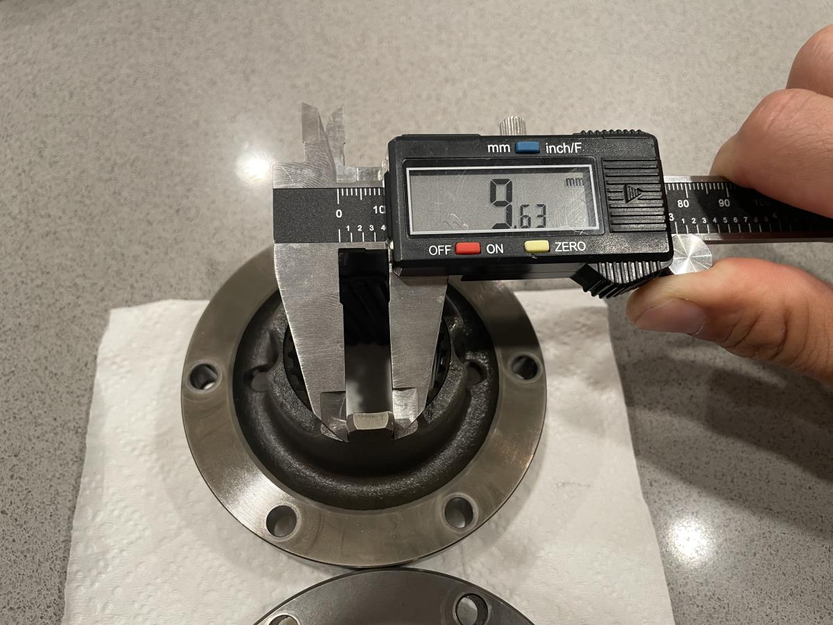

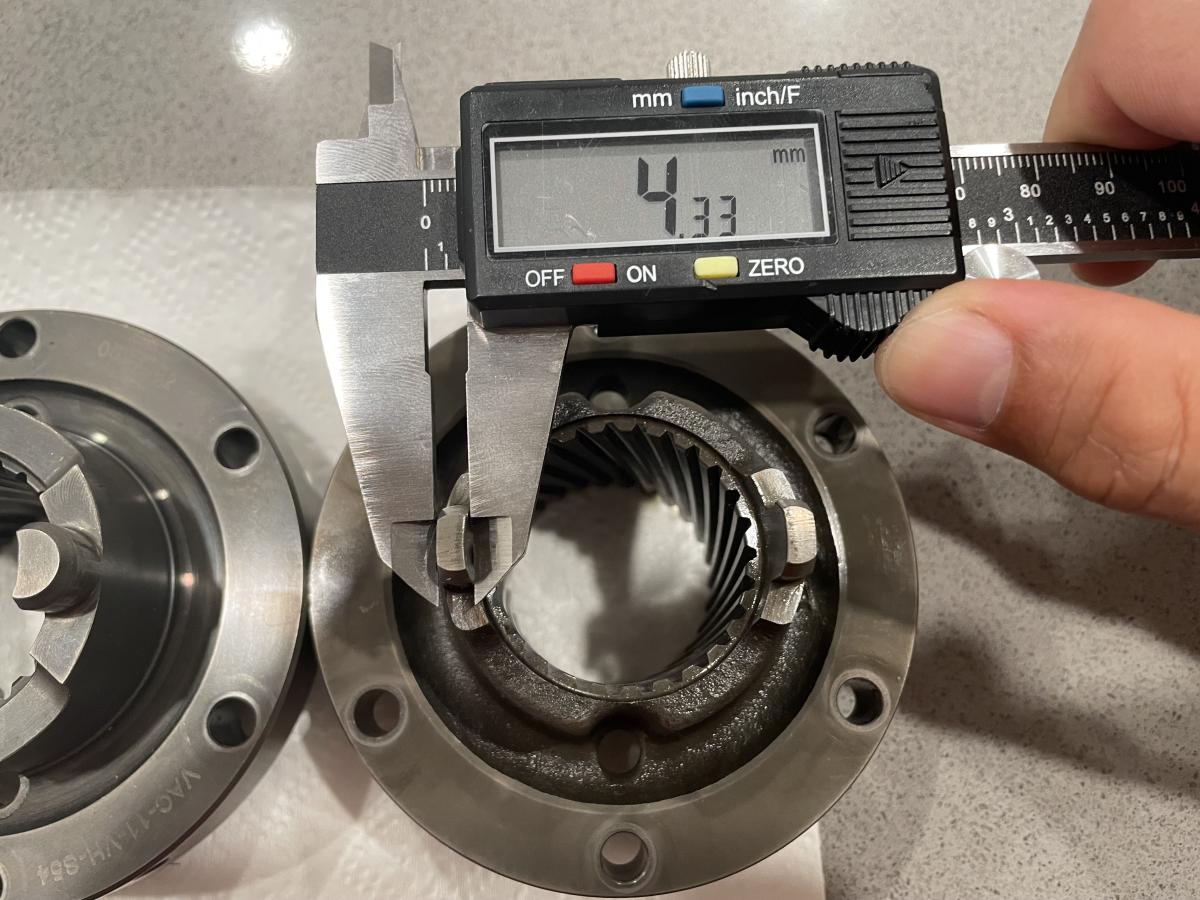

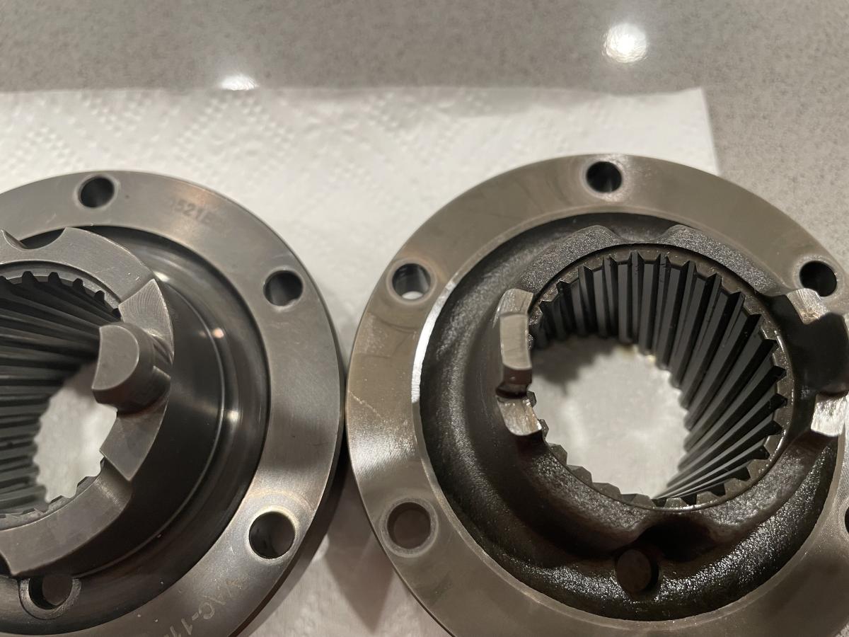

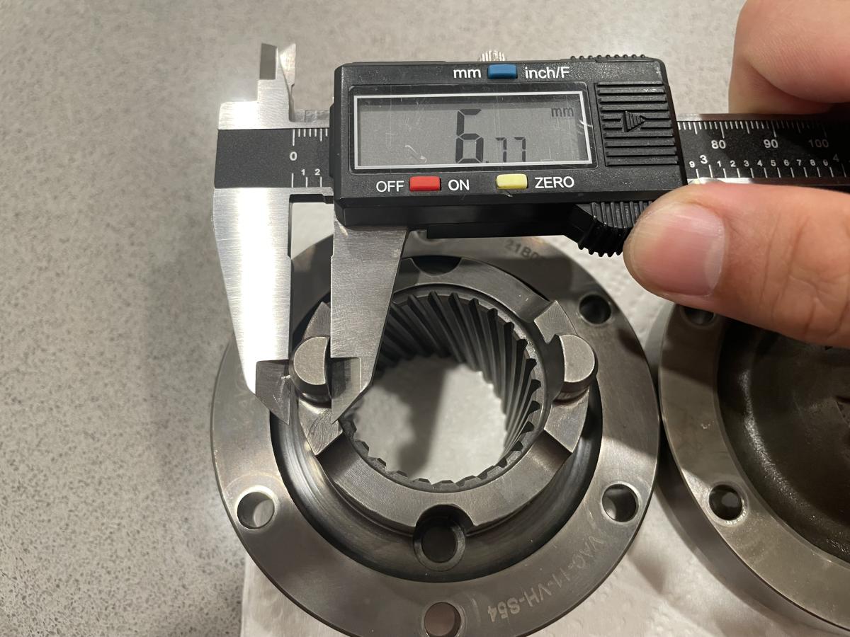

    I also chose to install a VAC hub as a way to prevent those driving tab from breaking.
    As you can see the tabs are not only larger in diameter, but also in width

    Also, there is a draft needed for manufacturing, which the VAC items does not have, this makes possible to have the width of the tab increased

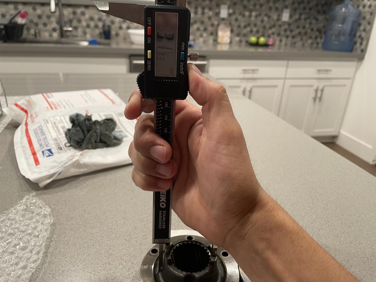

    Another observation is the thickness, VAC is 0.1mm thicker. this does not matter, but a nuance non the less.

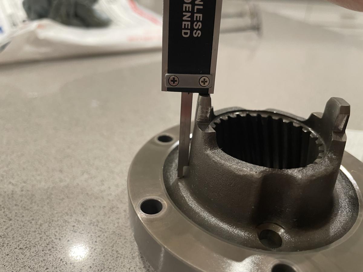

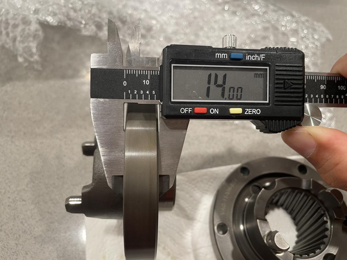

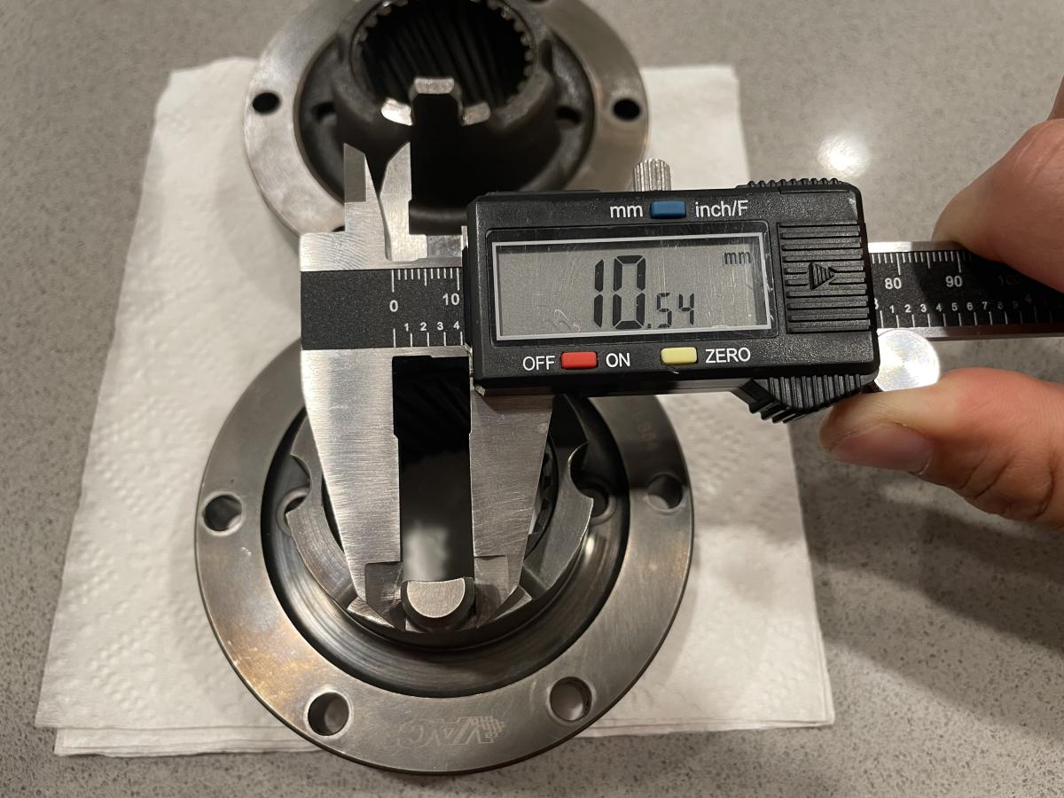

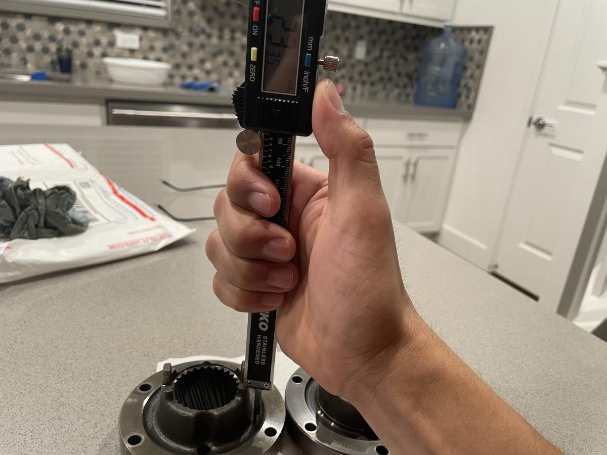

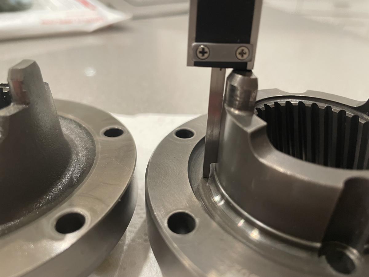

    I measure the depth and height of some surfaces and there are some variations as well but those could be due to measuring method

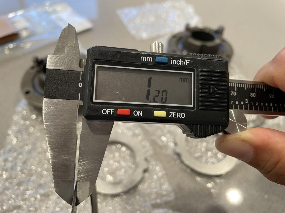

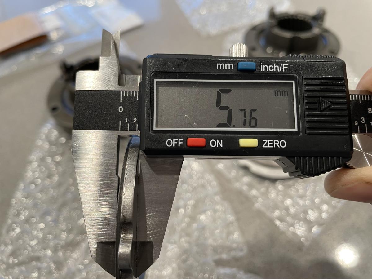

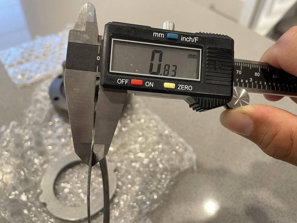

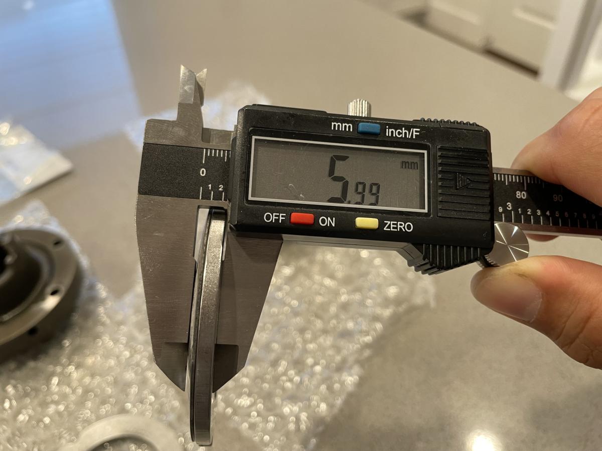

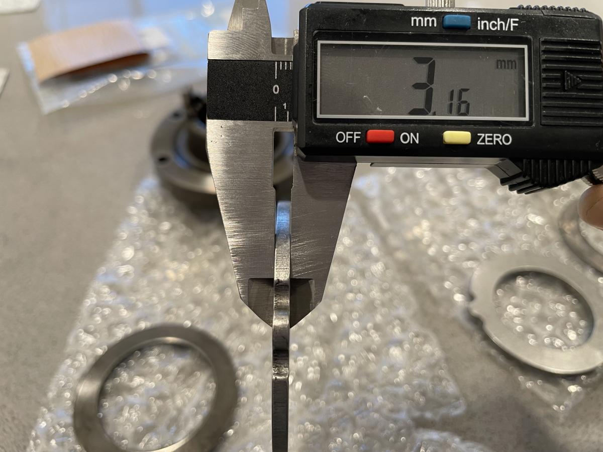

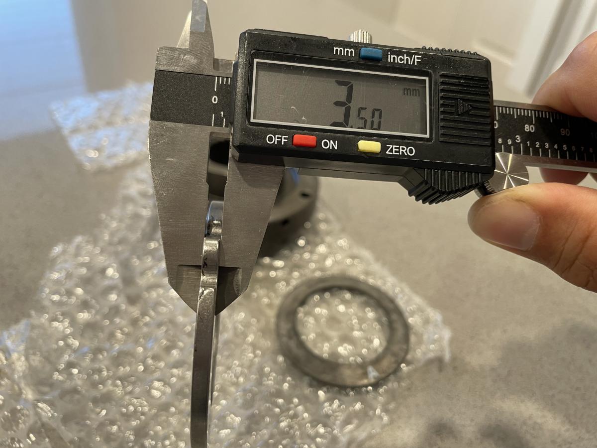

            I have compared the diaphragm spring sets and is interesting, the S62 individual items are thicker. However, the complete stack is taller on the S54 items, but being thinner, the spring washer will have less preload force.
            S62, the retaining plate is 3.16mm and 1.2mm thick.​
            Click image for larger version  Name:	IMG_0885.jpg Views:	0 Size:	117.9 KB ID:	273456
            Click image for larger version  Name:	IMG_0886.jpg Views:	0 Size:	107.6 KB ID:	273457
            The S54 retaining plate is 3.5mm and the sping washer is 0.85mm
            Click image for larger version  Name:	IMG_0887.jpg Views:	4 Size:	115.4 KB ID:	273460
            Click image for larger version  Name:	IMG_0888.jpg Views:	4 Size:	114.7 KB ID:	273459
            However, the stack of the two, is taller on the S54

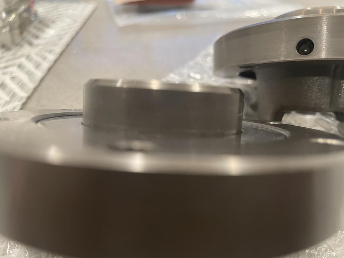

            Once seated in the hub, the S62 stack is a bit more recessed, you can see that when compared with the chamfer around the edge of the pocket. this is only 0.25mm.
            The plate is almost flush with the chamfer's edge.
            The S62 stack is a bit recessed, you can see the "step" from the retaining plate and the chamfer. however, the spring will have higher preload force as the spring washer is significnatly thicker.

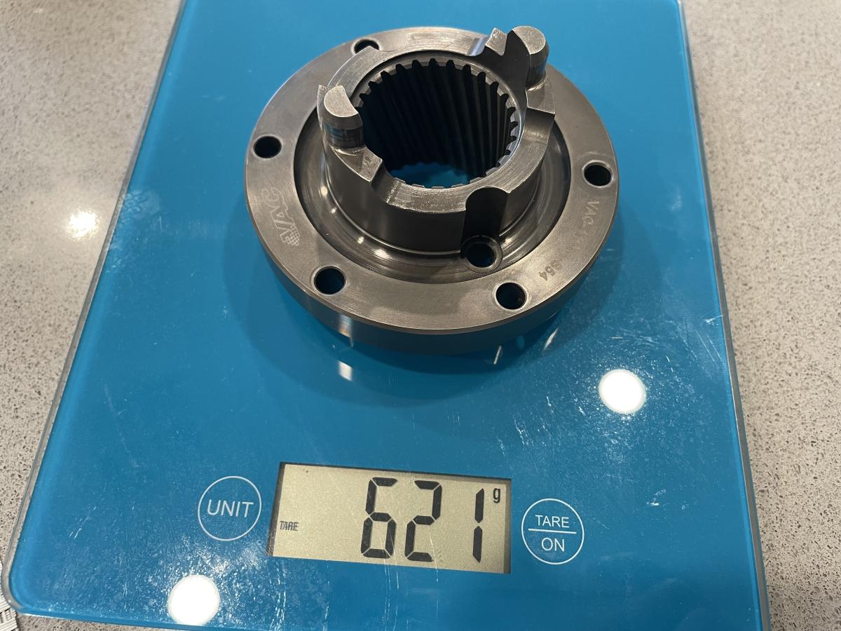

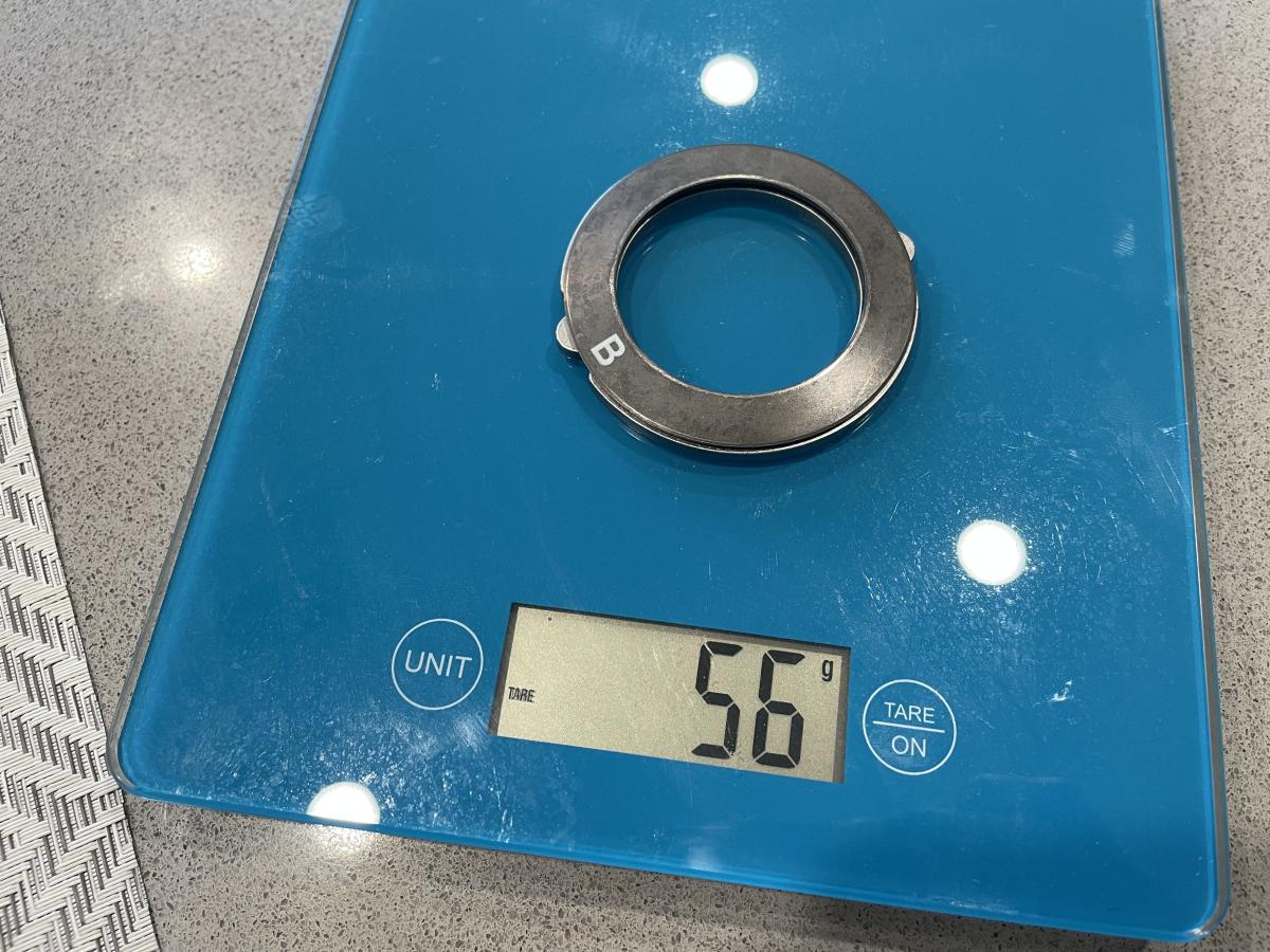

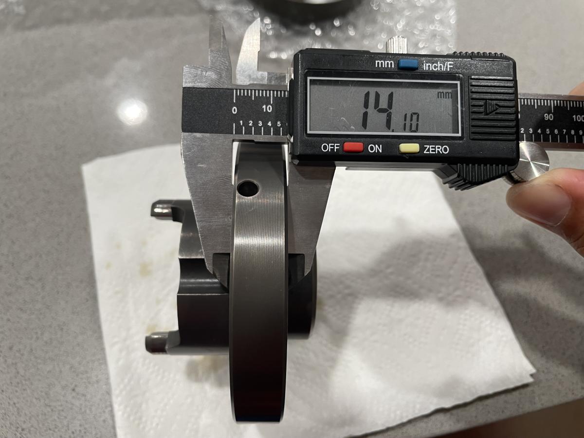

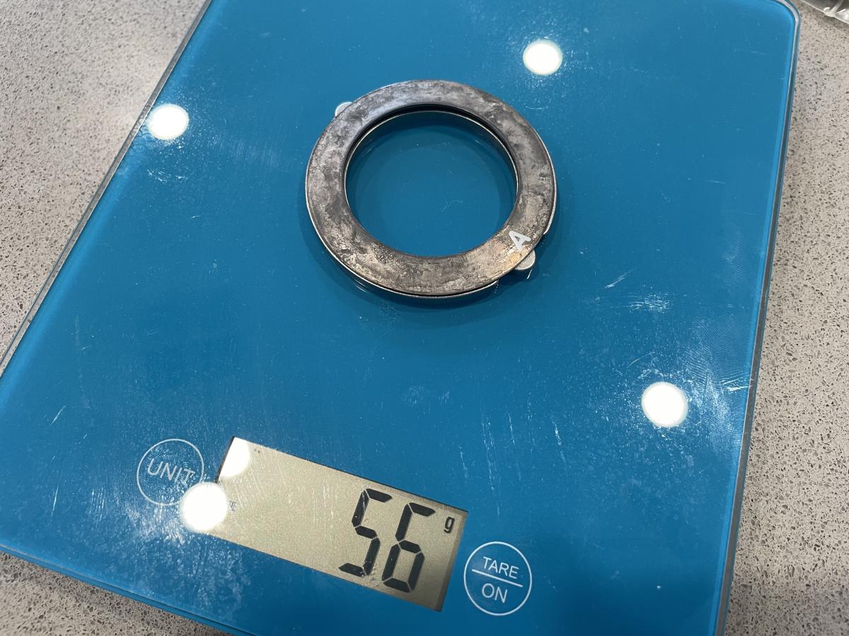

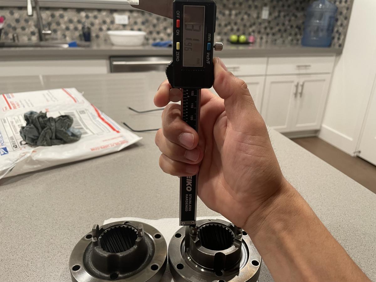

              I measured the weight of the hubs, unsurprisingly, stock is lighter. Springs sets are the same weight
              Click image for larger version  Name:	IMG_0899.jpg Views:	0 Size:	142.8 KB ID:	273521
              Click image for larger version  Name:	IMG_0900.jpg Views:	0 Size:	183.3 KB ID:	273523 Click image for larger version  Name:	IMG_0902.jpg Views:	0 Size:	153.8 KB ID:	273522
              Click image for larger version  Name:	IMG_0901.jpg Views:	0 Size:	167.4 KB ID:	273531
                Your measurements are close to the BMW ones.
                The official measurements are 0.85mm and 3.55mm.
                And 1.25mm and 3.20mm.
                Early (up to 09/2001) S62 came with the A (S54 style) springs, then BMW changed them for the later models to the B springs that we now refer to as S62 ones.
                Interestingly BMW also wants you to install the new style S62 springs with the smaller side of the spring towards the hub, not towards the eared retaining plate like on the S54.
                However since BMW did this change from 09/2001 going forward, which was still quite early in S54 production, I think they would have also applied it to the S54 if it were deemed necessary.
                I am looking forward on someone doing a VANOS test and a video of noise before and after with the only change being the A vs the B springs.
