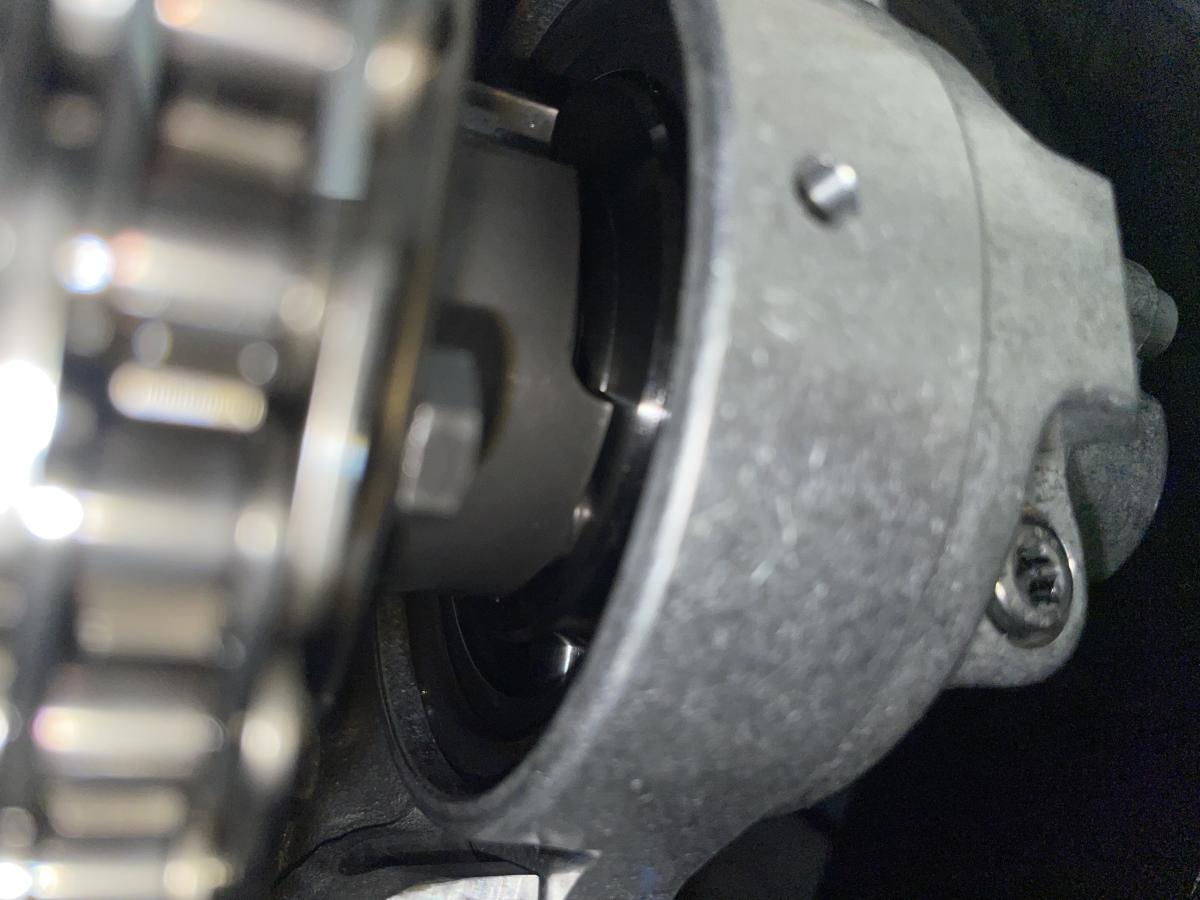

    I milled the holes for a slight interference fit so you have to lightly pry the disc off the hub tabs..
    Interesting about the extra smaller holes. This can cause assembly problem with the vanos housing mounted on the head with the two dowel pins (sleeves) as machining tolerance built up from many component, leading to the disk holes slightly off from the hub tabs. This is why the OE hub tabs have chamfer at the leading edges. Bolting down the vanos could crack the hub tabs. I drilled the new holes with about 0.002" larger than the tabs.

      You are getting hung up on the semantics. The tabs are thicker, but not wider, wide in this context means the diameter of the base circle of the tabs, or better said, posts, that drive the disc. The thickness comes from the draft angle. VAC milled the hub with straight walls as shown in my photos which result in thicker posts, further still the base circle of the posts or tabs are larger resulting on the same as if you redrilled the disc with smaller holes. So either solution is effective.
      the thought that you can use the Beisan hub with OE disc is supported by the added thickness, despite the unwanted slack remains, the Beisan hub would be less prone to fracture due to the thicker posts.
      can be confusing but is pretty straightforward. Just look at the photos.

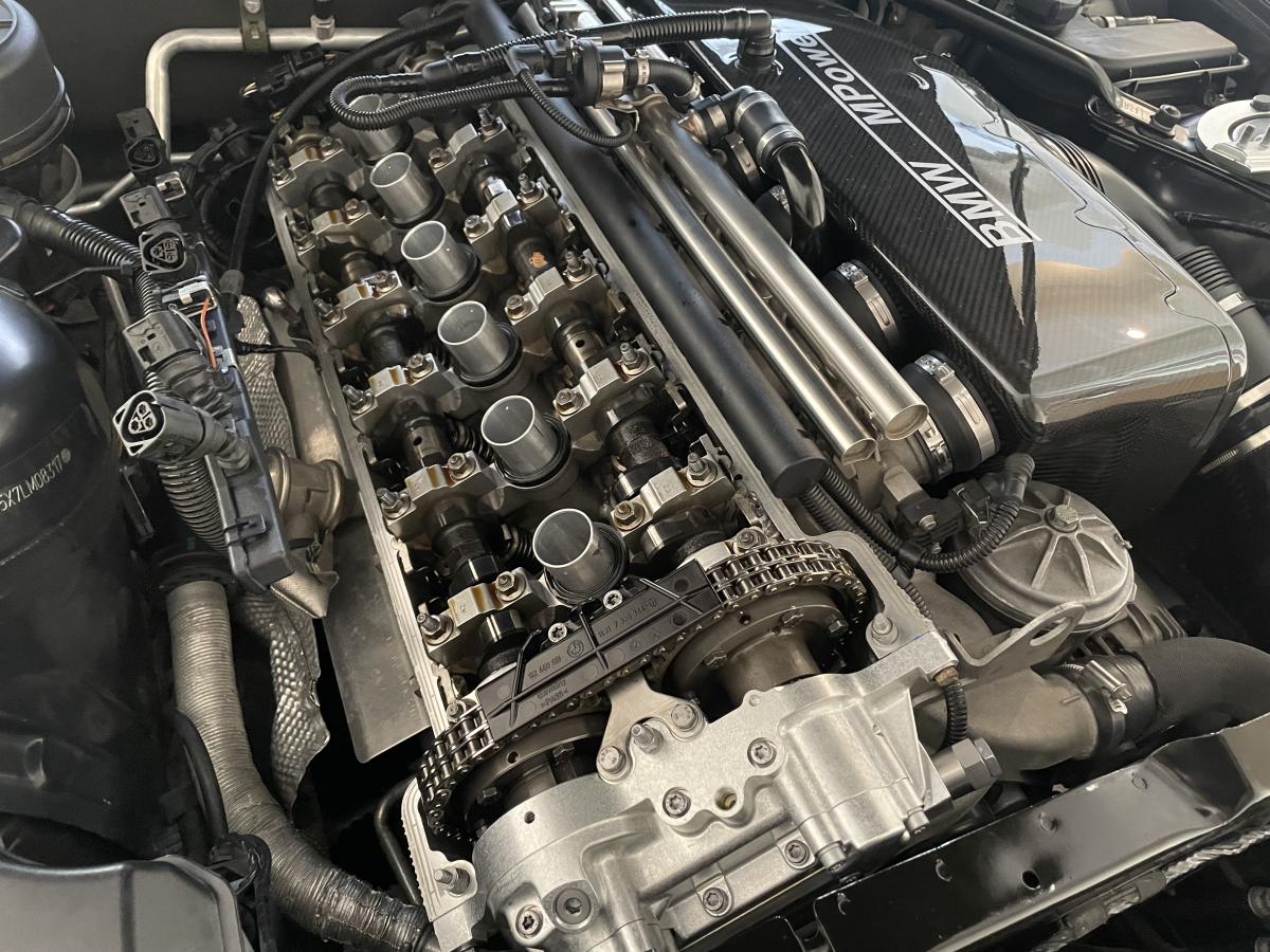

        Put the car back together. I had no issues setting the timing. I also changed the tensioner and adjusted about 4 valves on the intake side that needed reset.
        I need to drive the car and will run the VANOS test.
        the fit of the VAC hub is on point, same as OE really. And it solves the clearance issue just as well as redrillig.

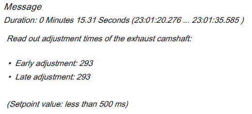

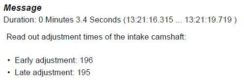

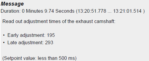

          As they say, the proof is in the puddin. the S62 do slow down adjsutment time.
          Results are as follows
          Camshaft Positioning
          Advance Exhaust 128DEG
          Retard Exhaust 80DEG
          Advance Intake 70DEG
          Retard Intake 130 DEG
          Exhust Adjustment
          Early adjustment: 195
          Late adjustment: 293​
          Intake Adjustment
          Early adjustment: 196
          Late adjustment: 195
          Leak test came at 2DEG for both camshafts.
          As you can see, timings are much better with the S54 diaphragm springs, with the S62, i would always have 290ms as indicated in my original post.
