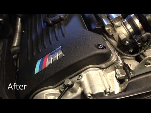

                  They were supposed to reduce noise.
                  This video does not mention the S62 springs, but it is a before and after -
