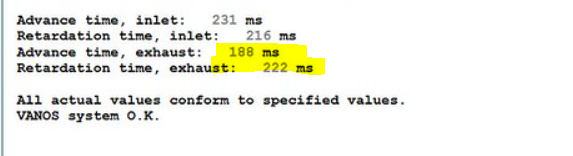

      I had a client stop by today and I ran the Vanos test on his car. I don't have a before, but I do have an after. His car got everything plus the rattle kits for the splined shafts. These two tests span about 30k miles.
      2020:
      2024:
      This car shows the advancing takes much more time then retarding.
      While the previous car with EX advancing is quicker than Retarding which is odd, below. The only way to explain this is the engine rpm was dropping (decelerating) during the vanos movement.
