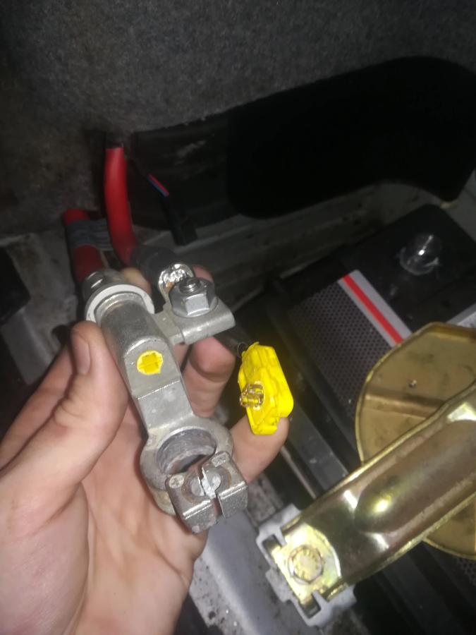

                  Battery disconnected

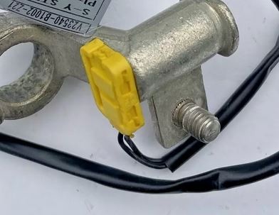

                  Does anything stand out to you?... I've wiggled all I can, and nothing seems to be disconnected or corroded.
                  Does the black tape on the bottom of the yellow connector look factory?
                  I disconnected the yellow connector (in the first two pictures) and nothing appears to be corroded; I suppose I'll have to completely remove the "battery plug" side now.
                  Not that you can see it well in the first picture, but I take it the cable tie isn't factory?

                    Just so I understand correctly, can I remove the pyro fuse from the terminal, check it over, and re-insert it back into the terminal?

                        The fuse is not the yellow object. The fuse is an explosive device inside the cylinder section. The two wires are for creating a heating element to trigger the chemical explosive substance, just like the old day photography flash light. When it explodes, the pressure push the two electrodes away from each other to open the contacts.

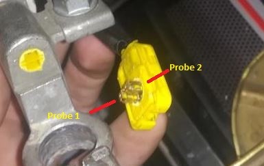

                            I unfortunately do not know how to use a multimeter (DVM).
                            But after watching a few videos on how to measure resistance, I assume the connector side would still need to be plugged in (or not?), and you would put a probe on each fuse pin.. like so?
                            Click image for larger version  Name:	two wires.jpg Views:	0 Size:	20.0 KB ID:	275332
                              No, the Pyro fuse is in the other part attached to the red cable. Look inside that smaller sq hole there should be 2 small pins.
                              (What you're talking is the rectangular yellow thing which house the electronic circuit that discharges the current to explode the fuse.)
