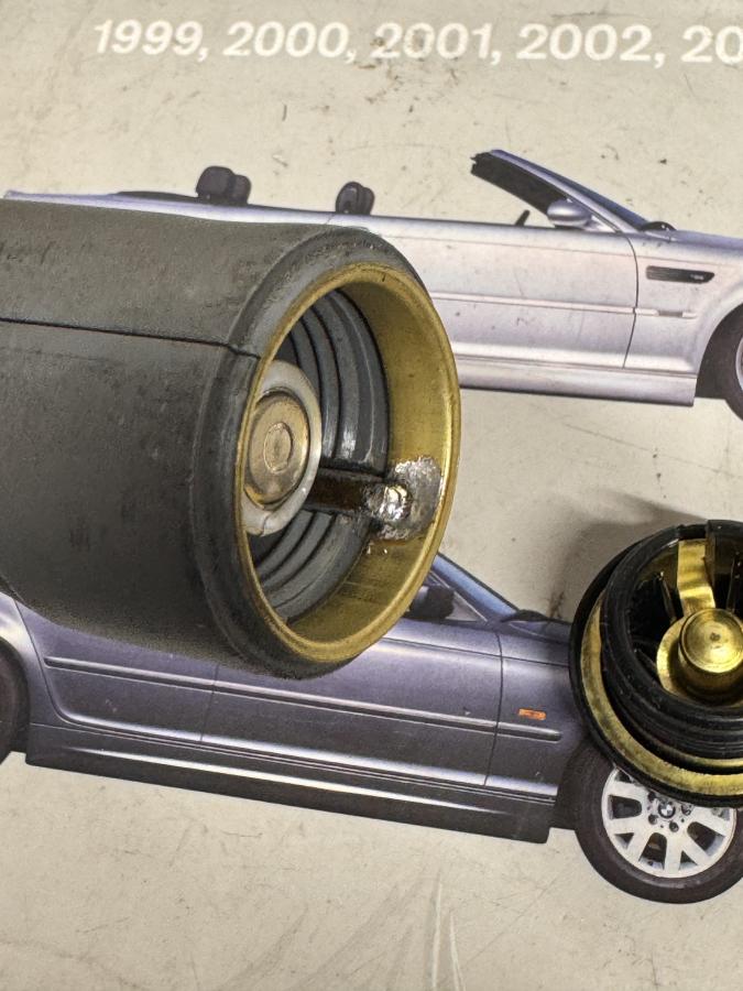

                    Thanks. Wasn't sure how the digital ones worked but that helps to clarify that. My techangle is having an issue of shutting off and turning back on which is why I'm sending it in. The $130 takes care of any minor issues. I'm pretty sure it's the spring on the battery cover but I want to be sure.
                      I know this sounds crazy, but try changing the batteries. My 3/8” was doing that and the low battery indicator wasn’t showing up on the screen. Just on a hunch I swapped out the batteries and it immediately stopped doing that.
                        I had this issue with my Techangle, it turned out the solder broke near the battery cap. A dab of solder and it's fine again. Now I avoid touching the battery cap when using it.
                        Edit to add it wasn't the cap itself, but rather the metal strip from inside the battery compartment that leads to the contact points for the cap.
                          Already tried that.
