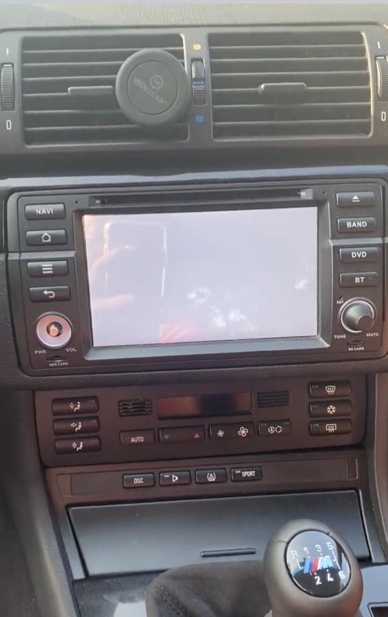

    I tried installing a brand new AVIN Avant 4 headunit recently and that install didn’t go as planned. The unit receives power once you plug in the 17-pin adapter + CANBUS module with the car (Amber backlights come on for about half a second) and quickly cut off. Radio won’t power on. I put back the stock radio and with a few tweaks ended up working with no issues.
    P.S. I replaced the amp in the trunk and verified all fuses and relays are working well so that can be ruled out.

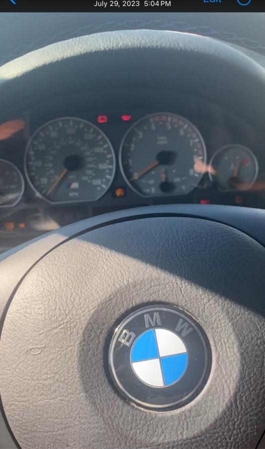

    My coolant temp gauge works but there’s no Amber backlight and if the battery is ever disconnected and reconnected, the gauge will act abnormally again (in the red). After a few drive cycles, it will return to normal.

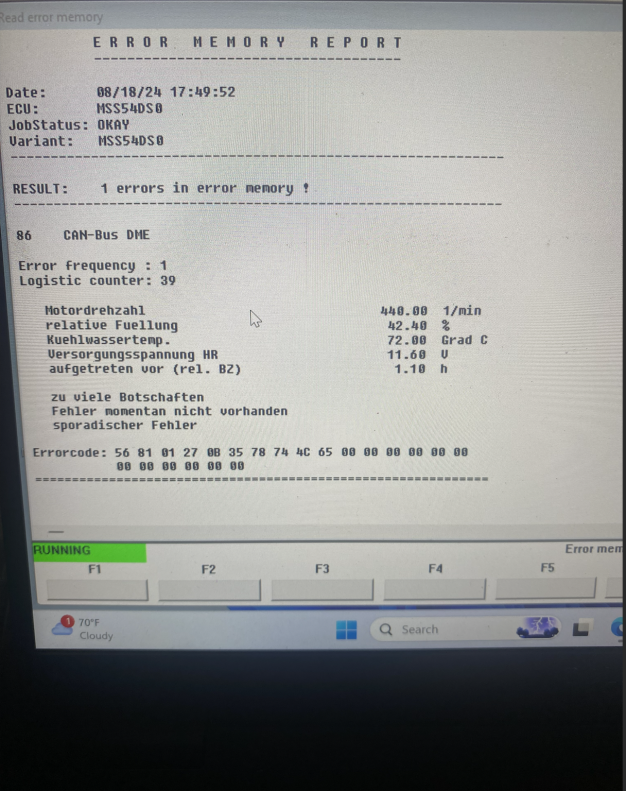

    I decided to scan for any potential codes with INPA and low and behold, a new error code showed up — Error 86: CAN-bus DME
    I tried communicating with certain parts of the car such as the instrument cluster and INPA couldn’t even connect.
    Then I took a look at the DME connectors and all seems to be ok. This leads me to believe that the transceivers for the CANBUS in the DME or any capacitors/transistors are fried.

    The error is not present (Fehler momentan nicht vorhanden) and sproadic so CAN is probably ok. Clear it and see if it comes back. There's not a huge amount of CANbus in an E46. Mainly just DSC (inc steering angle sensor) and DME I think. And there's a dedicated CANbus for an SMG. I think this is a red herring. Pretty sure the "CANbus" adapters for the steering wheel buttons aren't even CAN. Aren't they on the K-bus only?
    What was the actual problem with the old alternator? What does "frying" mean? Did it over voltage? If so, by how much? What does voltage read when engine is idling now?
    The fact you can't communicate with KOMBI is suspicious. Depends a bit on what the alternator failure mode actually was.

              14.8V is not going to kill an (nominal 12V) automotive component or "fry" them in your words. Your slang doesn't help and (again) frankly you're just guessing. Your possibilities list is unlikely based on the history provided.
              I would not replace the DME. There is little pointing to that being the problem.
              There's no CAN bus at the radio. So I'd stop looking at that.
              What does the aftermarket radio do without the interface attached on either side? Main thing it does is relay button presses to the radio and is not even needed to operate.
              Do you know if the radio works properly in another car? You should be able to power it up on a bench if you have a power supply? Even without I-bus it should still mostly operate and boot although I'm not sure if they have an accessories feed to wake them.
              Is it second hand, factory refurb or something - why is the knob missing?

                  Yes, the radio (new Avin AVANT 4) works on another car perfectly fine. I transfer it to my car, and you can tell power is being received with the amber backlights being present for a mere half a second. Then, there's nothing.

                  This is a completely different radio (Eonon headunit that was already installed when I purchased the car) than the one I mentioned (AVIN Avant 4). The AVIN is a brand new unit. The Eonon was working perfectly fine. The white screen came when the alternator and battery were acting up. That radio has never worked since. The knob is missing because those plastics are fragile. I got out of my car and accidentally hit the knob and have yet to find it lol. Not sure how that would play into this problem but yea.
