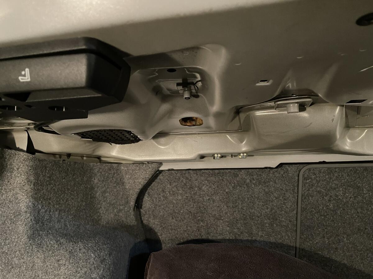

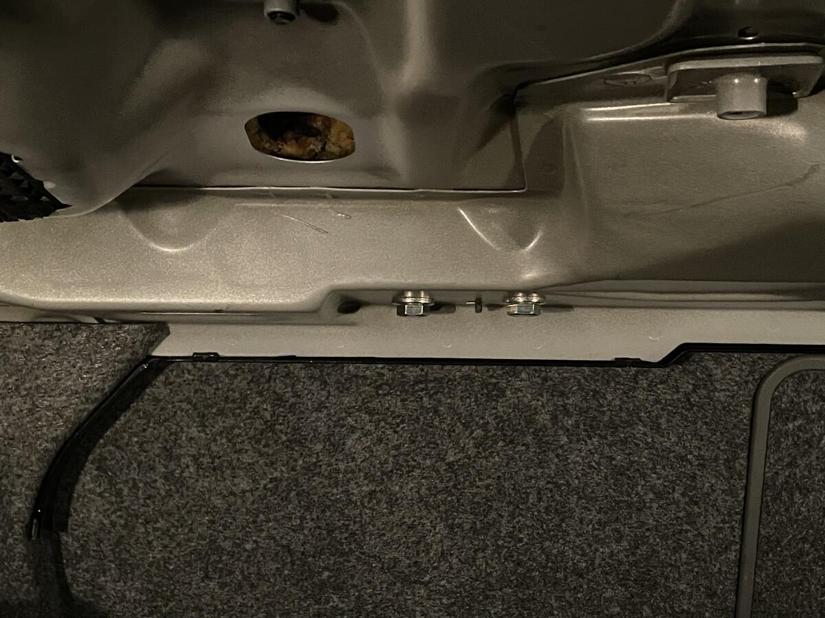

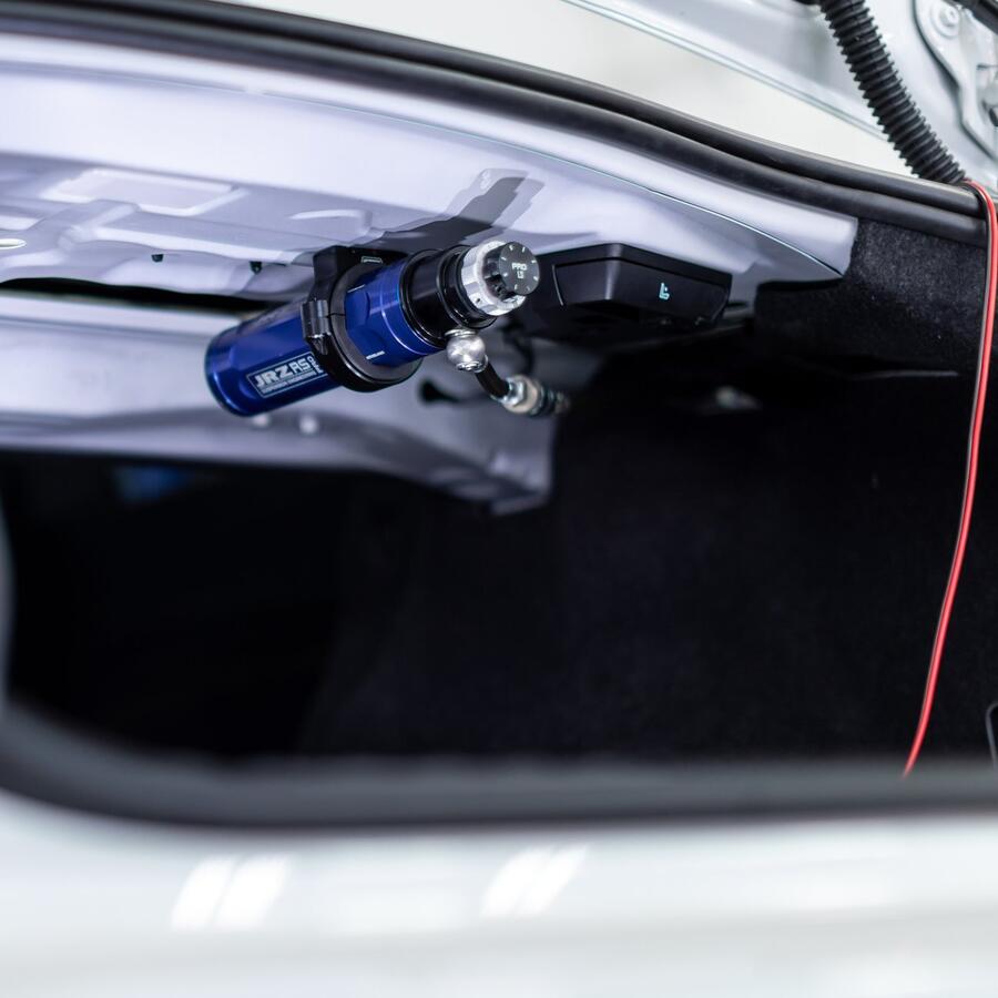

      Now for the rear I am not planning to gut anything but want the reservoirs mounted cleanly where they don't impede access or trunk space as I will be running the carpet liners. I was thinking of something like the Rennscott mount with an adapter that allows the mount to bolt the reservoir horizontally to the parcel shelf using the existing chassis mounting bolts pictured below which would allow you to route the reservoir lines up over the carpet liner which would be a super clean and discrete install. Anyone with solidworks or cad and a 3d printer willing to help out and design something? I imagine a lot of guys would be interested in a plug and play solution that is completely reversible and clean.

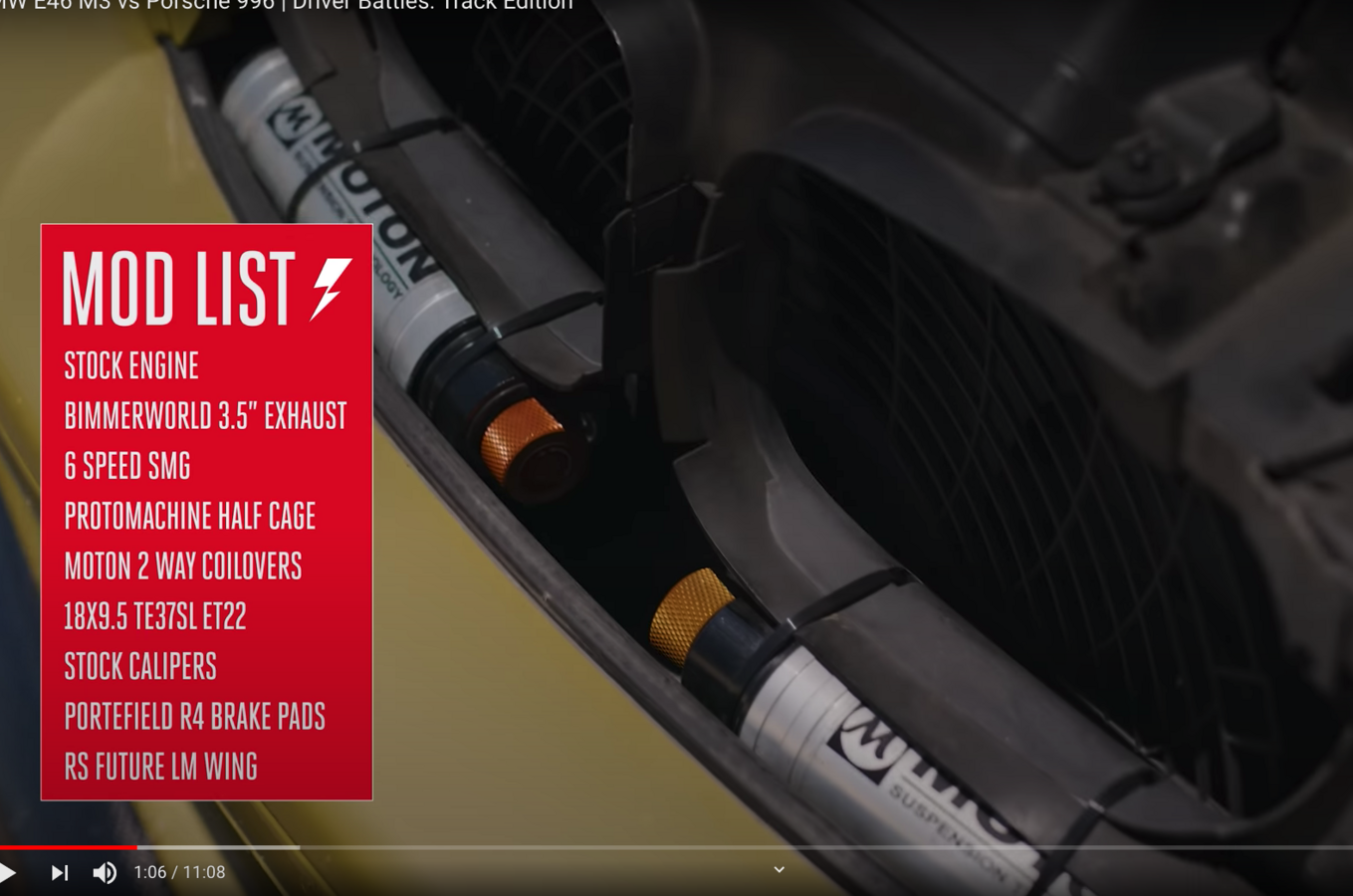

        Originally posted by bjz! View Post
        Here, an old pic of mine.
        This is pretty fuckin awesome, did you have to modify the microfilter cover for the cans?
        I can't remember for the life of me how my evosport mounted mine 15 years ago, wish I had pics.
          I'm pretty intrigued by that beauty cover intake..
            Looks like the horsepowerfreaks cover. NLA if I'm not mistaken
              Originally posted by nervous24 View Post
              I quite like that! How did you secure them in the tray?
              Once you install the filter, they stay in position, a little bit of movement, but nothing to worry about.
                yes, i cut the corners to pass the lines and then cut the filter cover to fit the cans. I have LTW cabin filter housing also.

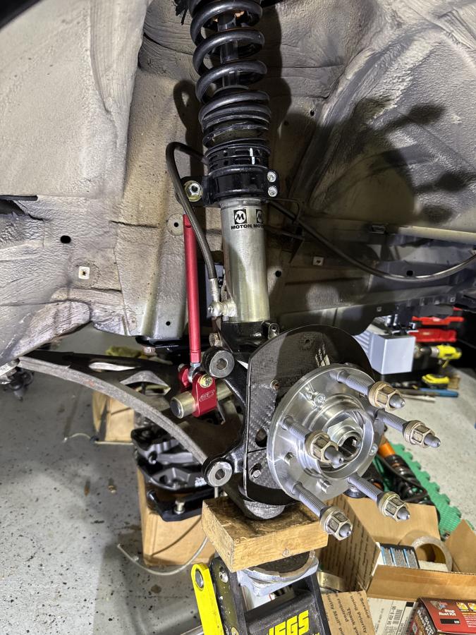

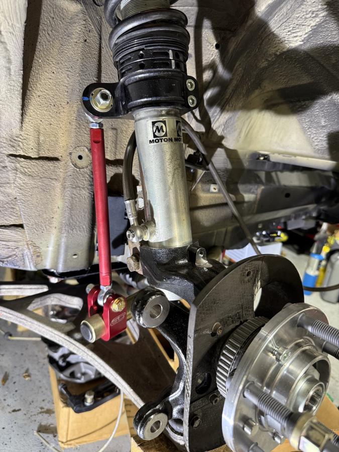

                                Here's a picture of them mocked up, if anyone has a pic they can share of how the lines look that will be great.
