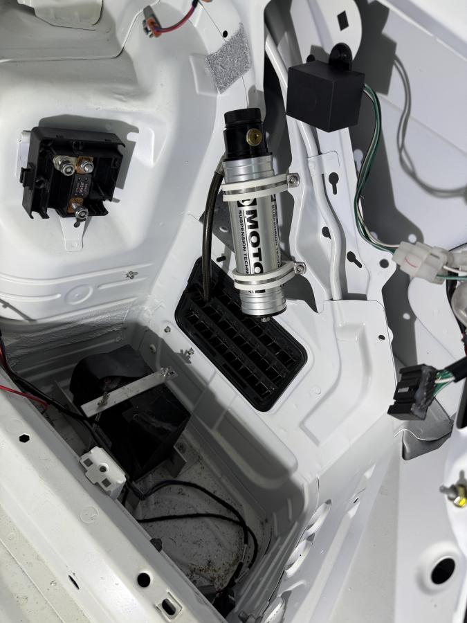

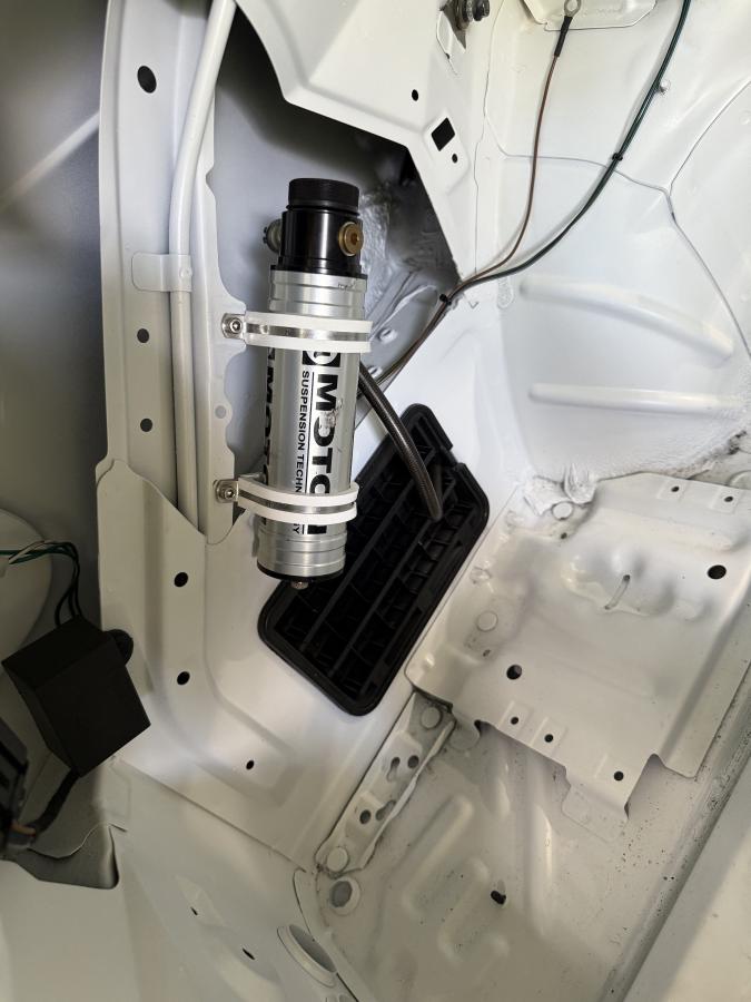

    Installed like this in one of my previous build

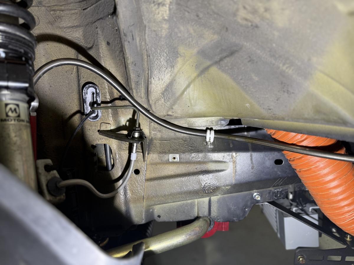

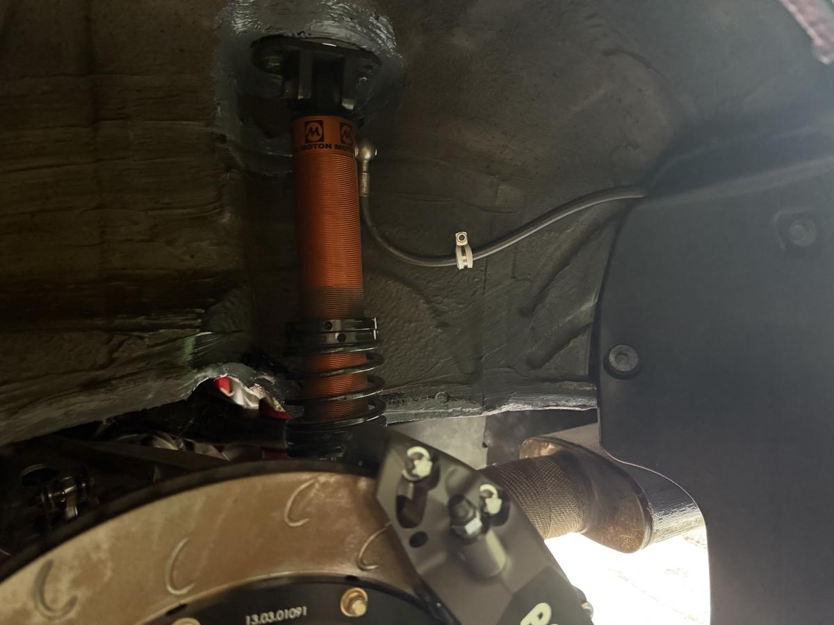

      Got any pics from the wheel well?
        #33
        No, built that car in 2019-2020.
        Depending where you mount the reservoir, you can route the hoses exactly at same spot where the rigid brake lines goes through the rubber grommets.
        Or if you mount reservoirs closer to rad support, hoses can pass from wheel wells to engine bay where chassis/sheet metal ends and hose next to intake tube and windshield washer reservoir neck
          #34
          When mounting on the exhaust side may want to consider a heat shield of some sort. Whole purpose of the external reservoir is for more fluid capacity to improve the thermal capacity of fluid in the damper.

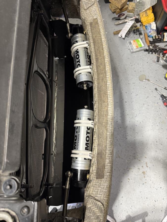

            Can anyone share how they routed the front lines through the wheel wheel and fender to keep everything out of the way and secure? I'm thinking about putting the canisters on the front of the radiator support, should be able to reach with the hood open to turn the knob.
            I did the same, but it's honestly not all that convenient and somewhat difficult to reach the adjusters. Though I does look pretty slick with them peaking out
              #36
              Some pics for reference. Yes I did mount the fronts behind the kevlar support, it's a DE car - if the impact pushes them into the radiator support it's the least of my problems. The moton hoses don't reach as far as some of the other remote cans do, mounting them to the headlights is the other option but I didn't want to fabricate mounts and remove the airbox feeding from the grill. Easy to reach in and change the compression, as well as get the chuck on to air them up. All of the wheel well liners fit over the lines.

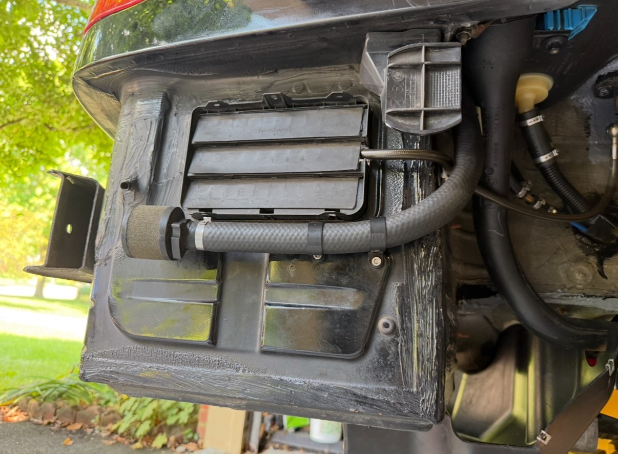

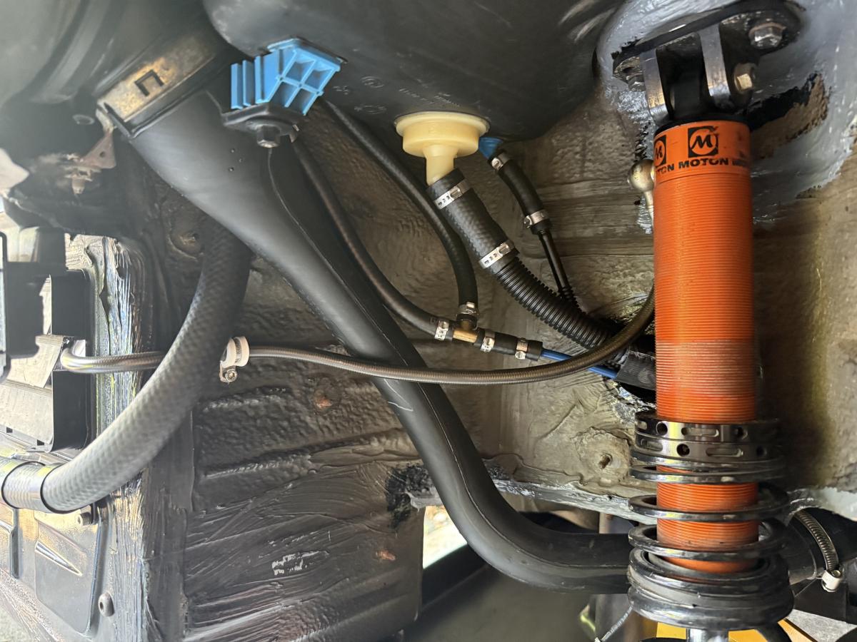

                        Off topic, CrookedCommie one of your pics show you did an EVAP delete. I see the vent hose from the "slosh canister" heading to the rear of vehicle. Where does it end? Why not in the wheel well where the OEM one does? Is that a one inch hose? Looks bigger than OEM vent. And of course you have a filter on the termination.
                          #42
                          I got the size of hose that will fit the OEM expansion tank fitting, I can't remember what size ID maybe 5/8"? It does terminate with a filter I grabbed off pegasus racing to vent to atmosphere. I guess I could have left it to vent in the wheel well but I figured the further away from the tire, fuel lines, and remote canister lines the better?
                          From pegasus :
                          ITG 16mm ID Engine Crankcase Breather
                          16mm (5/8 inch) Pegasus Pro Design Aluminum Hose Joiner​
