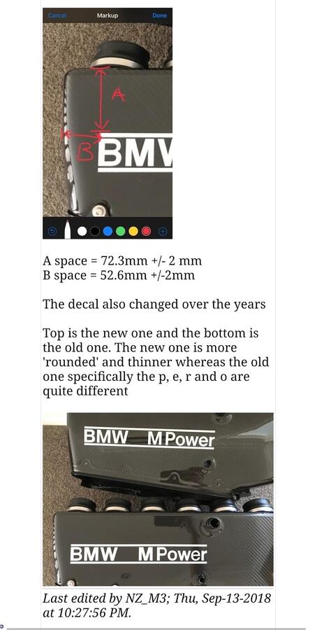

    I had no luck using MrGizmo's DIY to try to revive the old M3Forum post (link below). The forum post showed exactly how to line up and place the BMW MPower Logo on the airbox.
    http://www.m3forum.net/m3forum/showt...p?p=1067945900
    Does anyone have old screenshots of said post, or can lead me in the right direction to get that information?
    Any help would be much appreciated as I am in my final stages of installing my karbonius airbox.
    Interested in this info as well, about to complete mnie streamline airbox install as well.
      Can't access the archived page anymore, but fortunately I took a screenshot of it last week.
      EDIT: Found an archived version of the thread, but really all the important information is in the screenshot.

      Click image for larger version  Name:	Screenshot_20200309-204708_Chrome Beta.jpg Views:	0 Size:	55.2 KB ID:	2838

        Cool Thanks 👍

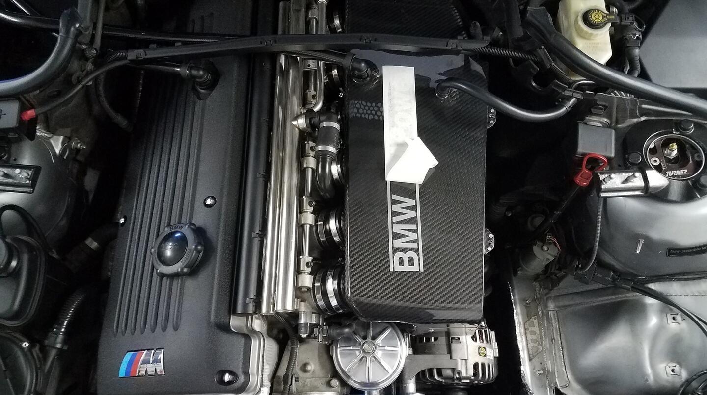

          Click image for larger version  Name:	20171123_105125.jpg Views:	0 Size:	172.6 KB ID:	3003I'll add that I found it best to make two measurement "As." One like in the photo, but also another at the end of the sticker (under the hvac) so as to keep a straight line.

            Thanks for the info! Now I have the sticker and measurements, only need the airbox. 😂
              http://webcache.googleusercontent.co...&ct=clnk&gl=us
              You sir are a life saver!
