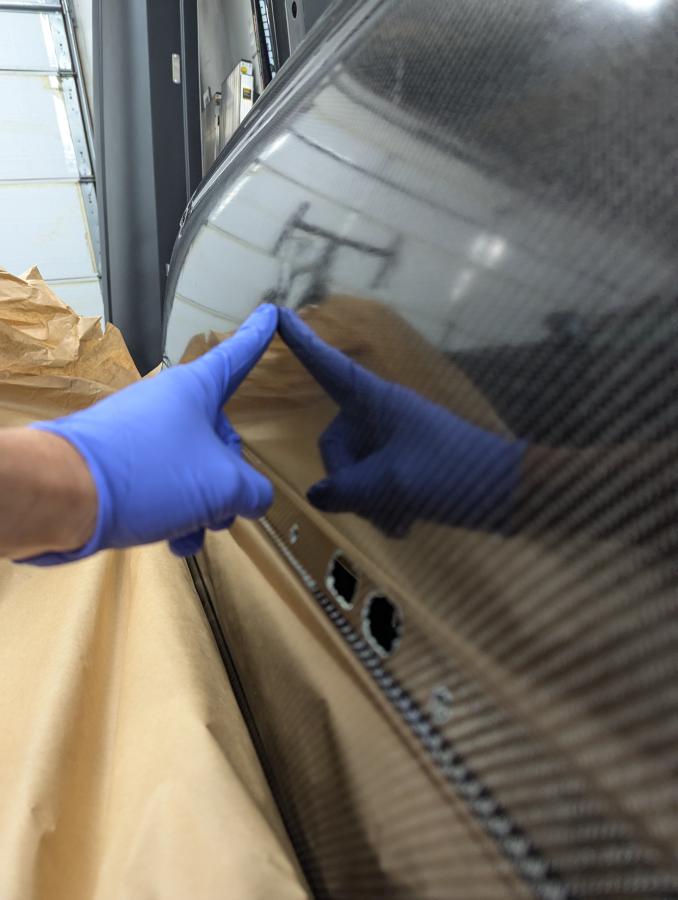

    Click image for larger version  Name:	PXL_20240917_052135746.jpg Views:	0 Size:	54.6 KB ID:	278938
    there are small imperfections on the outer skin of the doors. the doors were created using a mold that was made from a (understandably) used door so the imperfections have been transferred over. my door has a small ding in it (what i'm pointing at with my finger) and from some angles you can see some patches of waviness. the door in the previous thread also had a door ding that looked worse than mine. seems like they made some repairs to their mold but the end product is still not perfect.
    because of this, i don't think there's any reason you'd want to order these doors with the clearcoat option. if you're going to paint the door body color you're going to have to sand off that clearcoat anyways to properly prep/level the surface. if you plan on keeping the the weave exposed i suspect you'll still see the imperfections . . . unless the clearcoat is thick enough to hide it? maybe our resident cf expert bigjae46 can chime in on that

          Any imperfection on the plug to make the mold will transfer over to the final part. Ideally, the original part would be sanded, blocked and primed smooth. I’ve seen many of these doors come gel coated because no one is going to use a new door…hence the $1900 price.
          Not an expert on paint but that ding is going to be impossible to remove with just clear coat. If the intention is to expose the CF…you’re kind of stuck
