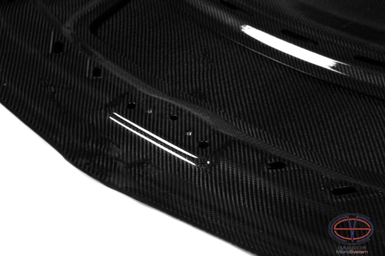

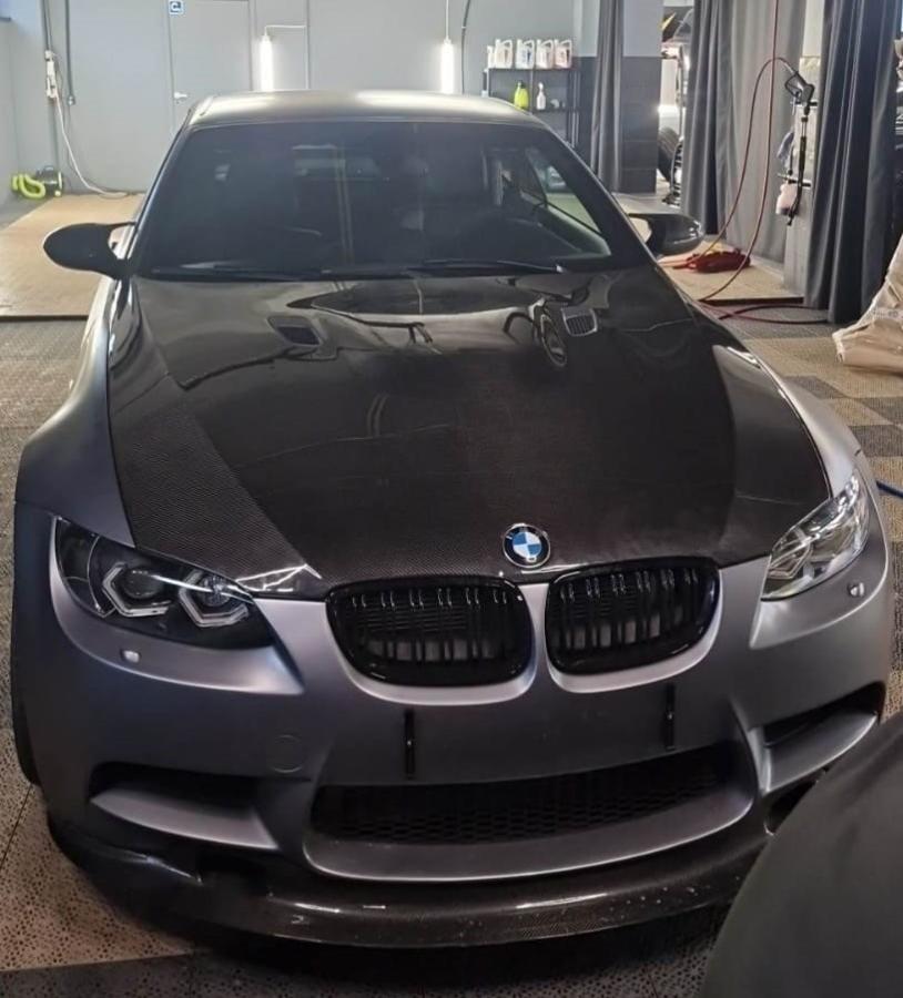

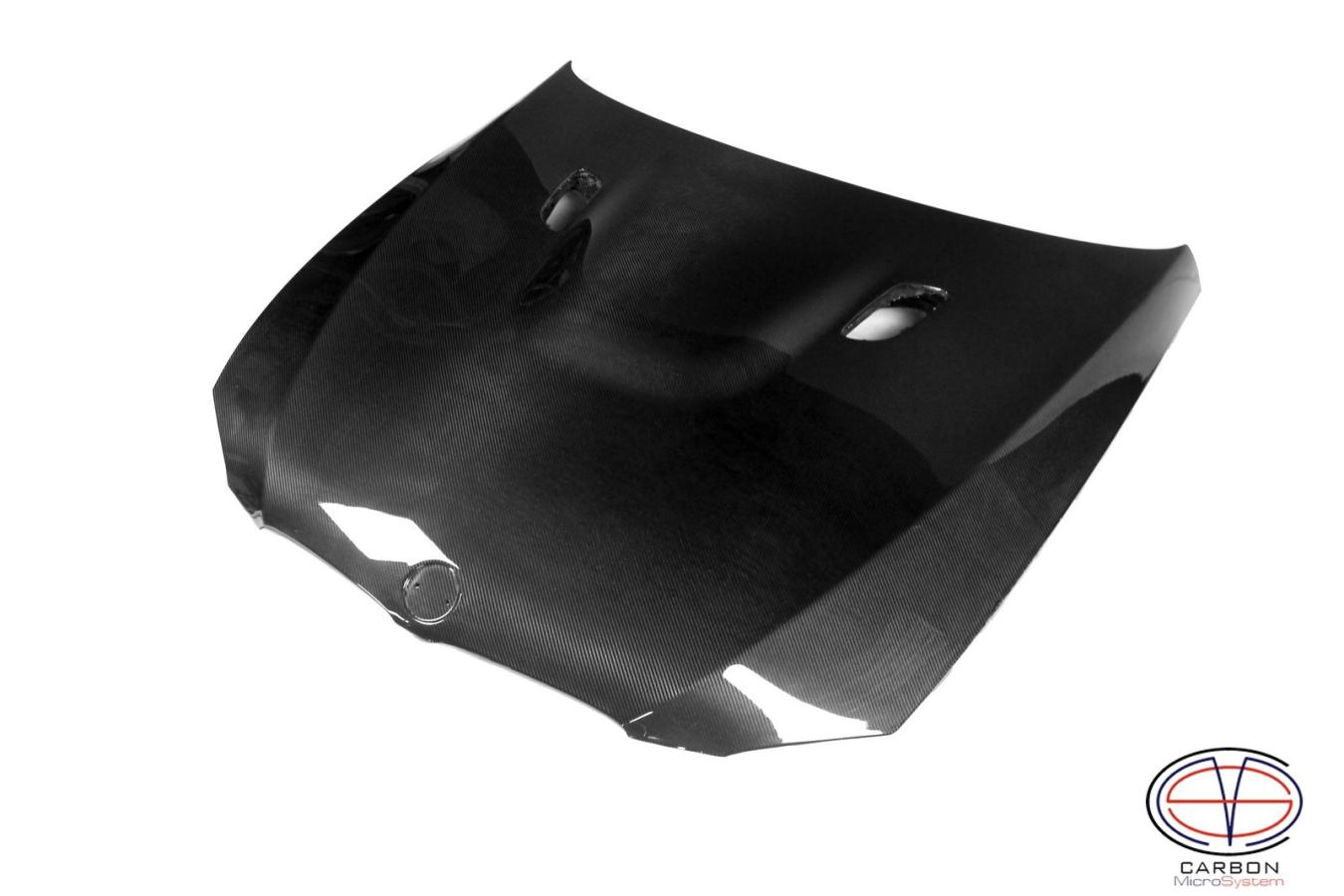

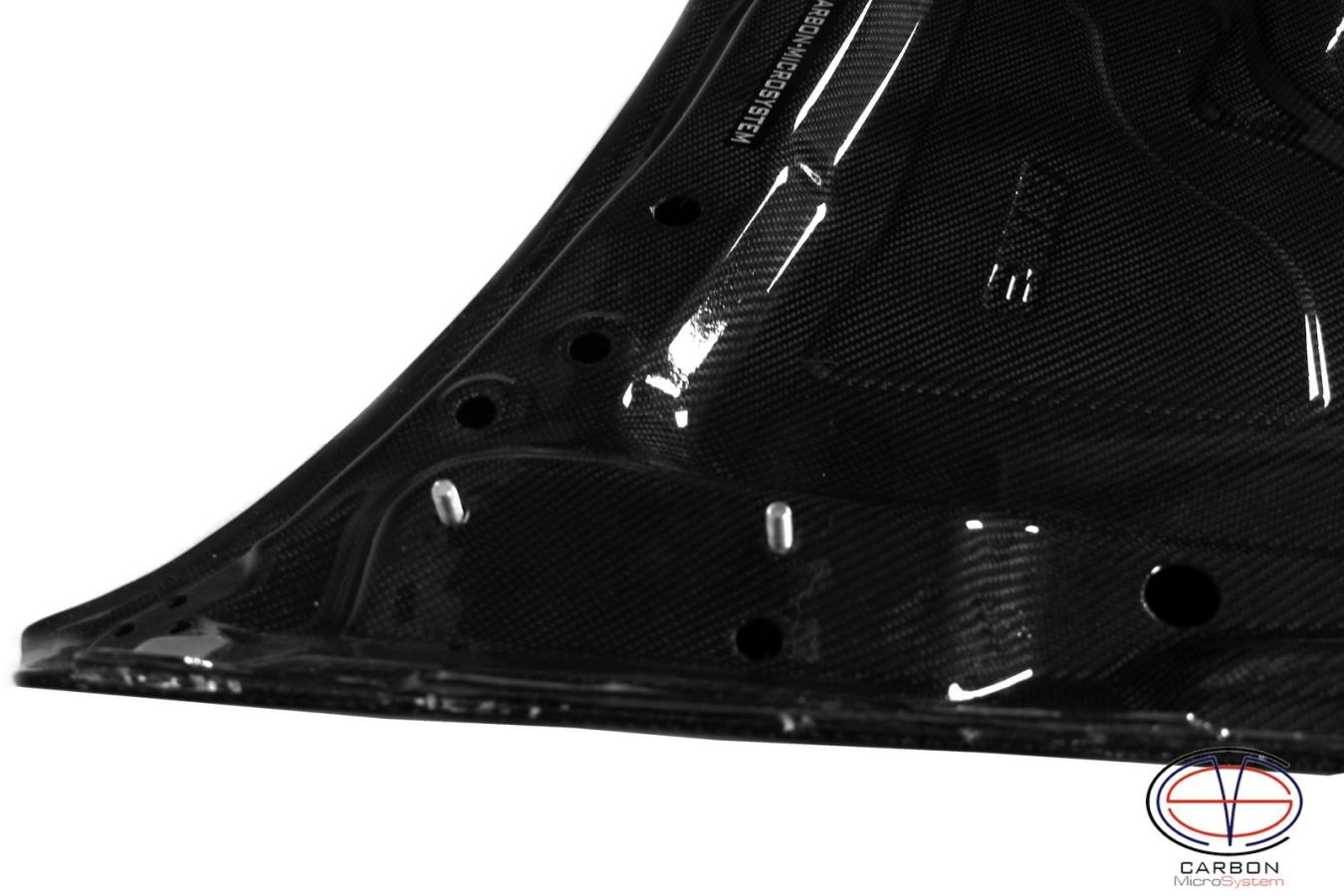

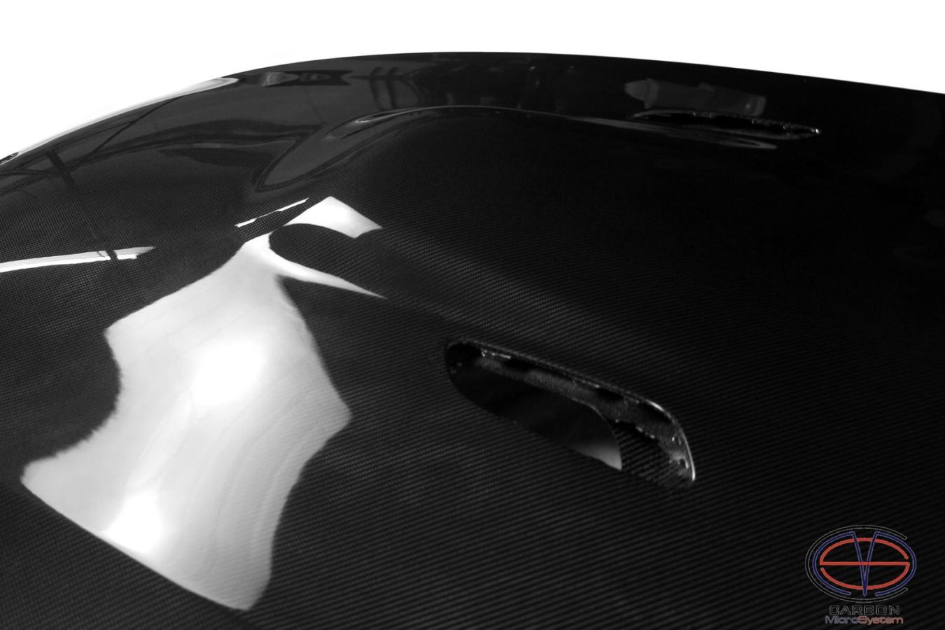

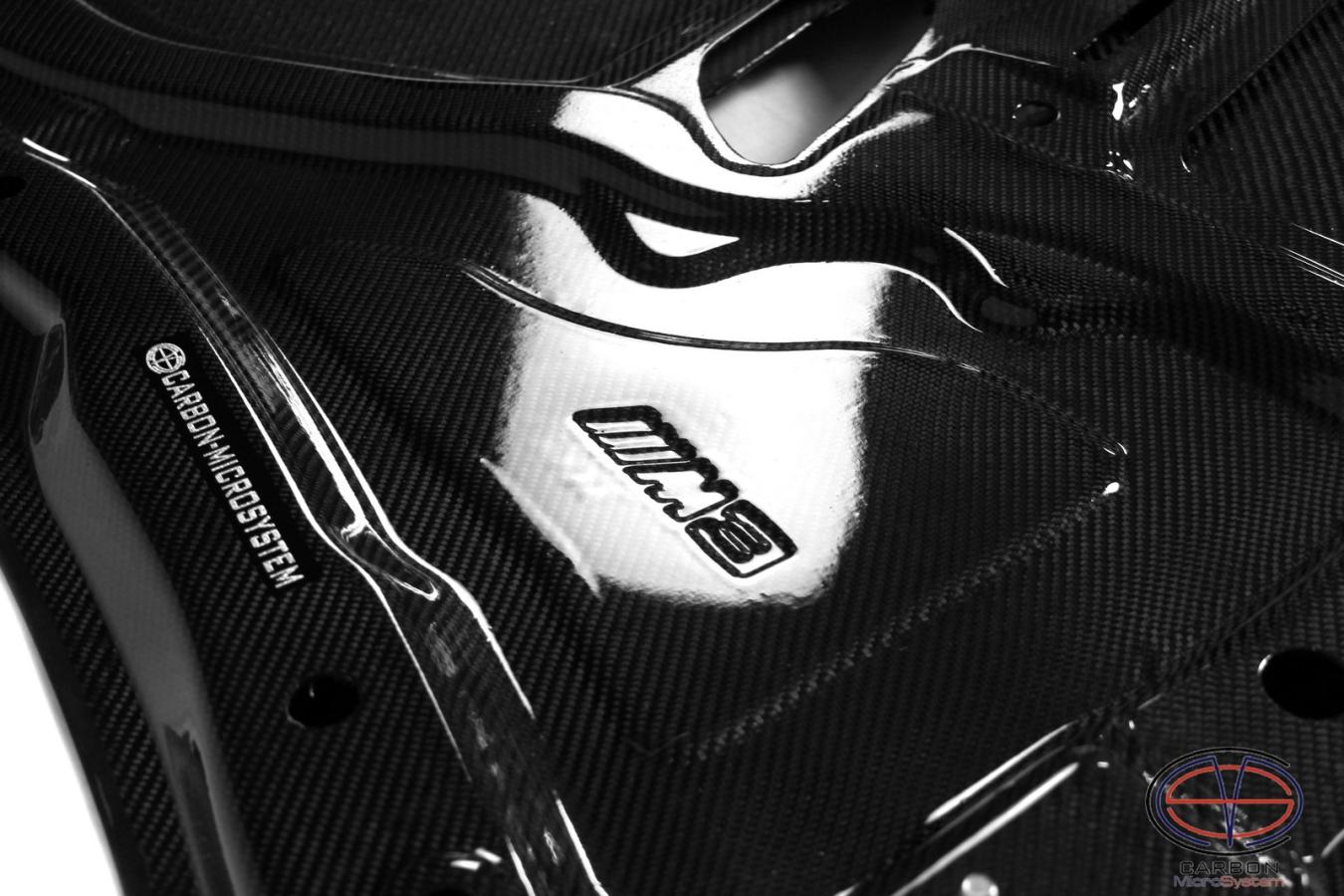

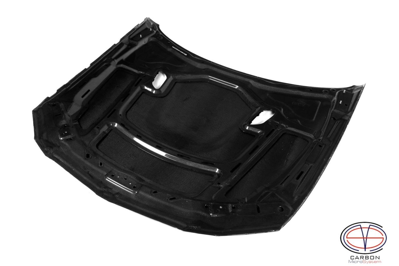

        If there is interest and three or more customers will come together for a carbon fiber hood for the e46, then we can do it.
        The hood will be completely carbon with reinforcement of all important places so that it can be used with the original fasteners and hood lock.
        Here is an example of the hood that we make for the e92.​

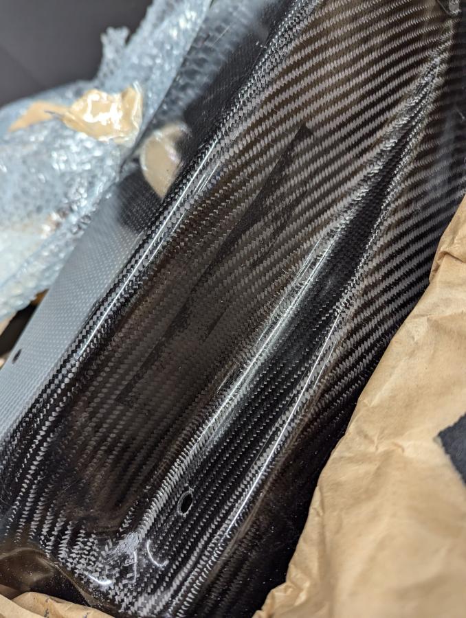

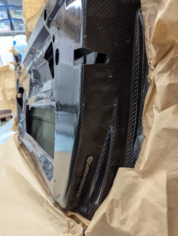

              apologies for the lack of updates as i formulate a plan on getting these doors DIY installed. aiming to clear some time in the next couple of weeks to get started on this project.
              in the meantime, i was able to remove the logo from the side of the doors. the instructions provided by Carbon Microsystem worked as exactly as described

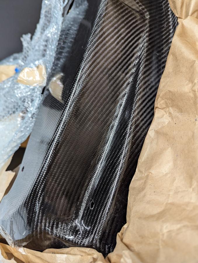

              they recommend sanding with 240 grit to remove the label. i had 220 grit laying around so carefully sanded by hand. moderate to hard pressure was enough to get the label off and while not damaging the carbon underneath

              one small hurdle cleared! cleaning, sanding, and cleaning the entire inner door skin should be adequate to ready it for clearcoat

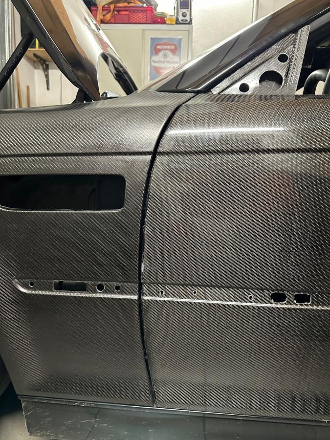

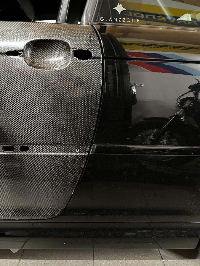

                  I'll add more photos of our doors.
                  Click image for larger version  Name:	IMG-20241127-WA0146.jpg Views:	138 Size:	121.9 KB ID:	285513
                  Click image for larger version  Name:	IMG-20241127-WA0147.jpg Views:	140 Size:	164.6 KB ID:	285514

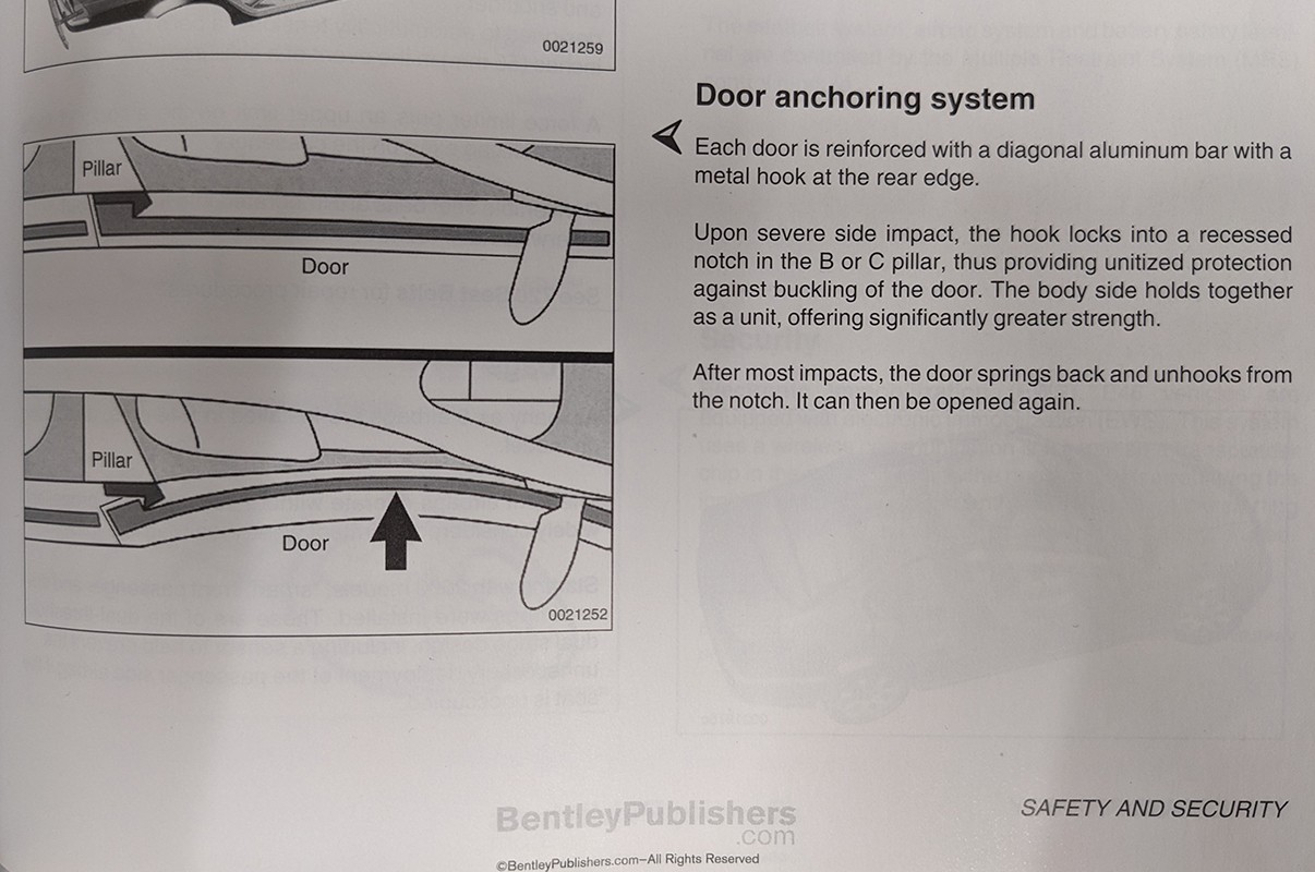

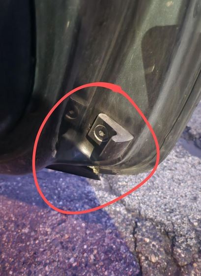

                    i'll leave this thread with some information i dug up on on how the crash bar works
                    it seems like the door itself does not do much in terms of protection in an accident. the crash bar however, is designed to hook onto the B pillar (or C pillar in a 4door) to prevent intrusion into the vehicle.
                    Click image for larger version  Name:	PXL_20241202_073254650.jpg Views:	0 Size:	176.5 KB ID:	286314
                    Click image for larger version  Name:	Capture.jpg Views:	0 Size:	54.7 KB ID:	286315
                    this is the hook, it bolts directly to the crash bar inside the door, the door simply acts as a placement spot for it to work properly in a crash since the hook will dig into a pocket/indentation in the B/C pillar
                    i'm a little surprised that flimsy looking crash bar is designed to actually hold anything back, but obviously bmw engineers think (and know) different.
                    i would definitely run the crash bar in a street driven car

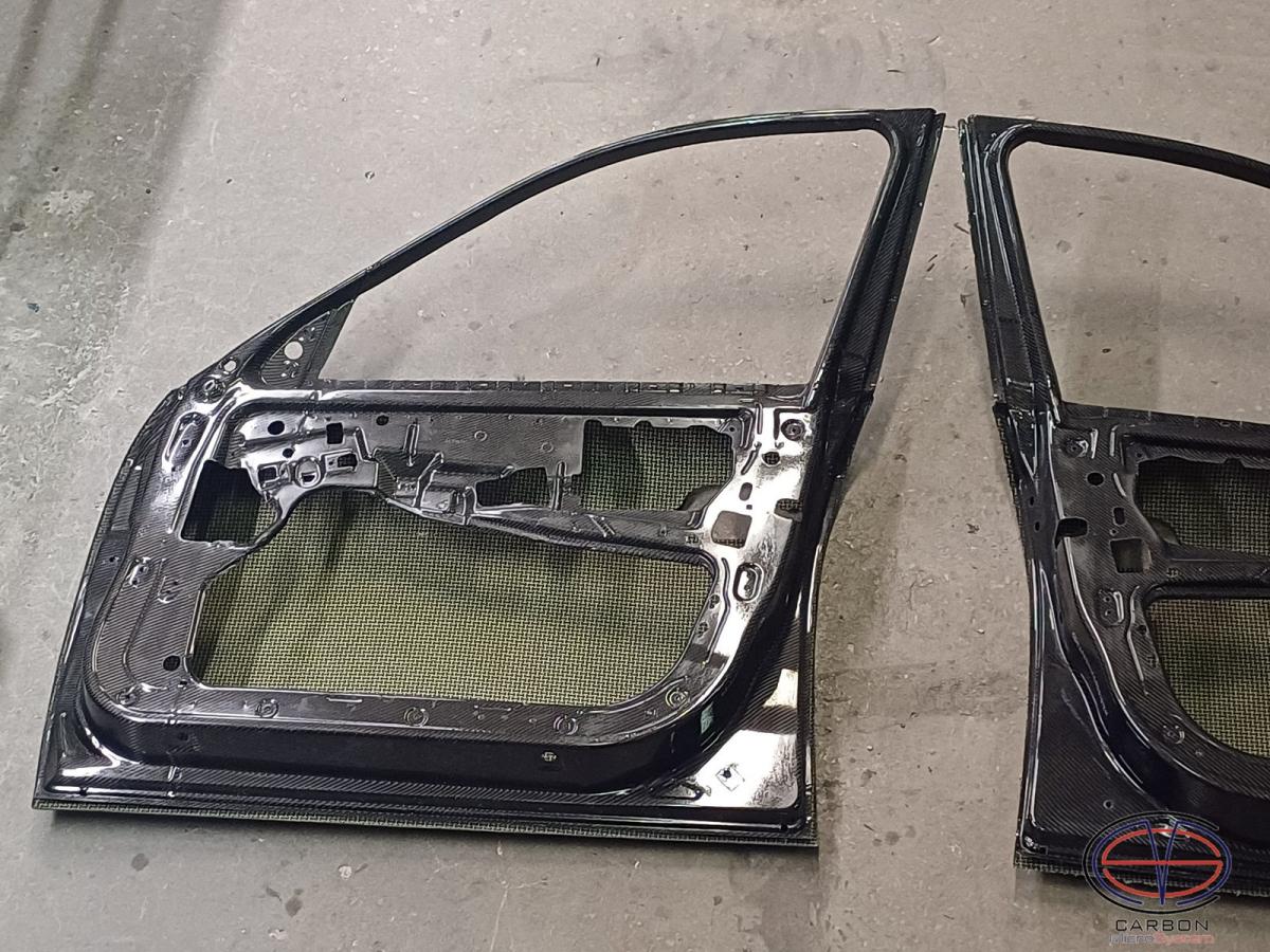

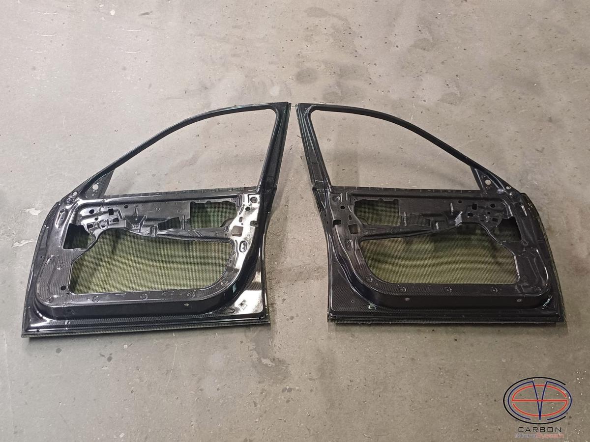

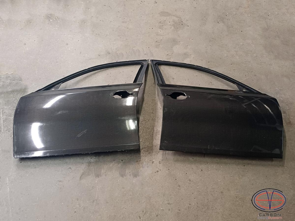

                            We made front doors with glass frame on the E60
