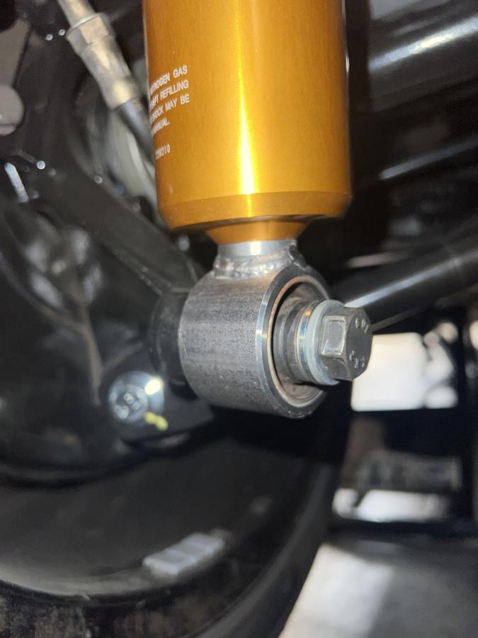

    1. The lower mounting bolt doesn't have enough length to completely go through the knuckle. Anyone else notice this with Ohlins? Looks like new longer bolts are required.
    Other option is to not use a bolt washer, but then the bolt would dig into the shock's spacer/sleeve. The bolt is about 2mm short of the making it out of the threaded hole on the other end.

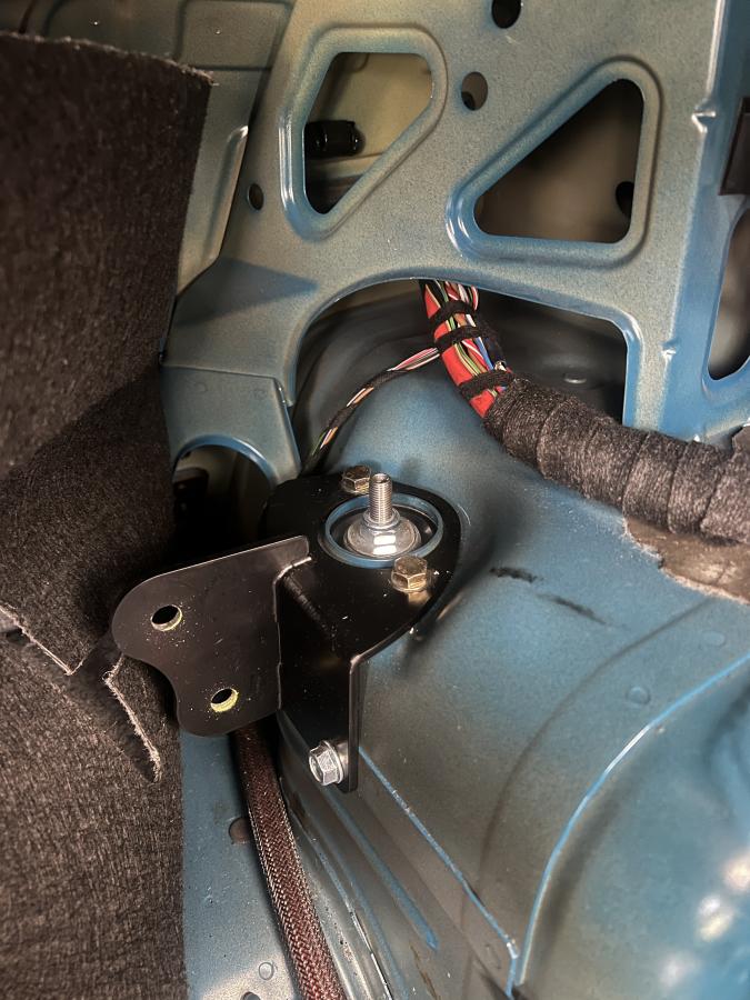

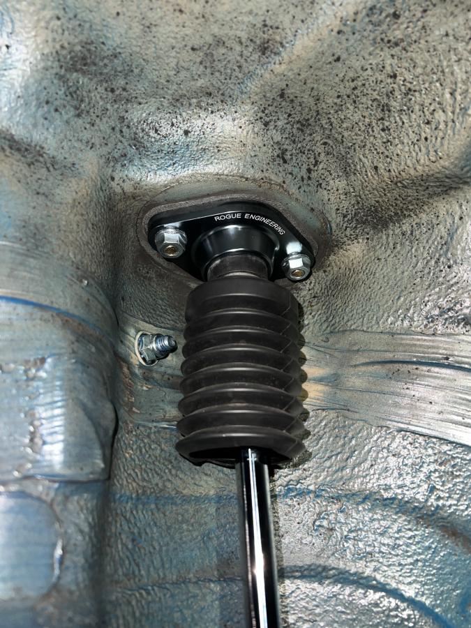

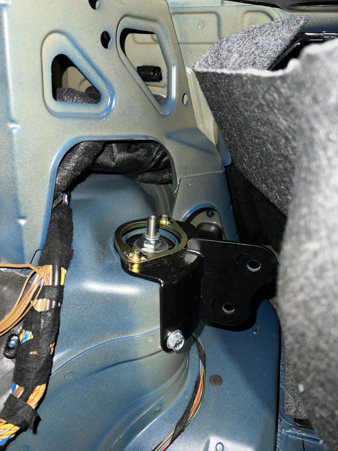

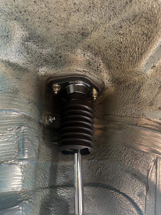

    2. Not ohlins related issue, but rear shock mounts with an x-brace. The studs on the RSM(I used Rogue Eng) don't extend far enough for the nuts.
    Because the X-brace acts as a reinforcement plate I can ditch the the Rogue stud plate, and use bolts and nuts. This would require a helper to hold one end, otherwise does anyone see any issue with this?

      On my last m3 the bolt didn’t go all the way through either for my ohlins

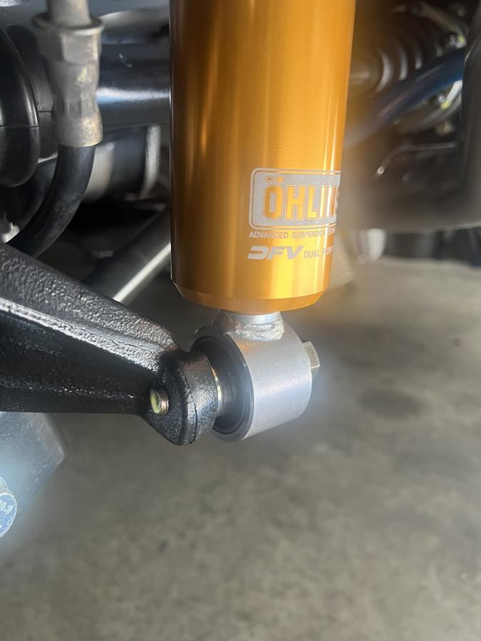

                      FWIW here are my results with the new fasteners. Much better.

                        The thickness of the mounting point is much greater than the bolt's diameter. You don't NEED it sticking through, flush is fine (there's no collar to capture extra threads like in a "lock nut" type of situation).
                        Looks like OP has 2 washers or an unneccesarily thick washer. I would have removed one washer (or use some other hardened washer that's not so thick, and re-use stock hardware)
                          Ideally you want 3 threads passed the nut. You can get a bolt from McMaster to the length you need.
                          This isn't a lock nut (collar, castle, nyloc, pinch). Rule of thumb is engagement depth be equal to shaft diameter.
                            Thanks for the input. There's something that irked me about having a bolt responsible for that much tensile strength not fully threading through the hole.
                            To clarify, in the first pic you're seeing the stock bolt with washer, then the spacers for the shock itself.
                            🔹 2001 M3 Laguna Seca Blue
                            Instagram: link
                            Build thread: link
                              Agreed, but the knuckle is threaded, you still want the bolt to pass through to ensure you spread load on all threads on the knuckle.
