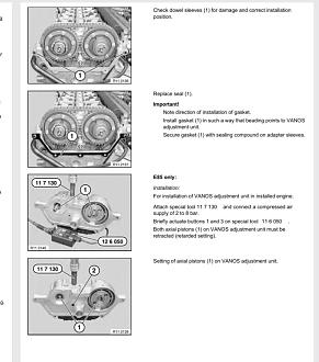

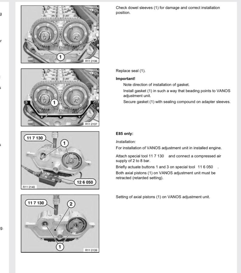

        The idea of video was to share the way I found to do it specifically on e85 Z4 M without the 2 above BMW specialty tools & be 100% sure the pistons are bottomed out where they should be, since you can’t put vanos/splined shafts in together on that car. I did it with 1 or 2 of the bolts completely tight on the hubs, which held the splined shafts in place & in turn the pushed the pistons back till they were past where the caps stopped them.
        But honestly I realized in the process it doesn’t matter how you do it, as long as the bridge goes through the cams / the crank is at TDC & the vanos pistons are completely bottomed out. Thats all that matters for timing to be correct. You could argue if a “sweet spot” matters or not, but to me it seemed every few teeth was a sweet spot.
