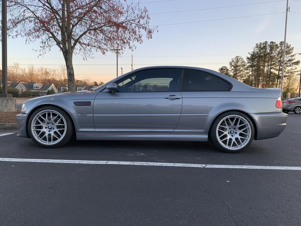

                My RAC RG-4's are 19x9 +37 in the front. 245/35/19 fits great in the front. No rubbing and no rolled fenders (@ 13.5" ride height). I suspect 255 would be okay, but I have not tried it.

                  Got a pic?

                    Found this old one. She is up on the quickjacks right now getting TCK DA's, so I cannot get any other angles right now.

                      So those are CSL reps? Look pretty awesome
