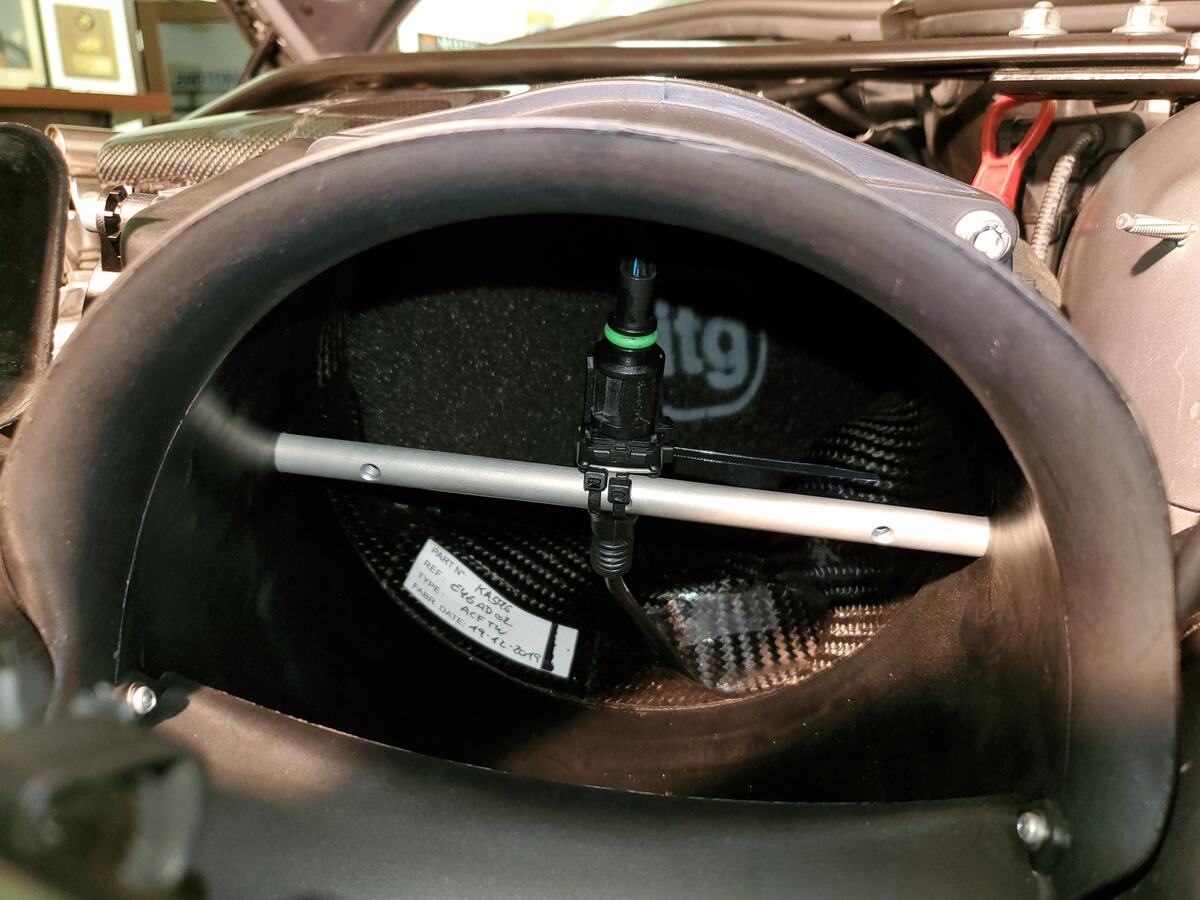

    So I couldn't help but notice that the IAT is even closer to the enigne with the CSL airbox than it was with the stock box.
    For those of you with a CSL box and a relocated sensor, where are you mounting them? Also what are you using to plug the hole in the airbox for the IAT?
    I did this last night just because, but this is not a permanent solution, especially if I wire the flap which I plan on doing. Also the sensor sitting there probably "dirtys up" the air flow to the intakes. I was thinking down towards the bottom of the snorkel would be a good spot if I can make it look nice.

    The standard position in front of the intake works perfectly fine. It's kept protected behind the filter. Having it in the unfiltered section, like Streamline has, could eventually damage the sensor with the amount of rocks and debris that get caught at the back end of the filter. The E36 Beru sensor that Evolve uses seems to be better suited for mounting outside the filtered section.

    I'd just use the OE sensor in its designed location since you already have it.
      So heat soak may or may not be such a big deal? I was lead to believe timing will indeed be pulled once the engine is at operating temp.
        Reading between 10-15f above ambient at speed. No snorkel for now. Do have those scoops behind the grills and Eventuri bumper scoop. IAT is in the red section. Constantly reading temps through the app.

                What makes you think the sensor is heat soaking? Mine is in the stock location, and it stays within 2-3 degrees of ambient when I'm in motion. When I'm not in motion it goes up, but that's because the actually intake temps are going up...

                  I don't know to a certainty as I have not looked at the data from my vehicle. Just from reading here and there I have seen relocating is done for that reason.
                  I put the sensor back where it belongs and ordered a Beru sensor that looks like its better suited for relocation as Slideways noted.
                  I'll check the numbers stock/relocated when I get it and report back.

                    Normally stock airbox owners need to relocate the sensor— not csl.
                      But with the CSL box your IAT is 2" from the oil filter housing, whereas the stock box has is much further away from the engine.
                        The MAF sensor itself (which measures IATs) heat soaks on the stock box. The IAT sensor used on the CSL box does not. It’s a sensor issue, not a location issue.
                          You need to place ur iat sensor in your intake tract. The closer it is to your intake charge without heat soaking it the better as it will help make ur fueling consistent. Too cold and the ecu dumps a bunsh of fuel and it runs rich. Too hot and it runs lean and it's a sad day.

                            I drilled a hole in the intake piping (behind the one hole CSL bumper - a little upstream out of site). It's calcing the cold air from down low
                              Mine heatsoaks pretty badly.
