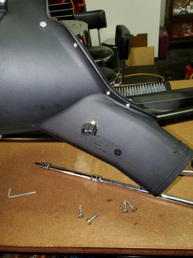

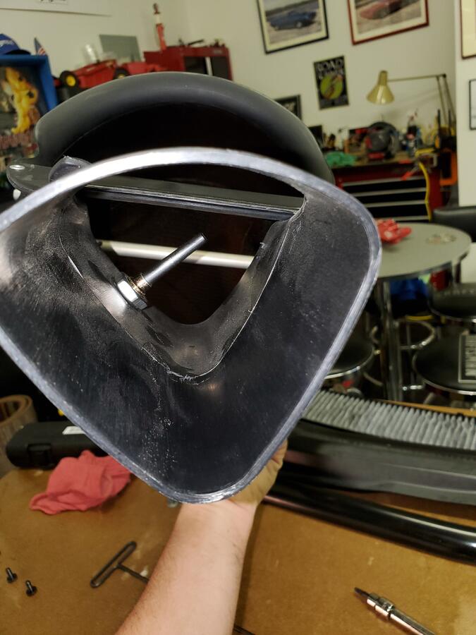

                  Just moved mine tonight and switched to US Spec. Scaling to account for the different sensor.

                    Good idea. Think I will be doing the same.
                    Budget CSL MAP Conversion
                      Similar to Cubieman's location above but in my Karbonius snorkel. Works good except the wire seems to wire harness I got is just long enough to reach the ECU.

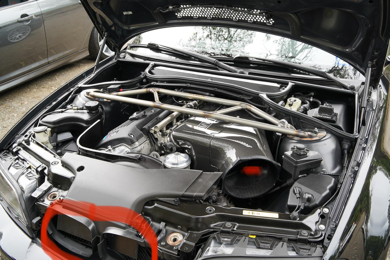

                          Like I mention earlier I have those scoops behind the kidney grills and the Eventuri scoop on the bumper. No snorkel and still at 10-15f over ambient temp. I would still design a heat shield that blocks some of the hot air between the engine and mouth of the airbox.
                            What kidney scoops are you referring to? In your pic your kidney area looks stock am I missing something? Also, do you think the eventuri scoop does a substantially better job than the ducting that was there to feed the original airbox? Would consider one like it I could get it in normal-cost plastic separately from the rest of their intake kit
                              Before putting mine on the dyno I use their fans to see if I could feel the air coming through. Surprisingly you could feel the air through both scoops. I think both scoops are useful if you don’t have a Snorkel. The oem design basically just sits there and yes it might redirect some air but not as much as the Eventuri. Eventuri sell the scoop by itself but it’s expensive. Just keep an eye out for a use one. Or try to fabricate one. (I think I saw some on eBay but they are not pretty) (I got the scoops behind the grills on eBay but there’s other vendors)
                                Ahh I see. Cool! I'll try and pick up a set of ebay scoops and see if it helps. Definitely not paying $200+ for the eventuri piece, at that point I'd rather just put the money towards upgrading to a karb box with a snorkel
