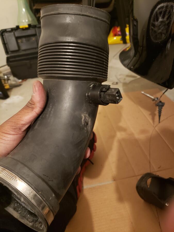

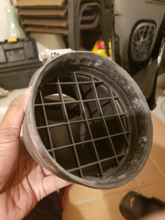

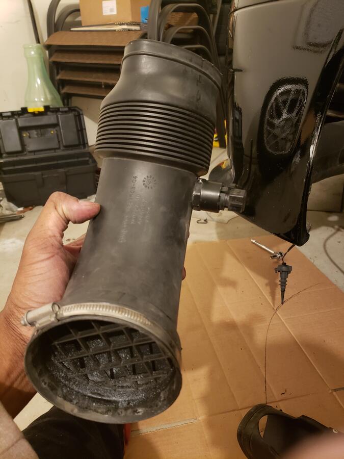

        Oh my... you really drilled into the flap? Lol
          #34
          Here is mine... drilled upstream into the charge pipe. My temps are 2 degrees above outside temps.
            Very nice! Where did you source that IAT female connector fitting that I assume is glued on?
              #36
              Looks good. I would still go with the Generic sensor though like Cubieman. I feel like the CSL sensor is prone to more damage if it’s before the filter. (That’s how it is on my streamline airbox and I can already see a few bugs/debris on the filter)
                The sensor clips into the threaded coupler... and the coupler screws into the charge pipe. No glue involved.
                  #38
                  Mines has been in this spot for 70k miles... looks perfect
