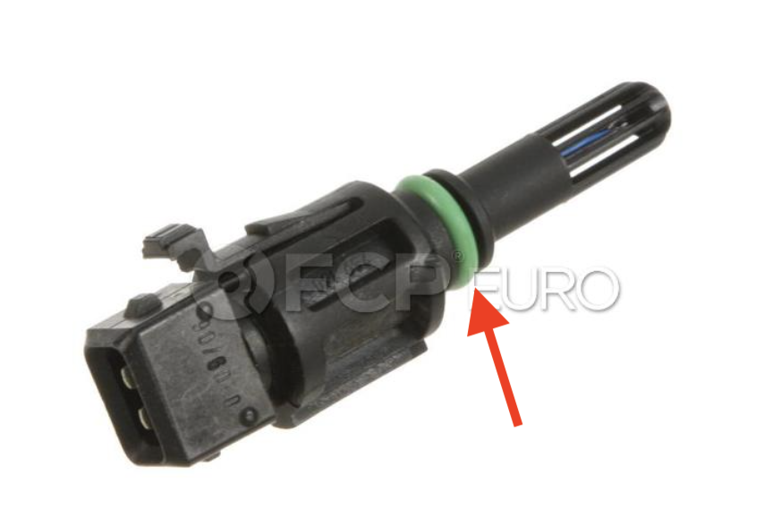

      I'm not entirely sure a blind plug will work. The port has a slit in it and the actual sealing happens with an o ring further in. Pic for reference:
Name:	Screen Shot 2022-10-07 at 3.41.20 PM.png
      Plus, that part of the airbox isn't seeing a vacuum continuously, so I wouldn't trust that the plug won't fall out. You'll likely need to use a cap like shown above or a spare sensor. Could maybe even 3D print/machine something that clips in using the same mechanism and has an o ring at the end for sealing.

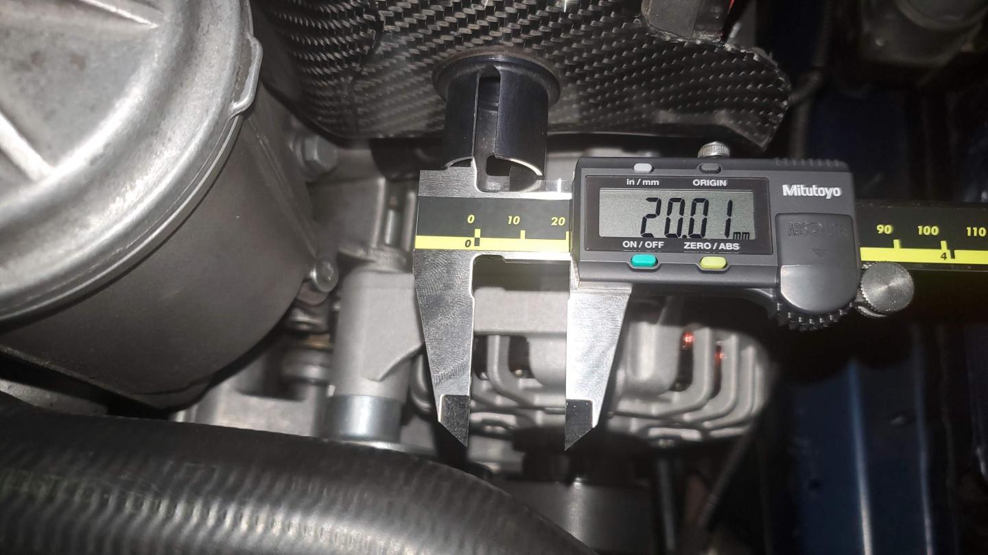

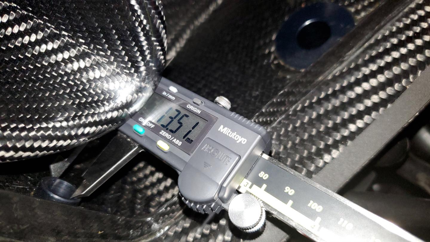

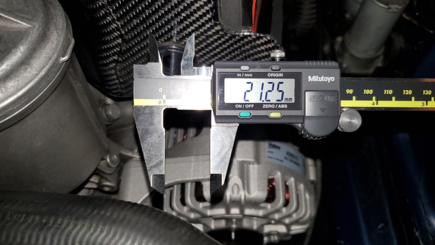

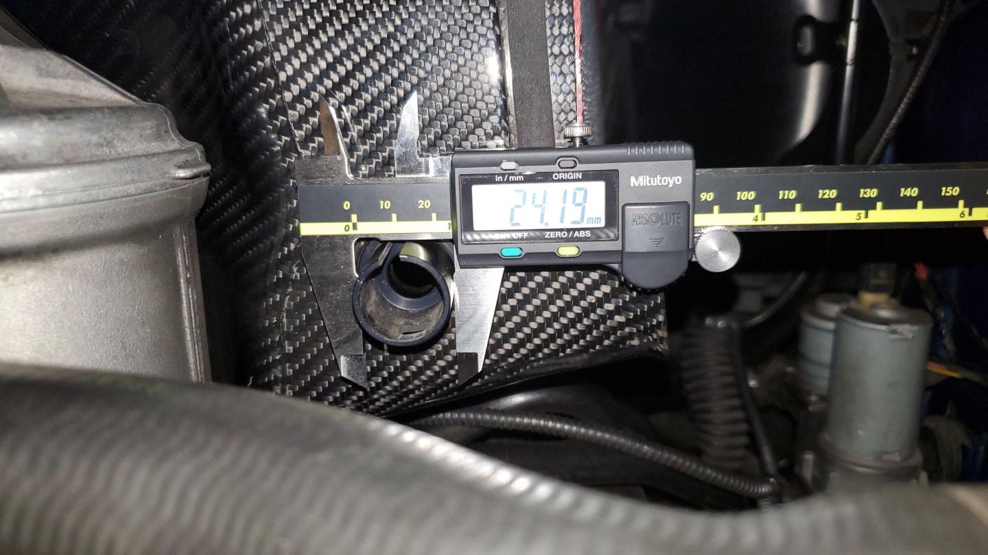

          Not sure if this is still useful, but engine bay was half taken apart so I took these measurements.
          ID of bung:

          OD of bung:
          Depth of bung (caliper is set up like that just for the pic):
          ID of part where o ring goes (this was also measured non-stupidly, but caliper is set up like that for the pic):
            #50
            That helps thanks! I can get a 14mm cap, and it should squeeze in.

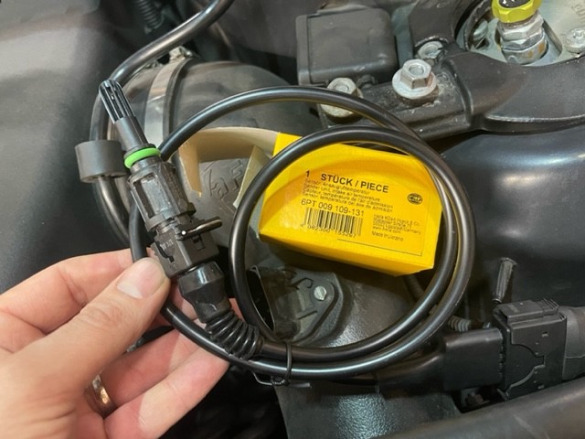

              Just moved mine tonight and switched to US Spec. Scaling to account for the different sensor.
              Could anyone confirm which spec IAT this is? My cursory understanding is that there is a "E46 CSL" vs "US" spec? I believe the one I have pictured has CSL scaling? I am just trying to confirm for my tuner which scaling this one has. I think they have an idea but want us to confirm it.
              Thanks
                #52
                Yes, that's the CSL sensor, not the gold-ish colored (maybe cad plating or is it brass?) E34 M5 iat.
