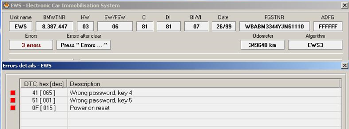

    9. Connected the INPA software and observed the following (see screenshots below)

    Both the PA Soft and the INPA data seem to indicate that there is a key issue but, I find it hard to beleive that two keys could fail at the same time. Alternatively the EWS could be corrupted somehow but I am not sure how to confirm that.

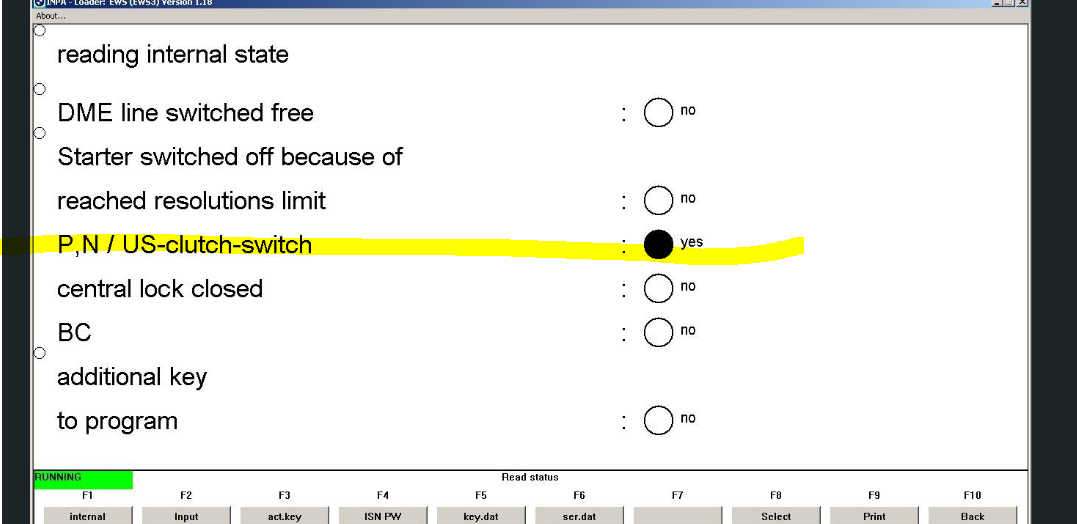

      I watched an excellent video today by DTech Engineering https://www.youtube.com/watch?v=2GtU9PBaZB0 where he uses the AK90 to resync his existing keys. I have ordered an AK90 and hope to give it a try.
        It says the starter is disabled bc no signal from pressed clutch.
          Pressing the clutch in/out results in that box toggling from yes to no. But it should be an easy to confirm that electically that line changes at the EWS. Does anyone know what pin that is on the EWS?
            Then you should post the pic when clutch is pushed down instead of pedal is up while ignition turned to START. It's misleading and wasting other people time.
            I think the clutch sw wire connected to EWS pin8

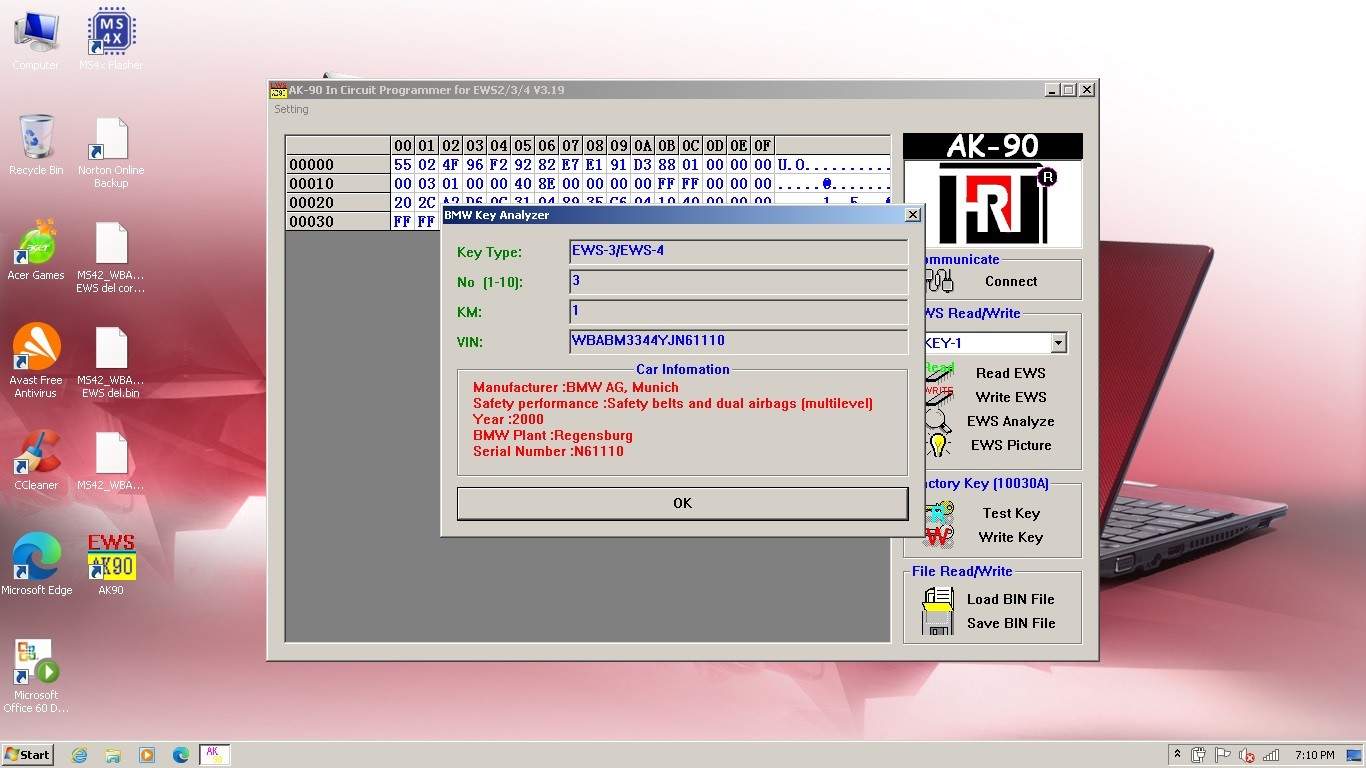

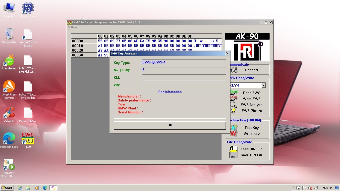

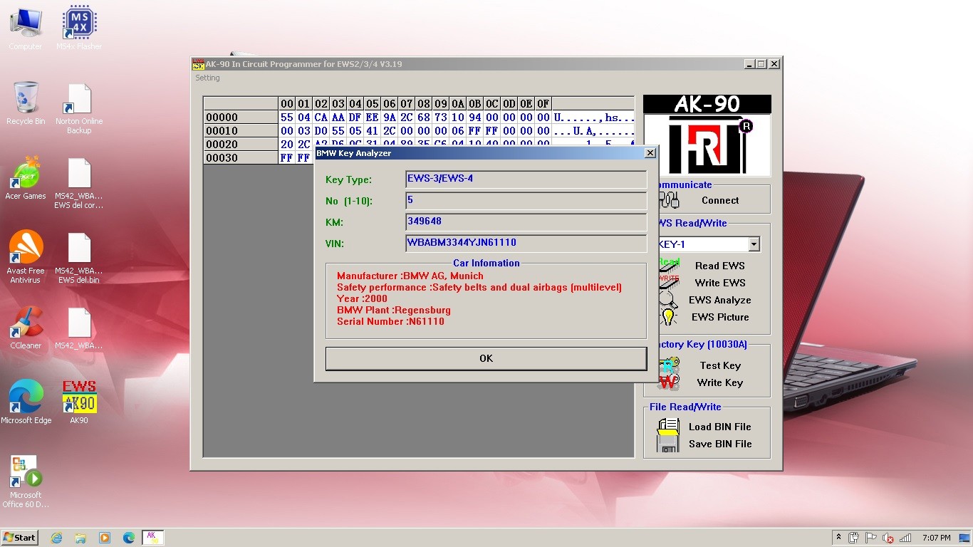

              AK90 arrived today. There are some things that I do not understand in the data I see when the keys are read. Firstly, the key number is incremented by 1 over what is read by the PA Soft and INPA. Secondly, key # 5 (or 6 in the AK90) is showing no data for the VIN nor mileage--this is the main key that I have been using prior to the no crank no start symptoms starting.
              I also discovered that I have a valet key and a wallet key so I checked these out in the AK90 also. Those two keys and key #4 (or 5 in the AK90) all show the VIN and a mileage value (although it is impossible to understand how #4 has a mileage of 327683 as I have never used this key in the 10 years that I have owned the car).
              Is is possible that key # 5, which was my daily driving key has somehow become corrupt/failed and has caused the EWS and DME to go out of sync? Which as a result has messed everything up for the other keys?
              I am a little afraid to try the valet and wallet keys in the car at this point as I am afraid that I may mess them up somehow.
              Let me know if anyone has seen anything like this in the past and if you have any thoughts on next steps, or if this is a total wild goose chase.
                AK90 counting keys starts from 1, while other tools counts from 0 as most digital counters start from 0 -- no reason to waste a digit.
                "although it is impossible to understand how #4 has a mileage of 327683 as I have never used this key in the 10 years that I have owned the car"
                What's the mileage on the odometer compared to 327683km? Did you insert this key into the ignition recently?
                "Is is possible that key # 5, which was my daily driving key has somehow become corrupt/failed and has caused the EWS and DME to go out of sync?"
                I don't think the key is the root cause, as each key is indipendence from other keys. I think the EWS lost its mind and wiped out the VIN and KM on that key.
                I would read the EWS data and save it, then try to write the same data to the #5 key to sync the random number and other programmable data into the key.
                  What's the mileage on the odometer compared to 327683km? Did you insert this key into the ignition recently?​
                  Actual mileage = 349648 km
                  That key has been sitting in a cupboard for years--actually did not know it was for my e46, thought it was for either the 535 or the X5 until we put the key into the AK90. Have not put the key into the ignition.

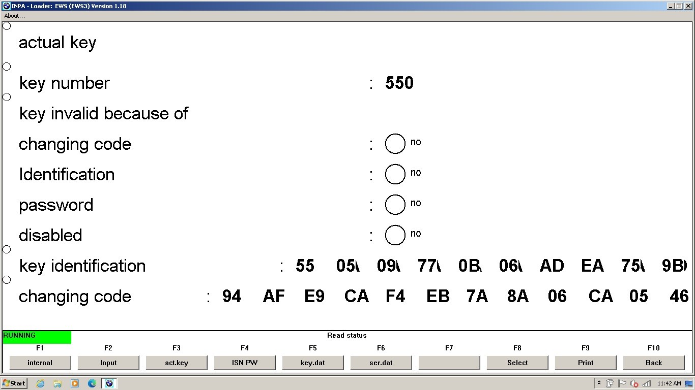

                  Connected the car to the INPA s/w again today to check some data and while cycling through with key # 5 in the ignition, noticed that all of the EWS conditions for the key had changed and that the s/w showed that the car would start. Sure enough, turning the key to start resulted in the car running. After running for a short while, turned the car off and the INPA s/w reverted to showing a problem with the password and the rolling code (no more starting). This is driving me nuts! Checked the key again in the AK90 and it still is not showing a VIN nor the mileage. I am having a hard time understanding how the key could be corrupted and at the same time it occassionally will start the car. And also, shouldn't key (# 4) that is registering correctly on the AK90 always start the car since it reads correctly and the car treats each key uniquely?.

                    Here is the screenshot of the INPA data when key # 5 decided to work today.
