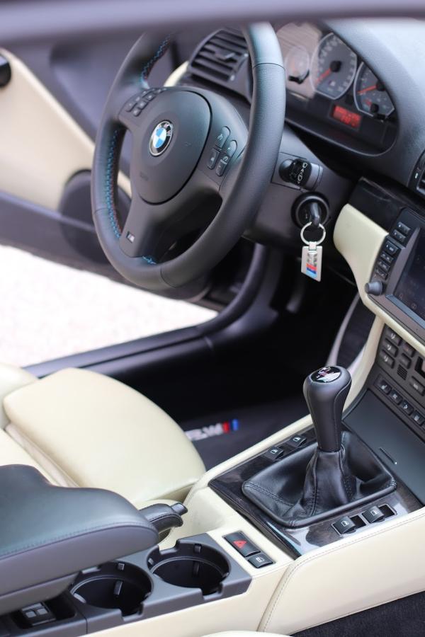

                  I have the -884 as well, I like it compared to the ZHP-like shorter shift knob I had previously.
                    Stock is best
                      Stock is best
                      I seem to remember you being on team non-zhp weighted?
                        That's the knob (m performance weighted). Op is talking about the lever no?
                          I'm sure you already know but: stock is the illuminated broomstick, whereas 884 is the non-illuminated weighted broomstick, and then you have the zhp knob. OP mentioned having the 884 on order, which is not stock- hence my confusion.
                            This thread isn't about knobs. He's talking about the metal lever. I.e., changing the throw. I see now that a few of you, recently, posted about knobs, but I didn't quote you guys or anything. I'm just talking about the lever.
                            Best setup in my opinion is all stock except for a delrin or poly nose carrier bushing, and the weighted 884 knob with sequestered factory boot (nappa) or zhp alcantara.
