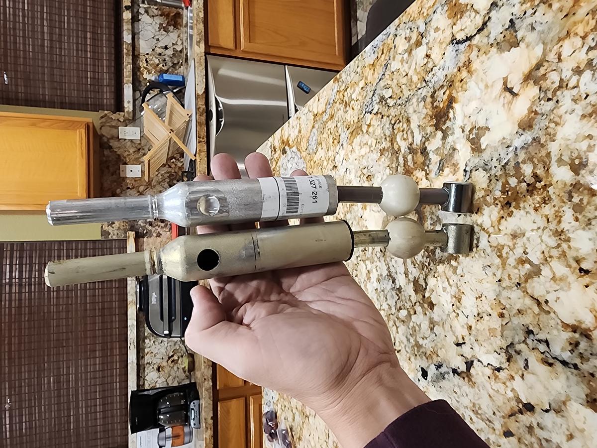

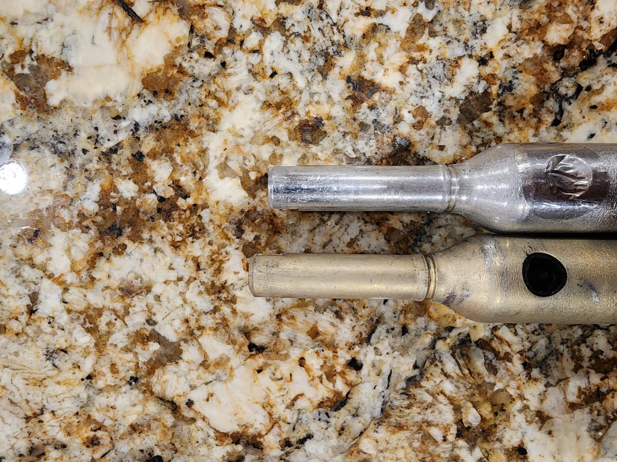

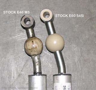

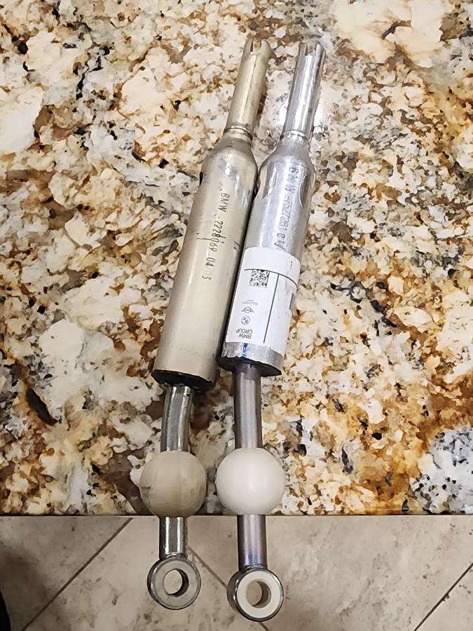

                    I ended up ordering the longer e60 shifter and I must say, I think I'm going to like it a lot. I did notice there was a lot of slop like you stated. I ended up filling the void with strips of zip tie.
                    Here's a short video I made showing how much slop it has. Crazy considering it is brand new!!
                      Here are some comparison pics as well. M3 shifter on the left.
