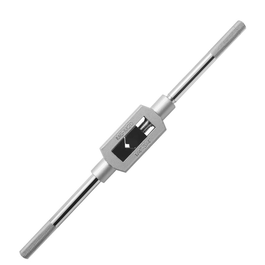

            For drilling, I used one of those flat tap wrench handles instead of the style you mentioned. Took a while, but was able to get everything done with just the shroud removed. A tap/drill guide was also super useful for making sure the insert went in straight.
            Something like this is what I used:
