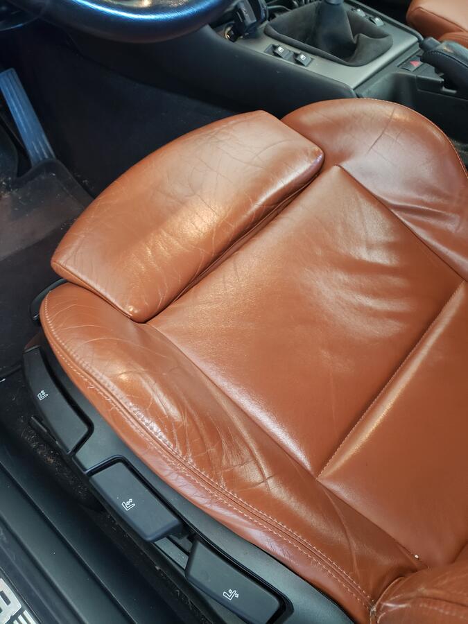

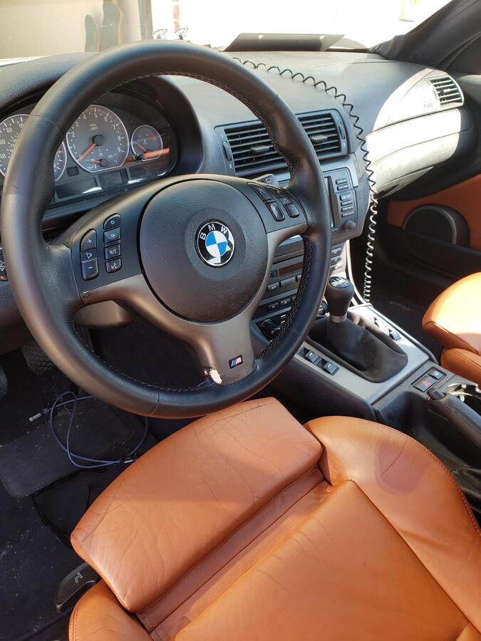

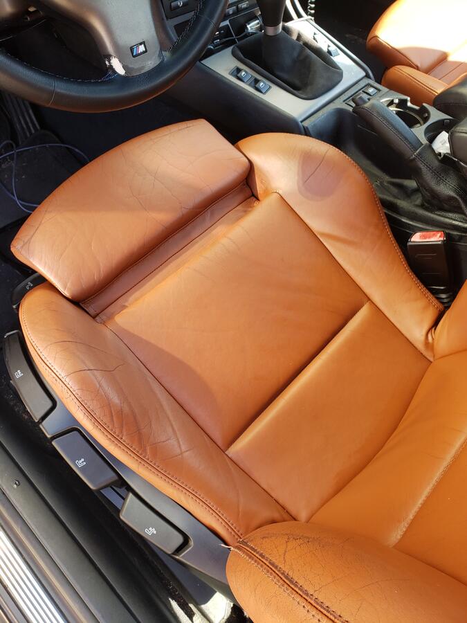

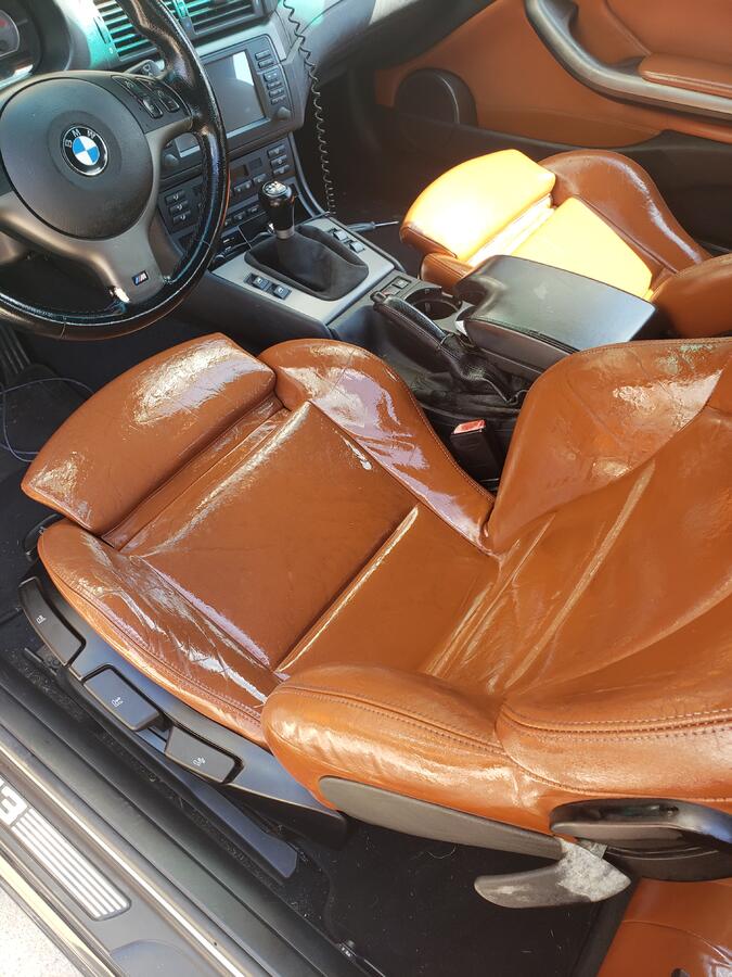

                I started late at night so I don't have the best before pictures. I had it sitting in the heat for almost 3 days. It's definitely softer but my driver seat has the cracks more pronounced now. Steering wheel looks and feels a lot better at least.
                Edit: Having trouble with some photos so I'll just say the first photo is the only before photo. It actually looks better then the after.
                  Yeah, unfortunately, if the cracks are bad, a good cleaner can make them look worse since it cleans out all the crud that's in the cracks that is smoothing them over and making them look less severe than they actually are. But glad they're softer!
