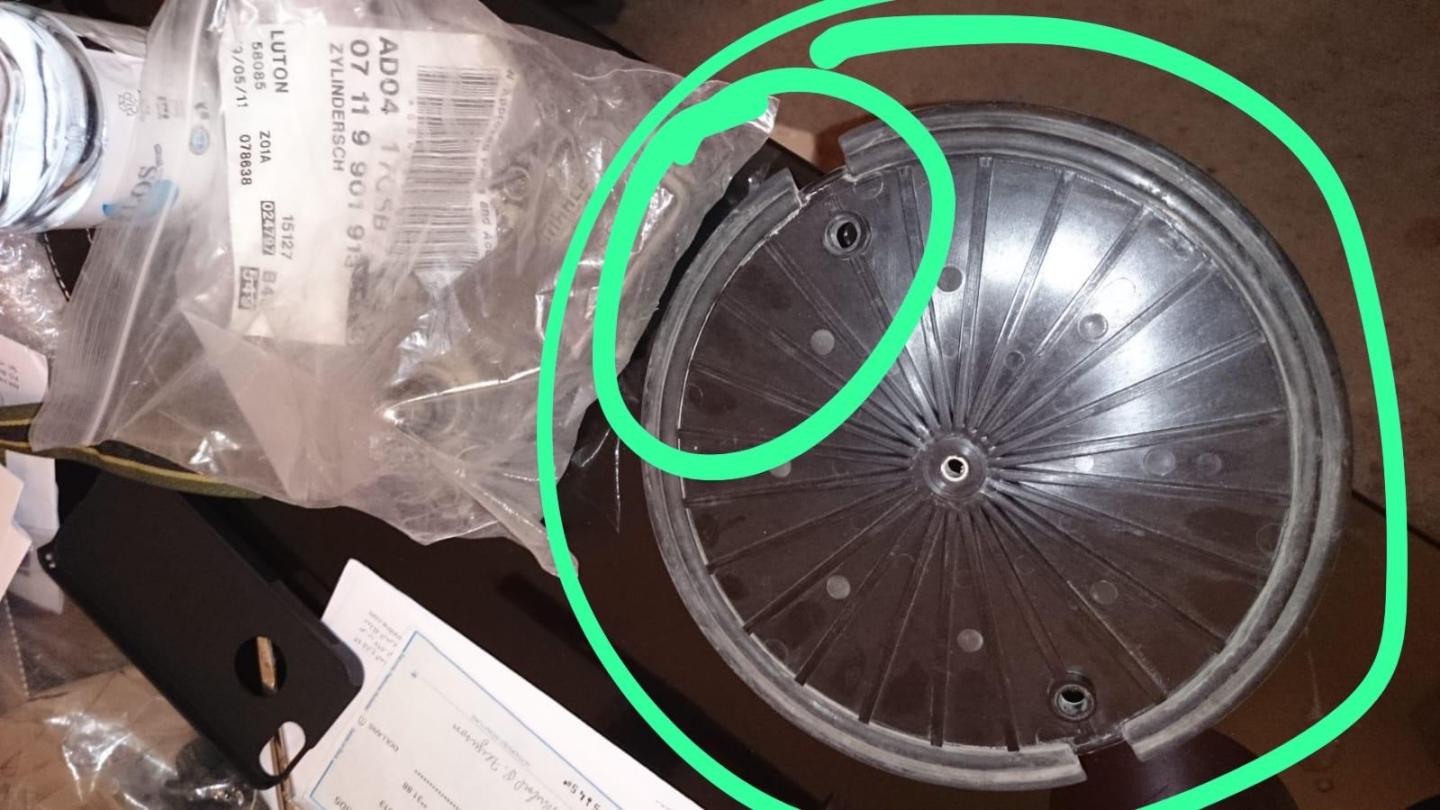

                      Hey everyone I won't be able to remove the flap from my car's intake due to shortage of time before traveling to the states.
                      If someone can lend their flap that'll be great or I'll just send it over to heinzbohmer via DHL when I get back to Bahrain in a few weeks. Cheers

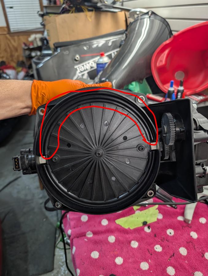

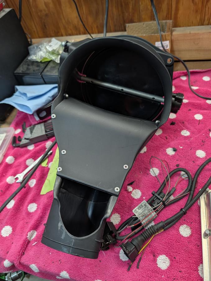

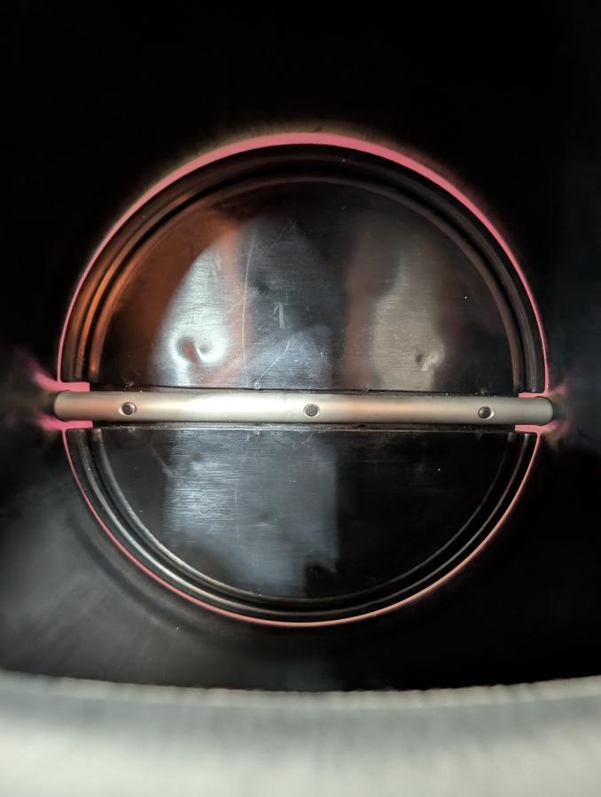

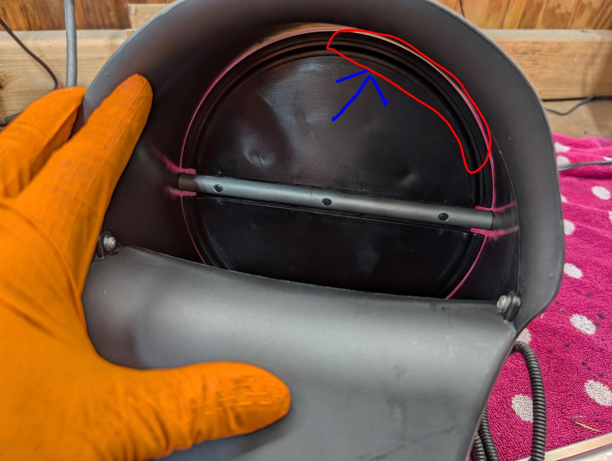

                        I just took my CSL air box off to get ready for sale. I have my snorkel removed and cleaned
                        My seal is completely intact. I don't really feel like shipping it at the possibility of it getting damaged and also possibly getting damage / missing on a return shipping
                        I do have a local friend that does 3D scanning for a race team. I talked to him and he has no problem scanning the whole snorkel. The back of the flap where the seal is the front of the flap inside where the seal is probably only enough room in the front to get to the top half of the seal but the top and the bottom half are the seal are the same I believe.
                        Here are the details of his scanning setup
                        I run a Peel3D Peel3 scanner. My fine scan detail level is just under .3mm.
                        It produces STL files natively, but i can file convert using Fusion 360 or Solidworks
                        Let me know if this is an option and will work and if we can do that I can go drop the snorkel off with him so he can do his thing and then get you the files and send them off to you
