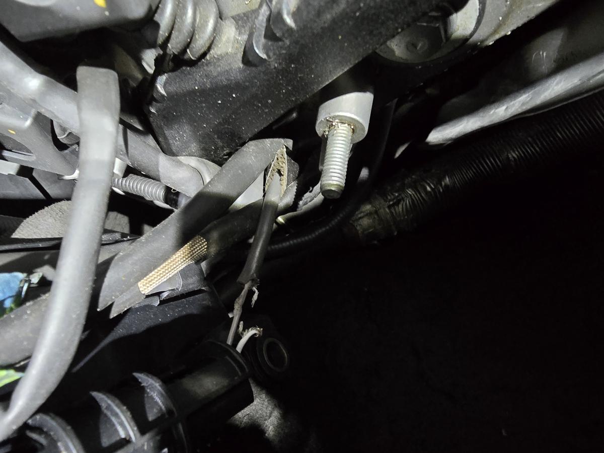

    So the O2 sensor wiring for bothe pre/post cats are fine;however, I stumbled upon a wire that IS damaged (pictured).
    This looks to be the EGT wire that has been severed. Would this be a reason for my catalyst errors (178/179), and lean codes (before Hassan gave me a base tune that turned the rears off? Could this stop the O2 heaters from coming on?
