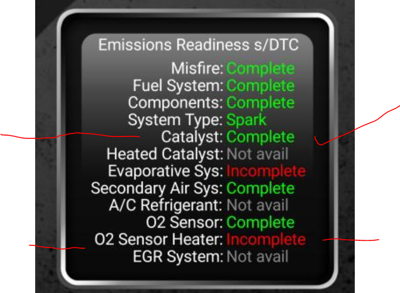

                    I haven't gotten an error for heater. The errors I'm getting are Too Rich/Lean (both banks), Trims (both banks), Catalyst (both banks),
                    Are we speaking in English here?
                    Your pic shows the only thing you failed the smog is the Incomplete O2 sensor heater.

                      Click image for larger version  Name:	image.png Views:	4 Size:	349.0 KB ID:	287796​
                      Correct. INPA showed P179, 178 and they still readied up. So that's why I haven't been concerned with those codes. I know they are running correctly, so the fact that the heaters aren't readying is crazy to me. I've never had this problem. Usually it's SAP and Evap (which is still need to figure out. When I click the SAP DTC box in Martyn's program, it's suppressing the check engine light, but not readying it up. This pic says ready, but the light came on as I unchecked it after 300 miles and 6 cold starts of it not readying.

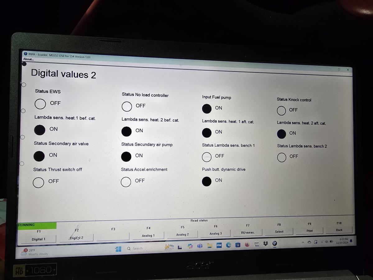

                        Update:
                        I've reinstalled the oem fan clutch/aux and SAP.
                        will clear codes and do a cold start now with a few drive cycles.
                        Looks like the ECU called for the heaters according to INPA.
                          Wondering if I should just reinstall my SAP.
                          Whatever that displayed the Emission Readiness that I referred to, I would not trust it; it seems to be far from reality of what you observed.
