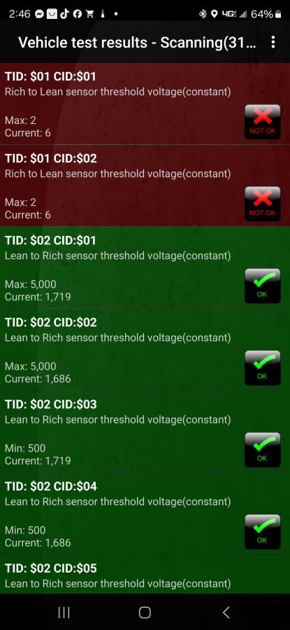

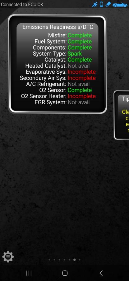

            Took a screenshot within tory during my drive cycles. The usual suspects readied up. I'm expecting SAP to ready up within the next 2 cold starts, as I'm reinstalled the SAP hardware.
            One thing I have noticed witin the Torque app is this...
            Looks like Too Lean voltage threshold. Battery?
              #66
              Running lean I would be looking at vac leaks, MAF, fuel pressure, injectors.
                #67
                My Bad, it says Rich to Lean... does that matter?
                I checked vacuum and all is good. I have the csl conversion, so no map sensor. Can I check fuel pressure and injectors in INPA?
                  look at your long term fuel trims in INPA. That should indicate whether you're running lean or rich. But usually either one triggers a check engine light.
                    The big concern to me is the o2 heater not complete.
                    Maybe the tool uses bad words to describe the problem subject and not really the heaters have problem.

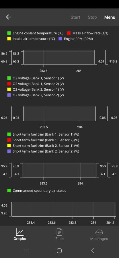

                                So I've logged, but when I upload to the Zapa site, I only see time and speed.
                                This is what the im logging...
                                Can I send you the .csv file?
