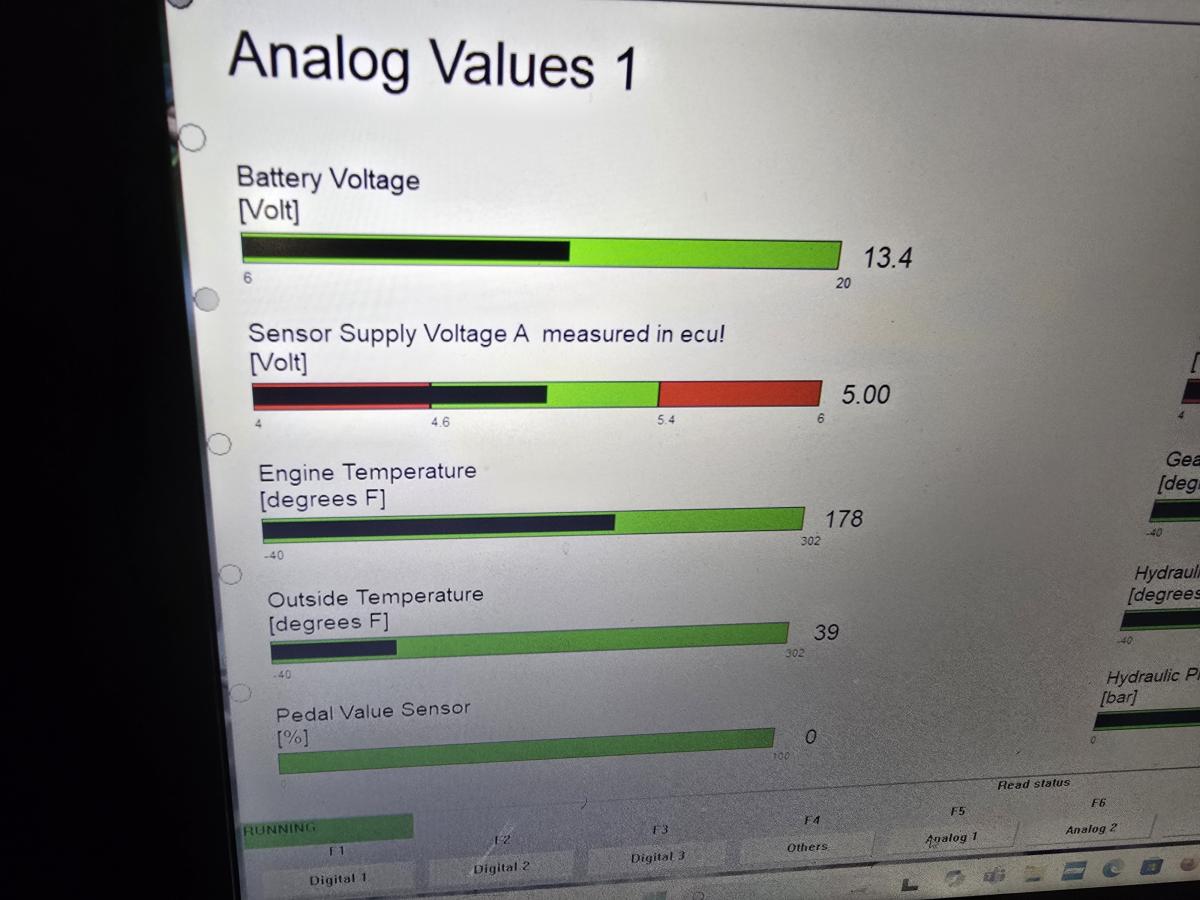

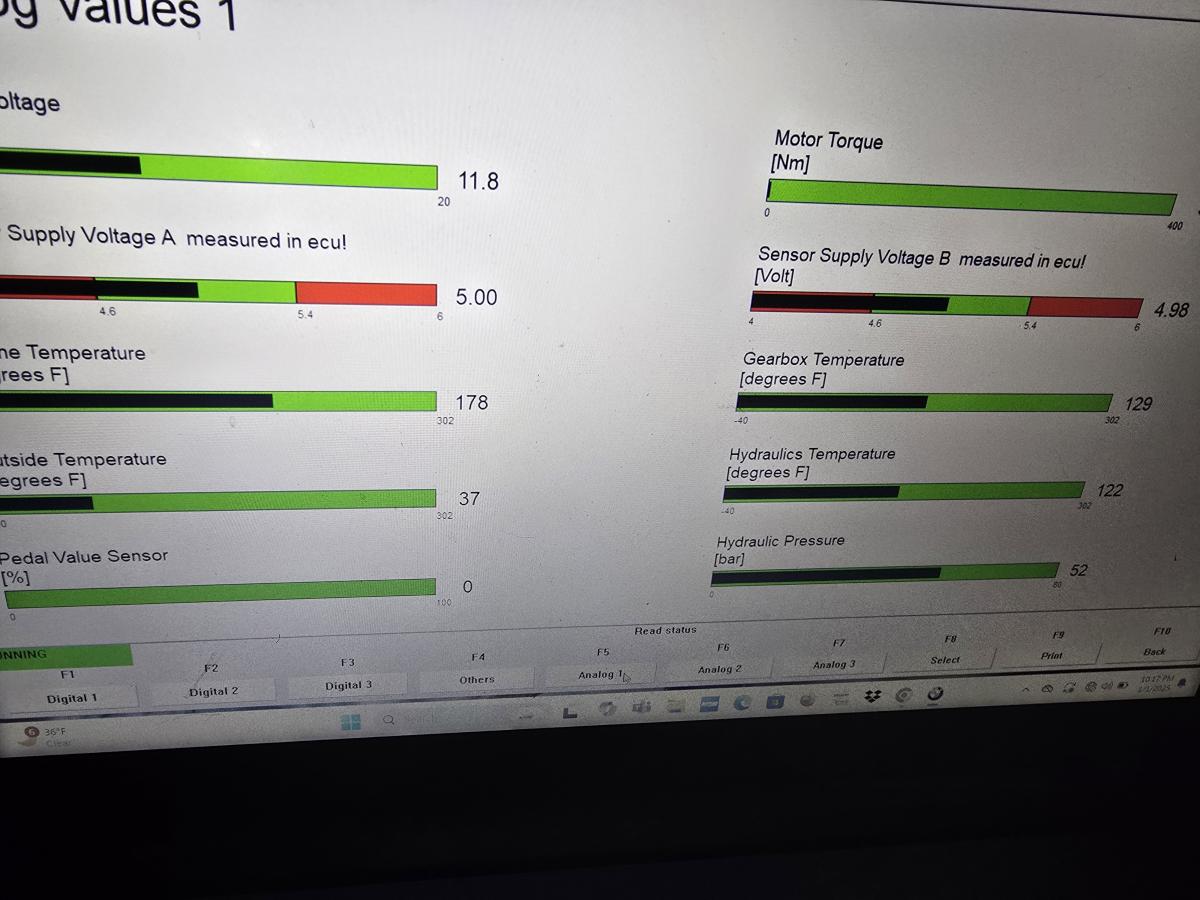

                Also while at idle, my volts are only 11.5 (with lights on).
                When driving abd going 80mph, voltage is at 13.5 (lights on) and 13.6 (lights off). Is that normal abd would that affect o2 sensor heater?
                  Where did you measured the voltage?
                    I was reading from INPA hooked into the OBD2 port.
                      It's normal for volt reading from obd lower than directly measured voltage at batt.
                        It's normal for volt reading from obd is lower than directly measured voltage at batt.
                        Agreed but 11.5 seems like a larger delta than i would expect at idle.
                        Measure voltage at battery during idle using a multimeter to confirm if alt is healthy or not.

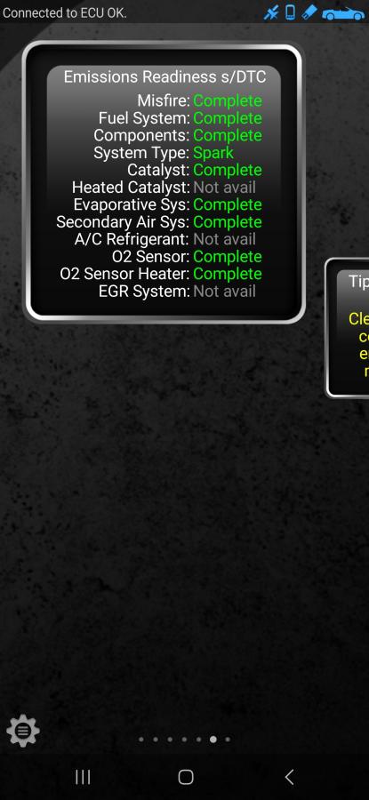

                          Hey Fellas,
                          Sooooo after this long journey, I took out my ecu and drove it down to someone in NYC.
                          "I don't know what happened, but I magically got it back 4 days llateral everything says ready after installing"
                          I will be deleting the cache on my phone and will be throwing it in a lake.
                            Hey Fellas,
                            Ready even without driving the car?
                            Same Dme but with new firmware? Did they repair or only coding?
                            Great news!
                              Great news!
                              Yup, didn't drive one mile. Popped it in, started it up, everything was ready. Took him 2 days... (all of this is allegedly, lol). Same DME... he tried to overlay the changes with the current tine, but it wasnt taking. So he flashed to a stock tune, adj for my cams, and coded that one.

                                The master knew exactly the memory locations to set all of these flags ready, and somehow bypass the power interruption which normally would clear all emission monitoring readyness. I wonder the next smog time in 2 years how the car will behave.
