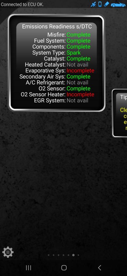

    I cleared the light and installed a tune terra adjusted for me some years back. Did a cold start this morning and SAP readied after one.
    so now it comes down to the heater. For some reason, I don't think evap will ever ready.

        he sent me a base one which had rear O2 suppressed abd SAP DTC suppressed. Ran with that tune for 400 miles (with drive cycles) and couldn't get SAP, Heater, or evap to ready).
        so I reinstalled SAP and I unchecked all suppression to see what wouldn't show up.
        surprisingly, SAP still not readying with hardware. Heater still not readying.
        car runs smoothly. You would not guess there is any issue. Just getting cat threshold efficiency codes (the only ones as of now). I did get a lean/rich code at the very beginning. I do have an exhaust leak at the header/sec1 connection that if tried to fix 3 times (SS quality control is trash apparently.

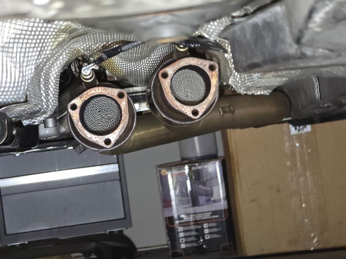

                            Also my catalysts are readying up, so how can they be bad?
                            I didn't see this when reading yours first time.
                            Suggestion: don't edit and add information unless you pointed this out in new post, as others won't know this. Instead just add to new posts.
                            So you increased the rpm in the tune to have smmother rpm with the cams -- so the tune is not stock?
                            On the new logs: Cold start and Steady Highway logs labels mixed up.
                            The odd things: I wonder why it took the engine so long, 7 full minutes to close the control loop (see Fuel status). Normal car should be about a minute or less.
                            You have negative fuel trim, meaning the DME tried to correct rich mixture issue. But the total fuel trims are less than 5 which should cause no SES light on.
                            The post car sensors show the CATs are not working and this sure will fail the smog test unless it's disabled.
                            The SAP command is normal so SAP pump should be running when cold start.
                              NO they are not ready.
                              Look at the O2 sensors post cat: the signals switching just like precat sensors which means the exhaust gas wasn't treated properly. They should be above 0.5v most of the time. This should cause CAT readyness fail.
                                You are correct. I guess I mean the app is saying the catalysts are ready... which doesn't make any sense.
                                Also my cats look almost brand new, which is also strange.
