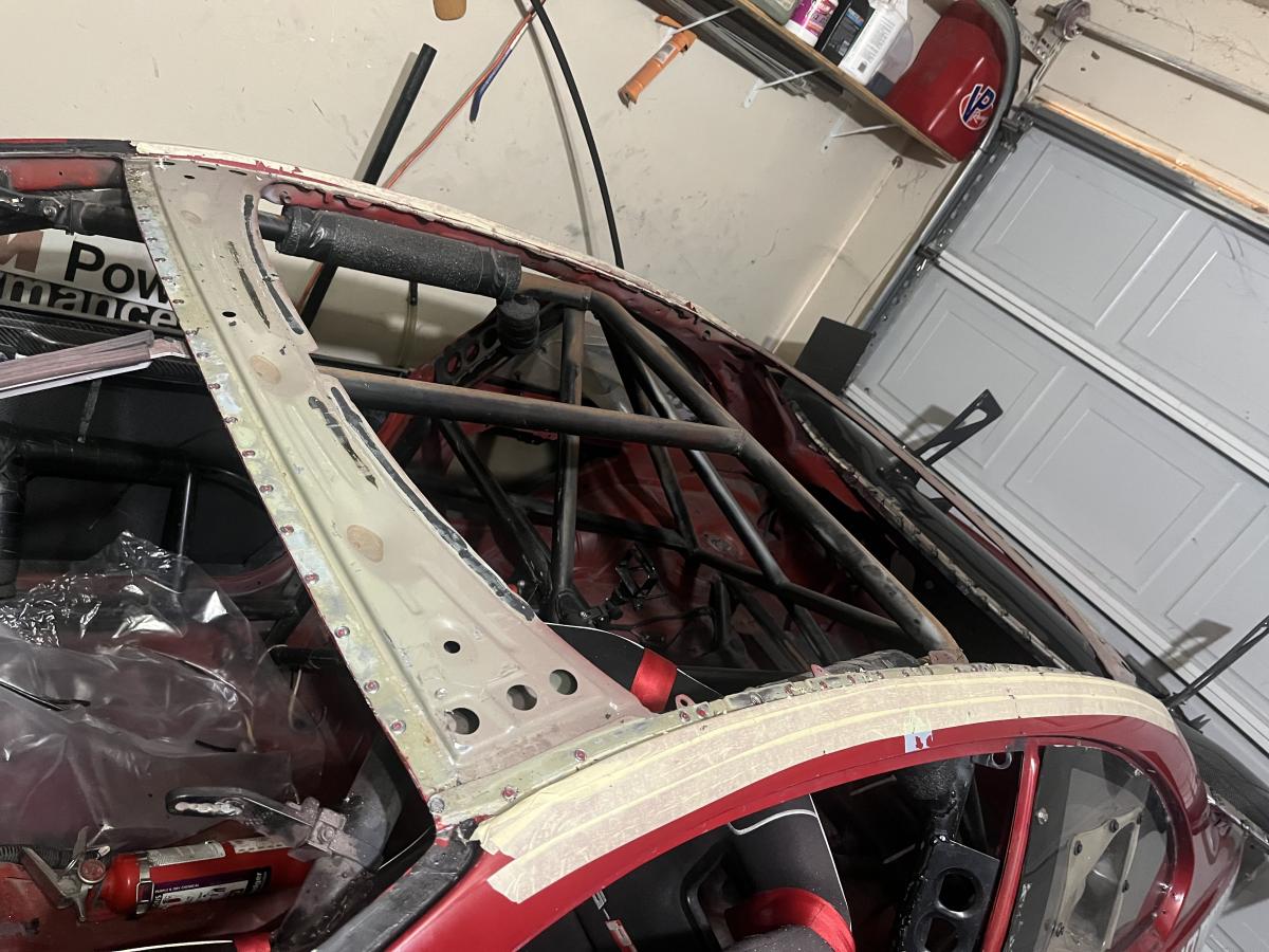

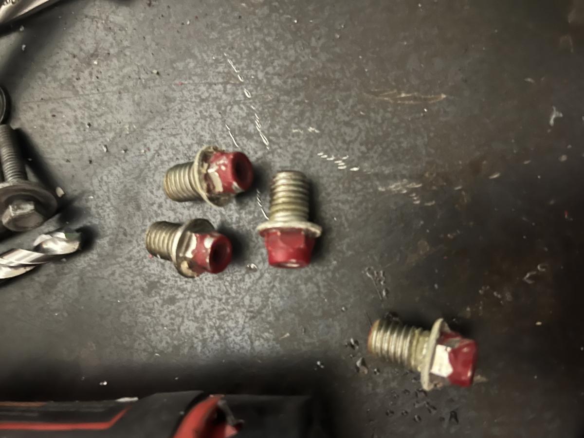

                Just got my roof off once I figured out the roof rack mounts screw out 😫. I was charging the sawzall batteries when I was like hmm…that looks like a hex head under the seam sealer. 10mm socket and they screw out. 🤦‍♂️
                Removing the roof with a roll cage…my only option was to pull from the outside.
                Maybe I can use those bolts to just bolt the roof in! 🤣🤣🤣🤣🤣
