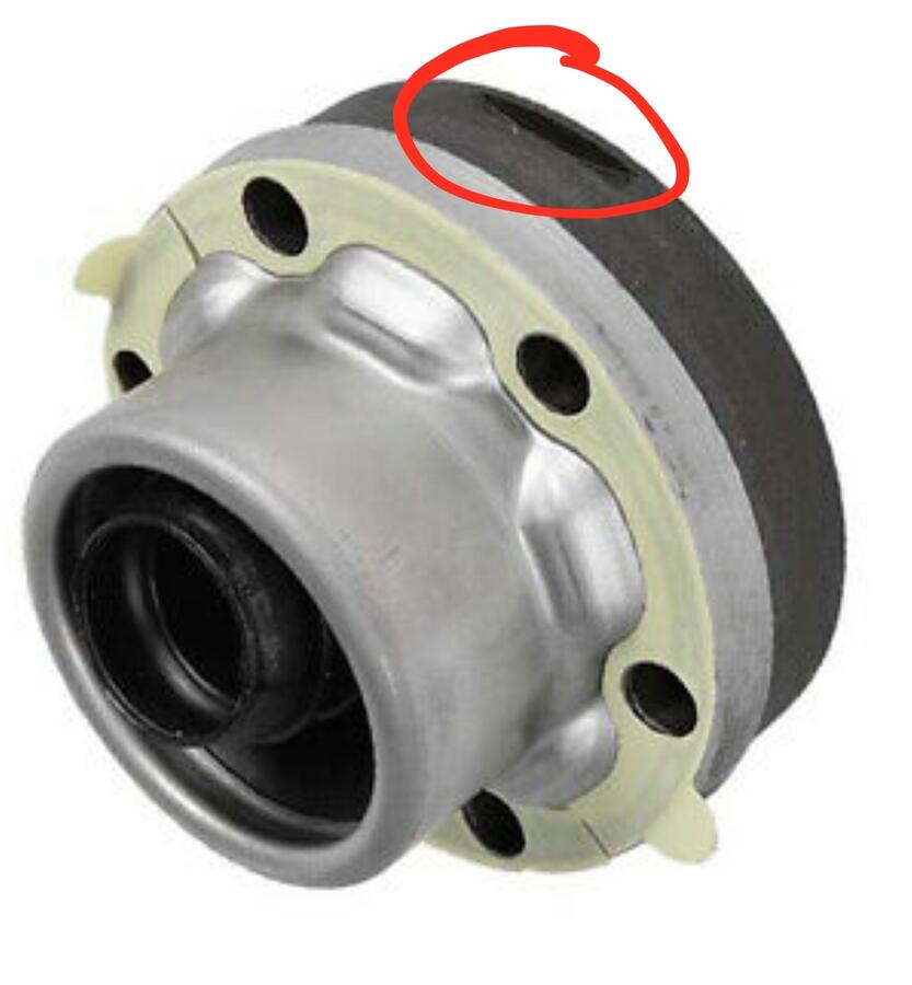

    I'm having trouble removing my diff from the driveshaft. They seems to be stuck onto each other. Does anyone have any tips or tricks to separate the two

      There's a slit in the CV joint on the driveshaft that will give you some leverage to pry it away from the diff. Be gentle though, you don't want to damage the CV joint.
        Yes, there should be a slit on either side. Agree, pry gently, and evenly. You'll probably want to order a new gasket (there's a thick, paper gasket in between the two. If the old one is stuck then it will probably tear upon removal.
          Thanks guys
          I did notice that notch, HOWEVER I did not realize I was supposed to tap away from the driveshaft (towards the front end). I was thinking I could get my pry tool (flat head) in between via that notch, not realizing there was still a few mm's of metal in between the notch and driveshaft. That picture was very helpful, and I will definitely replace the gasket
            Click image for larger version  Name:	Screenshot_20200326-143538_Chrome Beta.jpg Views:	1051 Size:	46.7 KB ID:	2952
            Holy shit thank you so much. I registered only to say thank you. My e46 330i manual swap
            the driveshaft wasn’t wasn’t coming out the diff and this is the only thing that helped.
