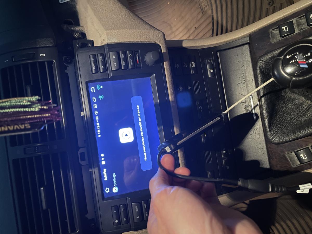

    Hey folks, I bought an Avin Avant unit from mpartsworldwide, and long story short, I factory reset the radio and now the carplay app is gone. Avin Customer support has not responded to me in over a week, all I get is their crappy AI assistant, which is useless. Does any have the APK file or know where I can somehow get access to it?
    Long story: I was initially having an issue where the carplay would not connect, error on screen displayed "plug in dongle to radio", which it already was. When I hardlined my iphone into the other end of the dongle, it would only mirror my iphone on the radio, still no carplay. I figured maybe it was some jacked up settings from the previous owner, so I factory reset the radio, but now the carplay app is gone.....shot myself in the foot

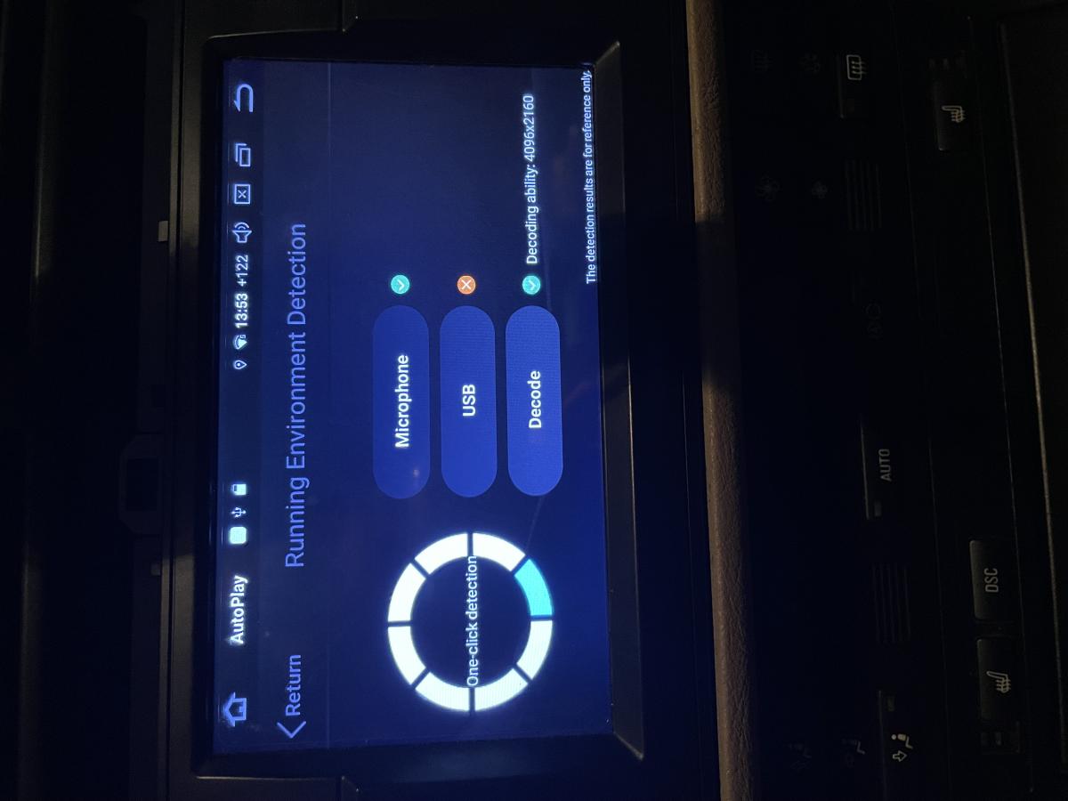

        I am still having an issue where the carplay does not connect at all, wondering if its possible that the dongle is plugged into the "wrong" port on the back of the radio. When I initially tried plugging my USB drive into the cable coming out of the back of the radio, it would not read the USB drive. I then used the SD card slot and it worked fine.
        There are two different pin connector wiring harnesses that both have USB ports coming off of them, does it matter which one I use? I could be blind, but I didnt see and built in USB spot on the radio, so I'm assuming the USB wiring harness is what it is referring to
        see photos for specific display error

                  Perhaps with the head unit out / connector accessible you could try something like a fresh install of the APK and then plug in the dongle? The whole chain of Android USB device management behavior + shitty autokit app is a mess, but once I got mine figured out it's been passable.
                  '04 LSB Coupe 6MT
                    I've even tried plugging in the Iphone charger into the new dongle, still nothing. I've tried probably 7 different APK files, plugging the iphone directly into the radio, and nothing works. I think I'm just going to go with an adapter to use a Sony or a Pioneer radio, seems like those will be the only reliable options. I just wanted something that looked OEM, but clearly these chinese units cant be trusted, I dont even wanna take the chance on a Dynavin when a Pioneer is half the price.
