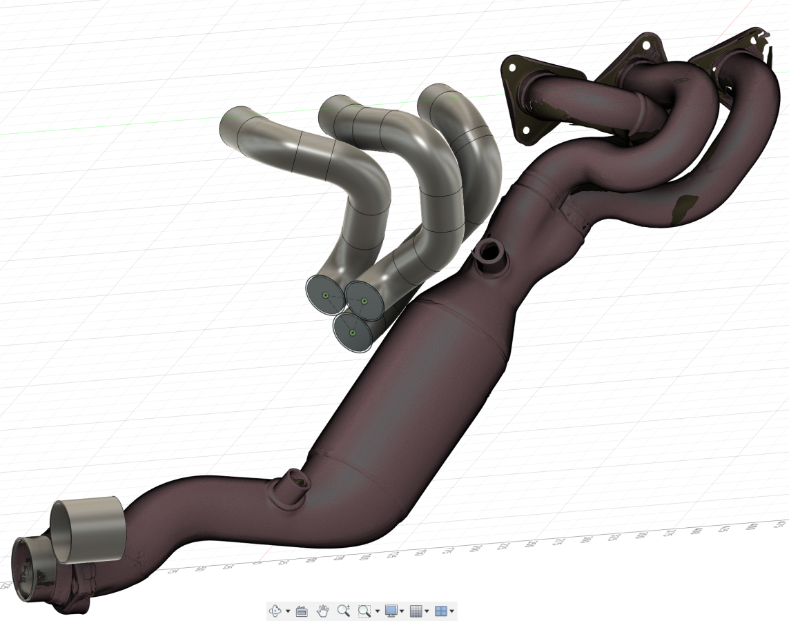

      Word to the wise: This is NOT compatible with US headers. In US headers, the short runner that needs extension is on the PASSENGER side.
        If i'm understanding correctly - aftermarket headers switch which bank goes to what exhaust pipe? i never realized that
        And second clarification - this means they will still fit, but will not sound as intended?

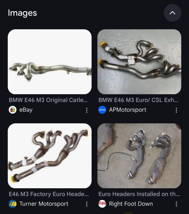

              Are we sure the euro and us headers are different lengths?
              just looking at these pics of both I’m having trouble visualizing that they mount up differently because to my eye they look the same? Maybe we can reach out to rogue to get their take
              of course it is possible I am missing something here.

                Look closely at photos of headers installed on the engine.

                  Is it u.s. versus euro or us/euro versus supersprint tubulare and all the other aftermarket copies?
                  I thought the only difference between us and euro were the cats.
                    #39
                    It’s worth checking for each user, but it appears that US is specifically the odd duck that crosses over. Euro and aftermarket seem to all match each other.
                    Runner and post-merge lengths of aftermarket headers are likely to be different for aftermarket headers than for euro headers though, so really this should be considered specific to euro headers.
                    Ideally this is all solved before section 1. I’m sufficiently displeased with the market here that I’ve started developing my own equal length stepped header that will also have equal length tubes post merge, updates are in my build thread.
