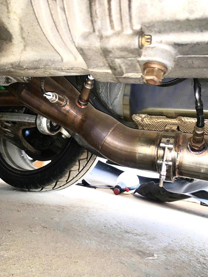

                Hey everyone! I installed this piece this last week and I love how the car sounds now. For reference my setup is as follows: megan headers, Rogue Equal Length Section 1, OEM section 2, Custom section 3 ( Straight through design muffler with better Aero Resonators).
                One thing i will note is that the section one does contact the underbody so you'll have to wedge something in there to prevent vibration. I used heat wrap and wedge it between thr pipe and the heatshield. I'm not complaining though because then pipes are tucked up high, I can use the oem plastic pieces, and this is the sound I've been chasing for years.

                              No sound clips of this Rogue E.L. Section 1…? Come on! Let’s hear it!
                              And an install pic from under the car showing fitment.
