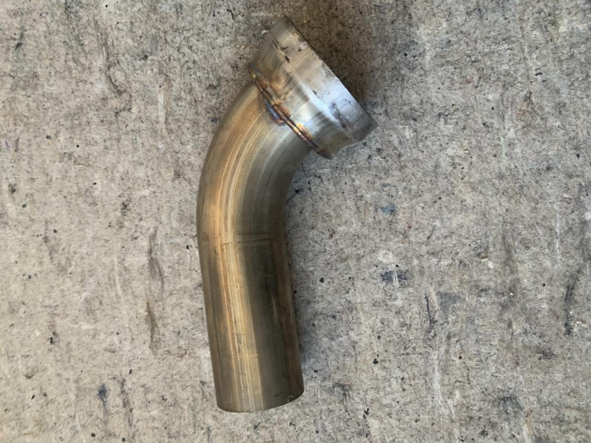

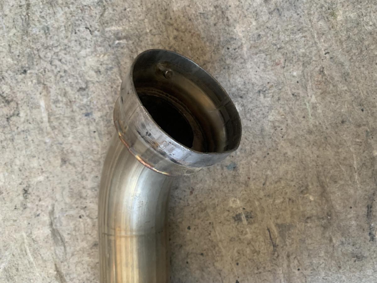

      To your point, it's too loud for most tracks as well, I have a baffle that is easy to install/remove. However, some modern cars are well into the 90db to 100db levels. For example a stock gt350, 93db. Meaning some cars require baffles, in stock trim before they can even be tracked. This is a baffle that was made for another one of my loud cars. It has a turn down to make it even more quiet without the baffle. You can make any exhaust quieter, I went the way I did b/c of weight.
      Click image for larger version  Name:	IMG_0420[1].jpg Views:	0 Size:	191.5 KB ID:	300665 Click image for larger version  Name:	IMG_0421[1].jpg Views:	0 Size:	127.0 KB ID:	300666
