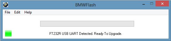

    First and foremost, ECUWorx offer no warranty of any kind, we are not liable if you break your car by incorrectly flashing your ECU/DME. You do so at your own risk! You will require the following: A copy of the MSS5x Binary Modification Tool, available here A fully charged laptop and a copy of BMWFlash or MSSFlasher. Available from here: BMWFlash or a copy of from here: MSSFlasher A FTDI based OBD2 diagnostic cable such as a BMTechnic cable / BM or a KKL Vag-Com cable. yIf you don’t have one, you can buy one from here A trickle charger
      Ecuworx. I was scared to do it but it’s super simple.

        This tool is awesome. I love it. It just got an update too.
